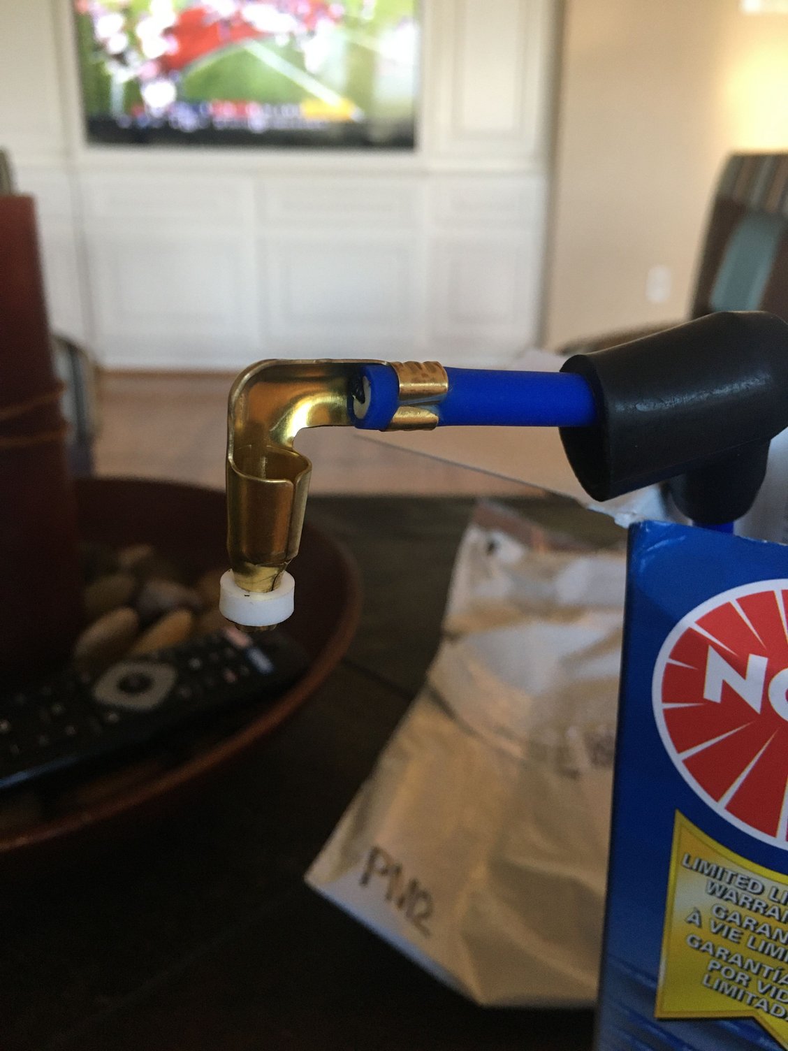

Old Oct 25, 2021 | 09:40 AM
austinlandroverbill's Avatar
Joined: Jun 2014
Posts: 483
Likes: 45
Thanks, that was exactly what I've been looking for.
I have custom wires for a coil relocation kit.
The wire set came from Kingsborne and have exactly that connector, which frankly is kind of flimsy and fragile at the 90 degree joint, which is where I broke mine.
However, check out this new style connector (also from UK on eBay) that is way, way structurally stronger than the "old" design. I hope that whoever came up with this got a design patent on it and makes a bunch of money as it feels like you could lift an 80lb bag of sackrete with it and it wouldn't bend.
https://www.ebay.co.uk/itm/111468947...75.c101224.m-1
I can't wait a couple of weeks for something from the Brits, so I thought I'd see if some standard NGKs might have this type of connector and they did so I am just going to cannibalize that (in truth, I was not aware of this stronger new style connector but ordered a standard NGK kit and to my surprise they came with it). Basically, a $30 coil terminal (or $4 each if I eventually cannibalize the other 7 as well).
