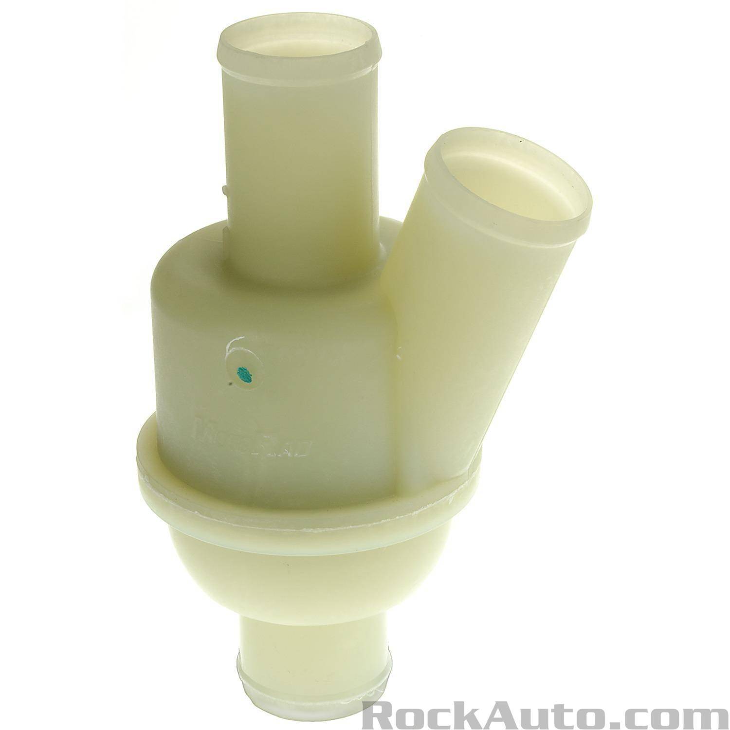

I've used this without incident (in a P38)....
(fyi, Motorad purchased Stant a couple of years ago)
https://www.rockauto.com/en/moreinfo...&pt=2200&jsn=1
