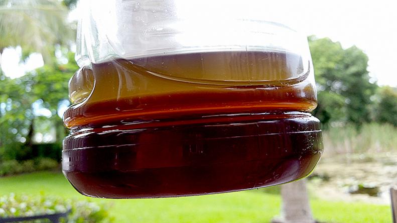

Use a turkey baster to suck out as much of the transmission fluid in the brake reservoir as possible. Then refill with clean brake fluid and bleed the brakes until new clean fluid comes out at each wheel.

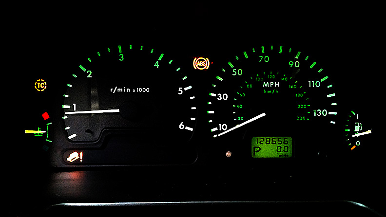

Thanks again Jared9220, already bought everything and will tackle it your way tomorrow, but today I did suck everything out of the reservoir -below a photo of it. I figure that the upper liquid is the transmission fluid, the amount seems right from what I poured in by mistake! ;-}#
The second photo is for the record, shows the mileage (128656) at which the sparks & wires were replaced, the MIL light off (hopefully for good) but the 3-Amigos still around -that'll be the next issue to solve! :-}#

Originally Posted by Jared9220
-The bleed screw is a 11mm I believe.
-I use the big 32oz bottles for flushing and I think they are about $6 at walmart. You don't have to use it all, but since you are not just flushing old brake fluid out but the wrong fluid, more is better in my opinion.
-Here are the bleed instructions Directly from the RAVE. Attachment 22126
(my method is a bit different. You can choose which is best for you.)
Thanks again Jared9220 for all your help. Following your instructions I was able to bleed the system with no problems. I used the Valvoline fluid, and since it's clearer I was able to actually see when all the old fluid was flushed out. You were spot-on on the bleed screw, it is an 11mm!
I finally was able to take the truck out for a really good drive yesterday after all had been done, the sparks, the wires and the brake system bleed. No MIL lights had gone on yet, hopefully it won't, or at least not for the previous codes, I have driven for over 50 miles since the job and nothing yet!
The 3-Amigos are keeping me company though, I guess that'll be my next mission, should I choose to accept it! ;-]#
