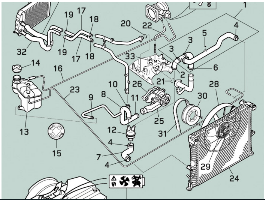

Hi. Florida: NO thermostat nor bypass, ever. Removing a stock thermostat will kill the engine if the bypass is not eliminated together.
Hotblockoutlet---->radiator---->pumpsuction---->blockinlet
The thermostat does not regulate coolant operating temperature. The stock thermostat closes bypass path and opens radiator path at its rated rising temperature, period.
Nothing else than re-routes coolant path. Does not regulate coolant temperature. The thermostat is there to avoid the engine to run cold for too long. A car manufacturer does not know if will be sold for Siberia or Panamá and is fitted to all cars made.
The operating coolant temperature is set by air ambient temperature + air speed flow + coolant mass flow in radiator + lead foot + climbing + rpm + towing + lean mixture + brakes drag... masked on purpose by an inoperant-by-design dash thermometer.

Poorman's inline thermostat :
Insert a golf ball in the hose between points 2 and 3 to condemn flow in the bypass path.
LOL at the golf ball idea - ingenious! However that will not solve the issue of the thermostat not opening the path from radiator to water pump - I have had probably half a dozen that had that issue. You can usually tell because they will not make it a city block without overheating. One of the frequent failure modes of the OEM design stat. Unfortunately with the OEM stat you cannot quickly remove the thermostat element to open the path and you cannot do it without losing most of the coolant. One of the biggest advantages of the inline thermostat is you can quickly and easily remove the thermostat element form the housing while loosing less than a cup of coolant and continue on your way. Maybe not ideal for heater temperature in cold weather but survivable whereas a thermostat that fails closed basically renders the vehicle undrivable very quickly.
