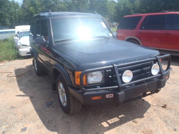

I found this truck at a local junk yard and it's a 2000 Discovery and I have a 2004 Discovery.. It's ARB bumper and its going cheap!
I can weld and make modifications if I need to... Your thoughts??

It will bolt on to your 04 with no modifications to the frame or bumper. No welding required. 00 and 04 have same frame.

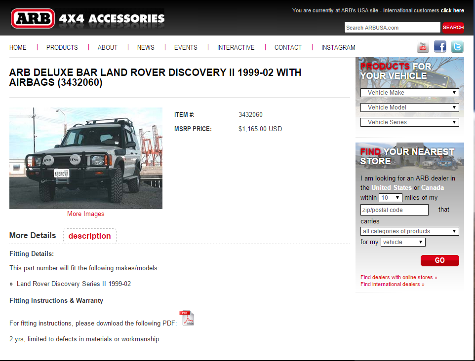

I've heard that, but even the ARB website is indicating differently...

ITs a difference in the plastic grill which will not cause you issues. It will bolt right on no problem.

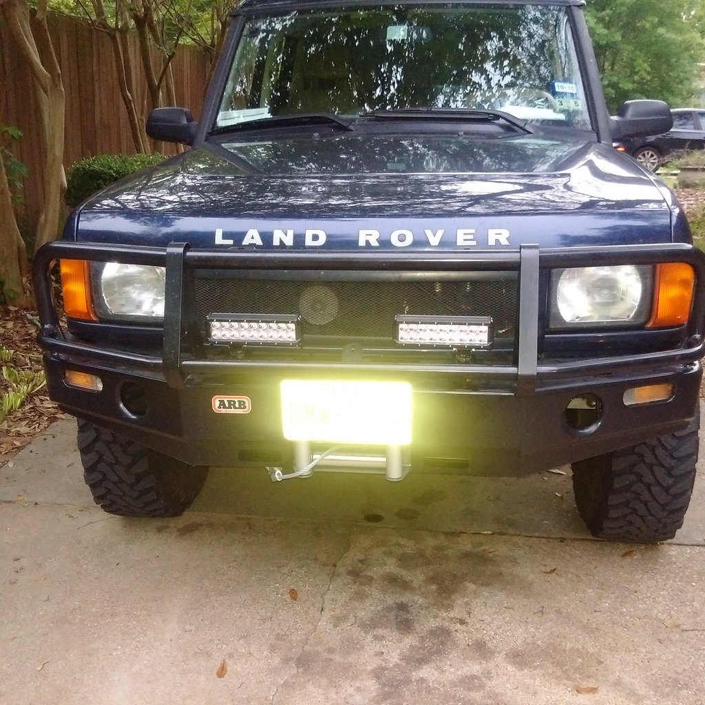

I have an 00 with the 04 ARB bumper. It will fit but there will be a slight gap at the grill because the 00 grill dips down a little. You won't even notice it, especially behind the lights. Be sure to get the frame extensions/crush cans.
Only difference between the two is the grill space and the fog lights. Plus you'll have those pusher bumps on the front face and I don't And you might have a recovery point. The 04 also has a spot for the round fogs.
