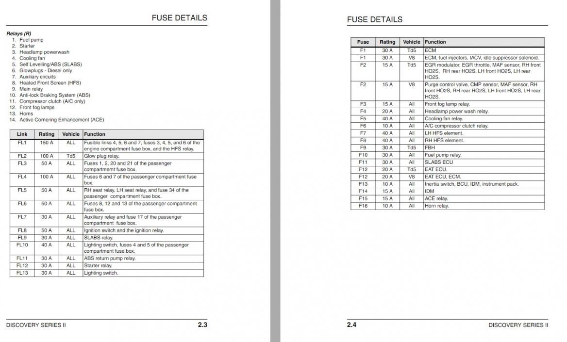

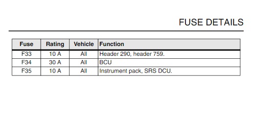

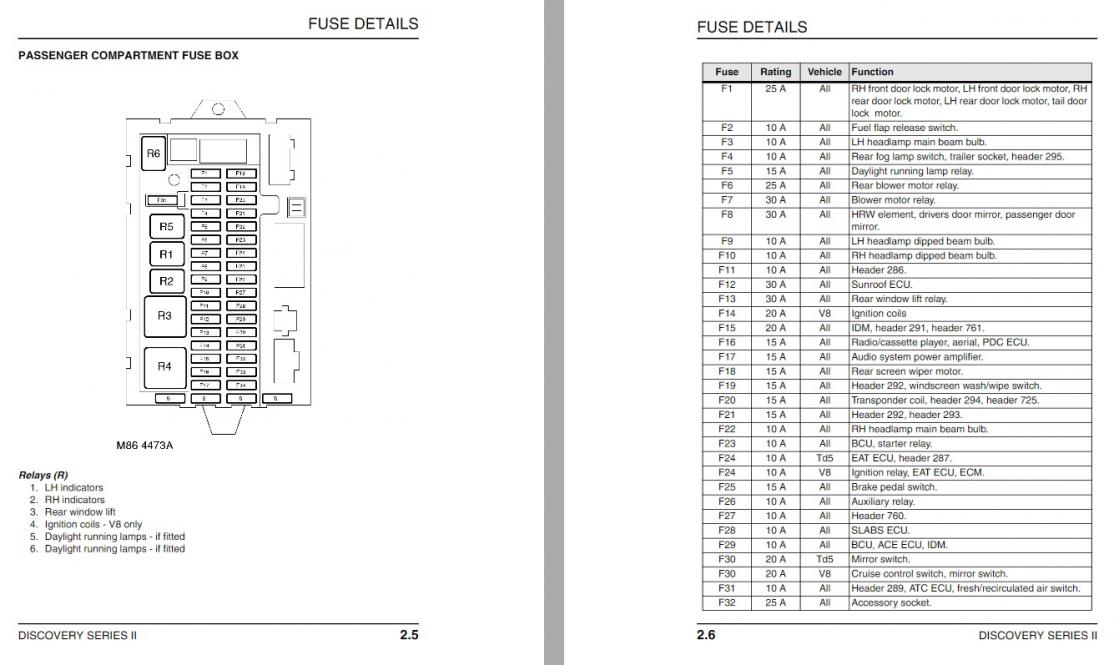

Check Inside Cab fuses 16, 17, 18, 19, 26. Engine Compartment Relay 7. Engine Compartment Fuseable Link 7.
I'd use a spare fuse to change each fuse to be sure there is not a non-visible break.
Attached Thumbnails Wipers-engine-compart.jpg   Wipers-fuse-info-1.jpg   Wipers-fuse-info-2.jpg   Wipers-fuse-info-3.jpg
