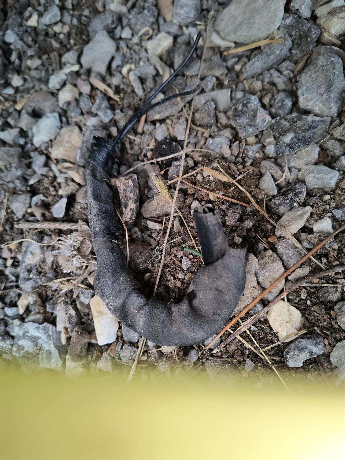

Looks like a mouse was in there. That sucks. I'd cut out the damaged wires and solder in new ones with heatshrink shielding. I'd seal the ends of the heatshrink with liquid electrical tape or RTV. That's a really crappy place to be soldering, for sure! Good luck!
Good heat shrink has something similar to hot glue inside that seals it.
Originally Posted by miron
The one from ebay is transmission harness and probably the one you need cuz there is only one harness piece in that area. Not sure how they will deliver it to where you are though.
Just twist the wires of the same color and tape with electrical tape to get you running. Have a pro do a proper fix.
This is a much easier fix than replacing the harness you linked. Just match colors. Use crimp connectors. They make a type of crimp connector that you can heat after it's been crimped and it will seal itself to prevent future corrosion.
If that's above what you're able to do, you definitely will not be able to replace the wiring harness as a whole. If that's the case then you need to find someone who will haul it to a mechanic.
ing

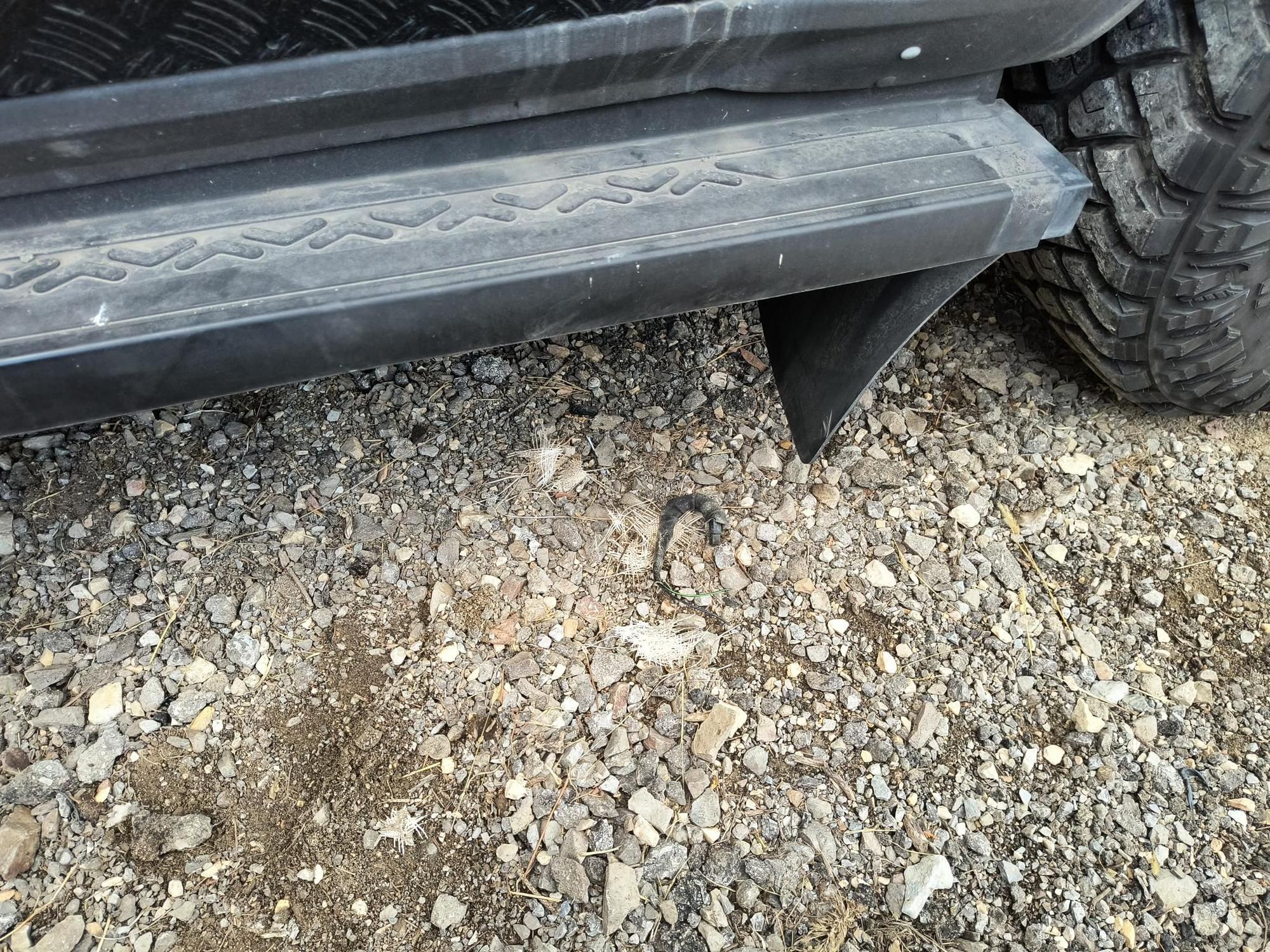

Can this thing wired in? And I don't see any wires chewed ... Looks like it was ripped out..

I need to pull it out of there .. tow it out .. .. but theres no shops here .. or they dont have the skills. .. they dont speak english .. . I .hope dont have to send it back because of this ****. ..

Looks like temp sensor connectors for either the t case or trans. They can be wired in. Same logic, strip ends twist together, secure with some tape.

Some of the plugs around the transmission/transfer case are not used on every truck. As said, that looks like it could be a temperature sensor connector which is not always used. So if you reconnect it, you could still end up hunting for someplace to plug it in which doesn't even exist.
Nothing about reconnecting the torn wires is specific to Land Rover. It's literally just finding the wire with the same colour insulation, stripping some of the insulation off, and twisting them together.
That will only be a temporary fix until you can find someone who is going to be able to reconnect things permanently (i.e. solder and shrink) but it's better than nothing. Or you could take your original path of tearing apart the truck in order to replace the harness (possibly multiple harnesses) -- which WILL require someone with Rover knowledge, or at least the patience to thoroughly read service manuals before tackling the job.
