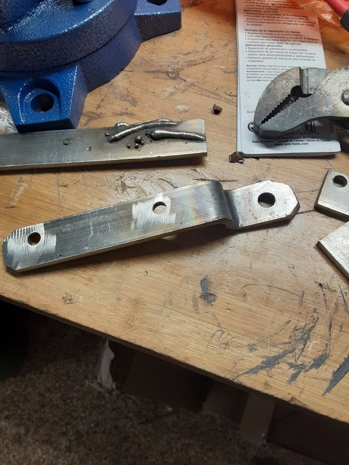

Remote Coil Mount

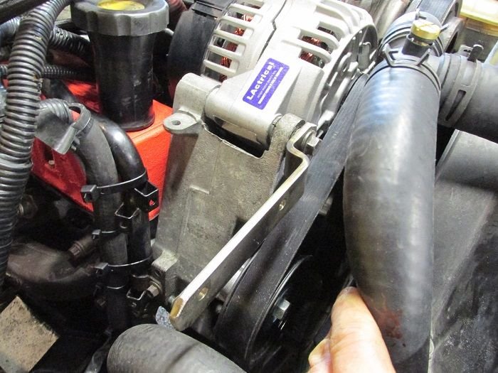

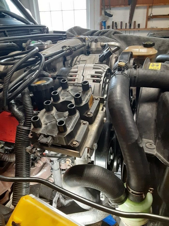

been done before, but this is how I did it:
Heated and bent stainless bar for upper brace. Drill hole size exactly for alternator bolt so that when tightened, it compresses the pinch grommet (you do not want it slipping OVER the pinch grommet.....). Lower brace made with mild steel. Welded a bolt across the brace, and added spacer nut.
Used a Morosso wire loom, shortened, bent, and drilled for AC compressor bolt. Only cost was the spark plug wires 'High Performance' ignition wire set IGN 790GC and the EV1 3 pin connectors (2 x male, 2 x female)
Started right up!

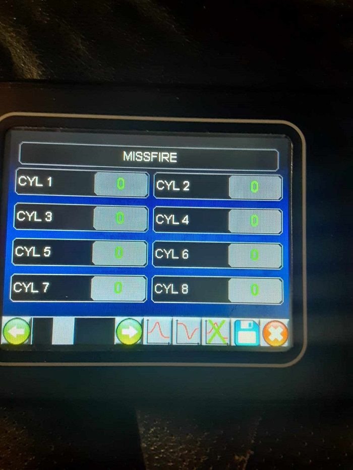

well....crap! Cylinder 4 misfire. Swapped coils (cause its easy now!)....no change. Swapped leads...no change....Have great spark....so......
looks like intake coming off again and I will have to put the noid lights on the injector plugs...and probably swap out #4 injector for one of the old ones.....
sheesh....
Other than that, she is quiet and smooth with ZERO tapping....at least one thing worked out....

well, after removing the upper intake this am, I found that I had swapped #'s 6 and 4 spark plug wires at the plugs, ugggghhh. stupid simple error. They were in right location on coils. Runs fine now.....drove 20 miles no issues.

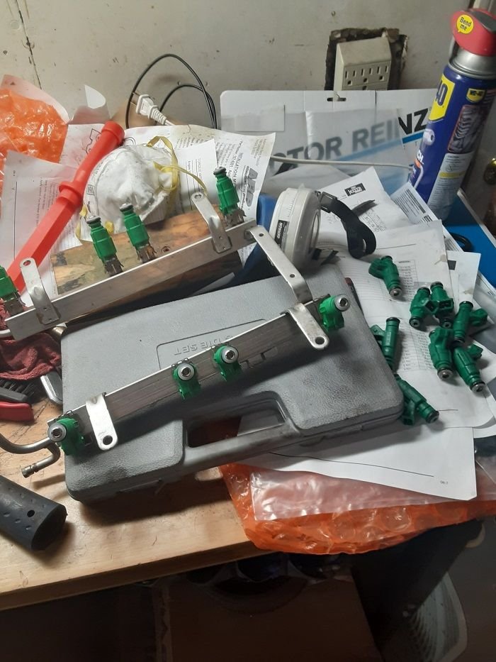

Well...the ebay rebuilt injectors for 89$ had an issue. One stuck open!.... Soooo...pulled the top end and replaced all the injectors with rock auto chinese versions @ 20$ each. Turned her over and had a momentary hydrolock from all the fuel which had leaked down from the original bad injector(only gave her half a crank and stopped)....I pulled plug 6 (lucky guess ..and this was one of 2 throwing misfires on nanocom before changing injectors) Turned her over and out sprayed a bunch of gas..nice!
Plug back in and she fired right up, no misfires. smooth idle.....wayy more power now. Glad no damage from the hydrolock.......

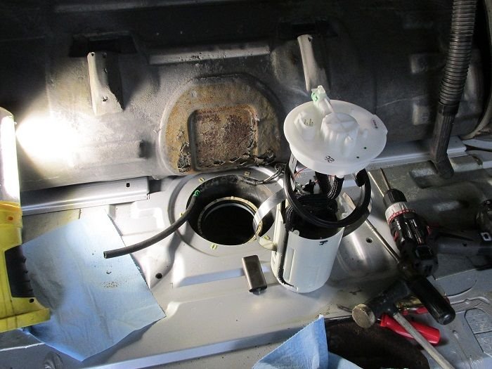

So i'm still having a little fuel pressure loss. Used to start right up. Now it has to crank a few times.... So I put in my spare SAI fuel pump. That was fun.......Get the amazon 10$ interior removal tool set (the one with TWO metal tools)..makes it easy...daughter got involved! she was really helpful! ...
Hardest part was getting the rusty ring off the tank.... Old pump practically falling apart(one spring did fall out).....the tank sender was really loose.....New pump went right in. No issues with the original rubber sealing ring...was as good as new. I sprayed a bit of WD40 on pump edge and it slid into the installed ring easily. Got an allegedly 'real Bosch' pump (in a labelled box with same marks on pump as bosch pics) off amazon for 180$ delivered a week ago. I'm sure it's more than that today........Tons of power!! Went out for a few laps around town....She really scoots......
but still having slow pressure loss....no fuel smell in intake or around engine...all fuel line connections dry.....maybe an injector again (or a bad injector ground wire shorting??)....I will give it some time for all the seals to swell up a bit.....see what happens...

Can you supply a drawing for those brackets with measurements for the I can make fit with a bigger hammer types
