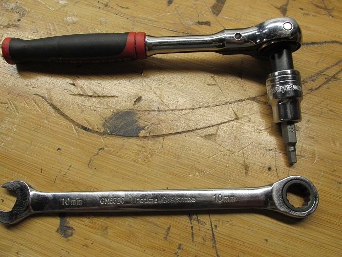

Gray/yellow is top wire in pic. yellow /green is right below it (this is the one you want...it's also slightly thinner diameter than gray/yellow)... whole job with heat shrink and solder joints took about 1.5 hours...
remove air intake tube, relocate power steering pump reservoir, remove x3 10mm nuts on the shock mounts. Also, unhook the x3 brake lines from firewall clips. Lift ABS block up and out. Cut a 2x4 size piece of wood about 8" long and use this to hold up the ABS pump block. BE CAREFUL REMOVING THE allen head screws. Seat the allen wrench completely into screw. They are fixed by threadlock. make sure you have the CORRECT size allen wrench (I used a 5/32 which fit really well). And don;t push up on the ABS block so hard that you break your brake fluid reservoir! (which is less likely if you remove the brake fluid level sensor wire harness first)

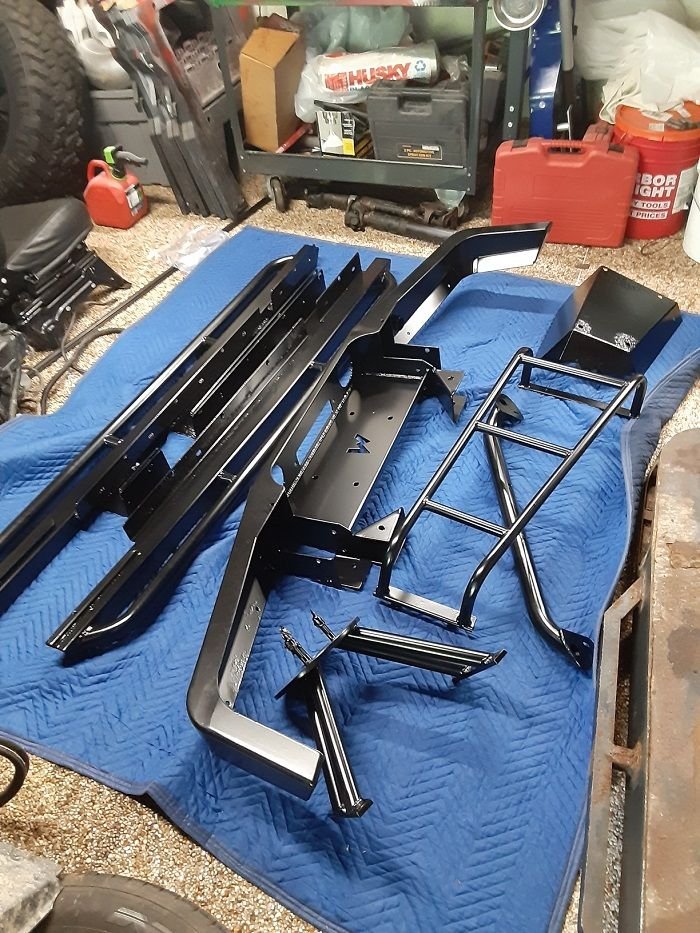

Got some parts done at powder coater. Came out very nicely with satin black...which is really like semi gloss.. still removing parts off the 01 disco...just have some suspension work and the TC to do...
