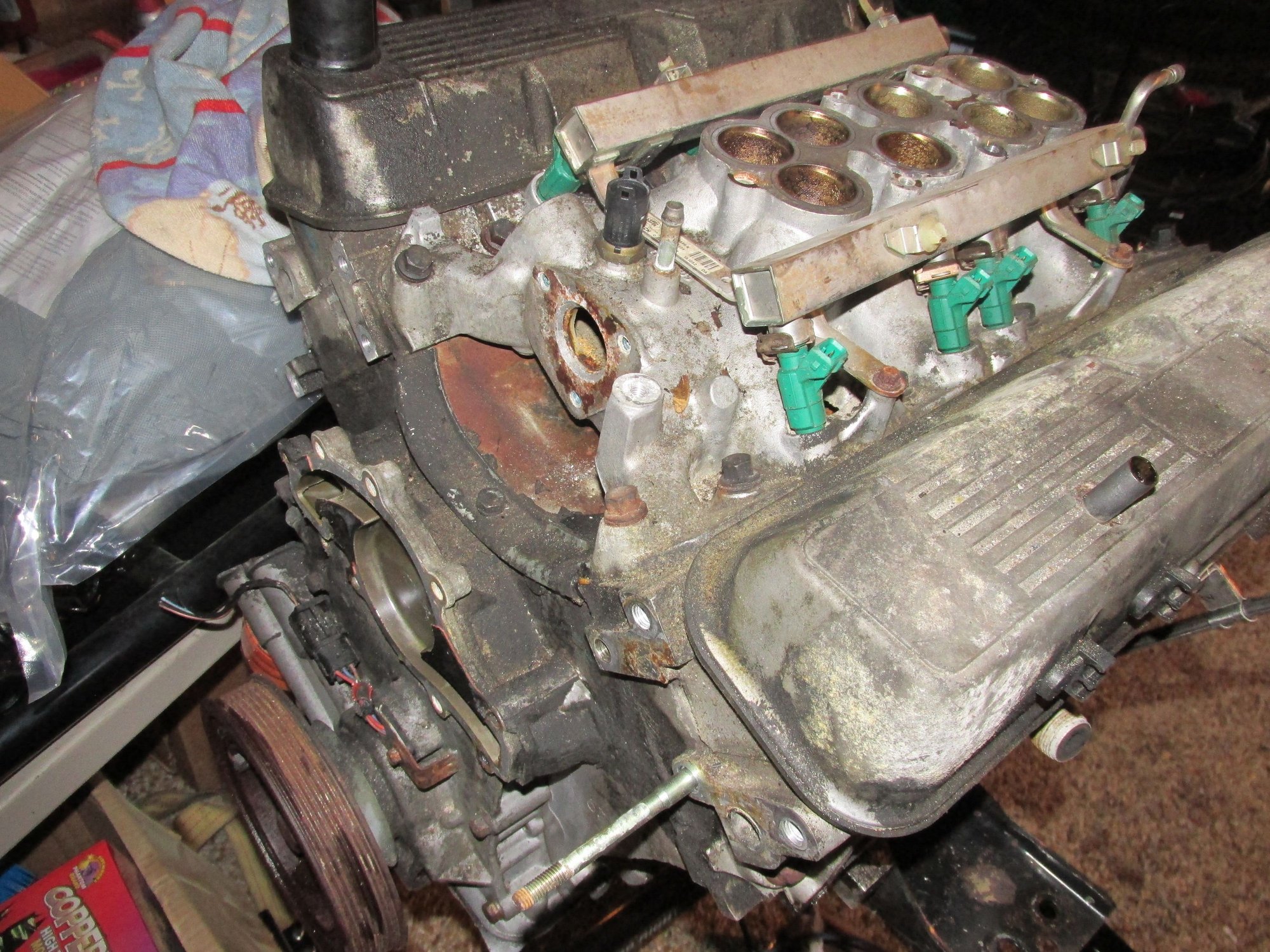

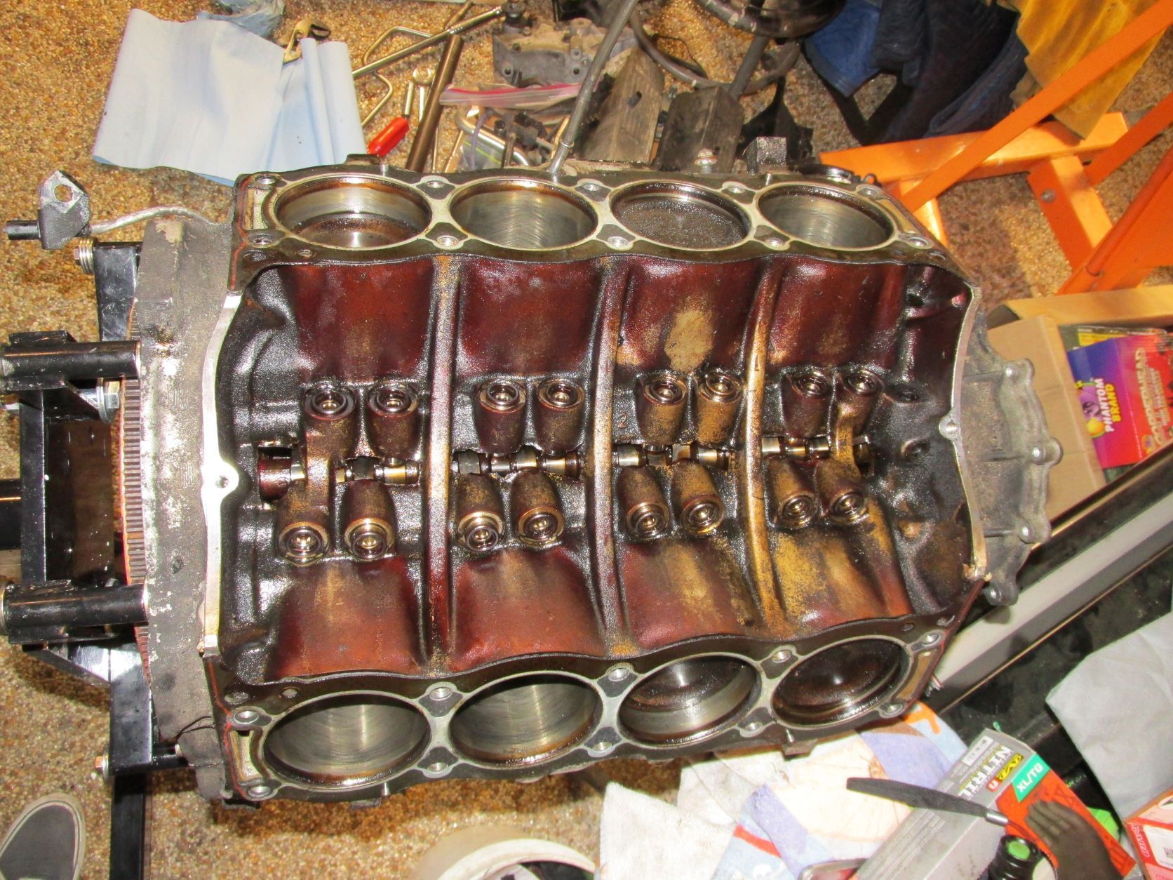

well, so far every bolt came out no issues, and they all look brand new. I do not think this engine has ever been apart.....no major coolant corrosion...very clean intake....it had new spark plugs, plug wires, and oil filter. The flex plate was cracked. The RR body was in good shape and the interior was clean...so I suspect someone took care of this for a while.....will see as I get deeper into it....

Engine teardown continues.....everything very clean. plugs with fairly even burn. fairly even carbon in all cylinders. OEM head bolts and OEM LR composite head gaskets on both sides. No dropped liners. cam lobes smooth. even smooth wear on push rod ends. Took the usual 4 foot breaker bar on a 1/2 drive 5/8th deep impact socket, and my son holding the engine stand. But, they all came out in one piece and with no aluminum packing or corrosion in the threads. crank turns over very smoothly by hand. hone marks still in all cylinders.

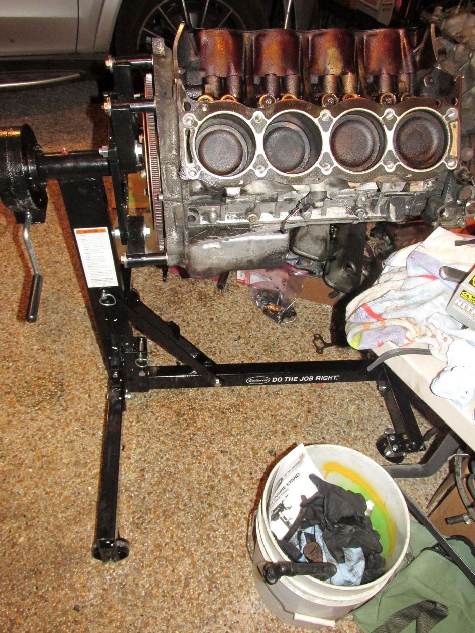

a note about tools. I bought an Eastwood engine stand to replace a old stand. It has a crank on it. This makes a WHOLE world of difference when dealing with a 400lb V8. It is designed to fold up as well. But honestly, all the reviews were right...like ' the welds are not the best' or 'some of the holes don't line up completely'....and 'the box came beat up and missing bolts'...all of these are true. but it is a few hundred less than a similar style from another vendor. And I like how it has four fairly well spaced wheels for balance, and they are all cast iron (no bearings, though). Four casters instead of two would have been nice.....but I could always add those...
