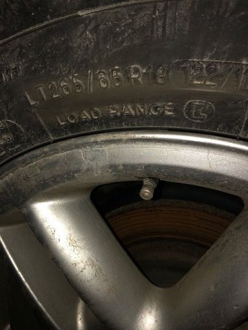

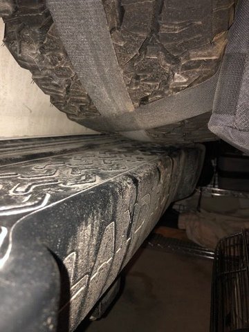

Default Tire size 2004 Disco 265/65R18 LRE BFG AT
Originally Posted by mln01
Thank you for this information. Did you flip / invert the spare tire carrier to gain clearance from the bumper? It's well documented here that doing that moves the spare up a bit for a little more clearance.
I'm running BFG AT LT265/65R18 LRE tires. My vehicle is setup for overlanding: Tent, Fridge, Awning, Winch and other related gear (tools, recovery gear, cooking gear etc.) so it's always carrying extra weight. I am running 1" coil spring spacers front and back (from Lucky8). I do get a little (very little!) rubbing at full lock turning. OEM springs currently, I do have HD springs sitting in the garage that will be installed shortly.
Spare tire: I did flip the OEM spare tire carrier - have about 1/2" between the bumper and spare tire.
