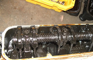

With many of us operating older Discos with high miles, the thicker oil has a space to fill. Of course, if you follow the factory change interval, skipped every time the stock market fluctuates (leased vehicles are not always serviced when they should be, nor are those owned by people with real world money problems). Iffy Lube wants to put in the whatever, so be specific if you want engine to last longer. Change early and often so the innards don't look like some of these. Castrol and Rotella at 190K ish, then some that did not. Reddish one is dealer change intervals at just under 50K. Oil change is one of the cheapest things you can do for your truck. Now the exotic 25,000 mile oil changes - sorry, Rover is not built to those kinds of tolerances, 5000 is more like the max. It might last 25,000 - but if it gets dirty from wading, etc., then you'll be driving 20,000 miles on puke oil and thinking everything is just great. There is one spot in the Rover manual that says oil may have to be changed daily in arduous dust conditions.
