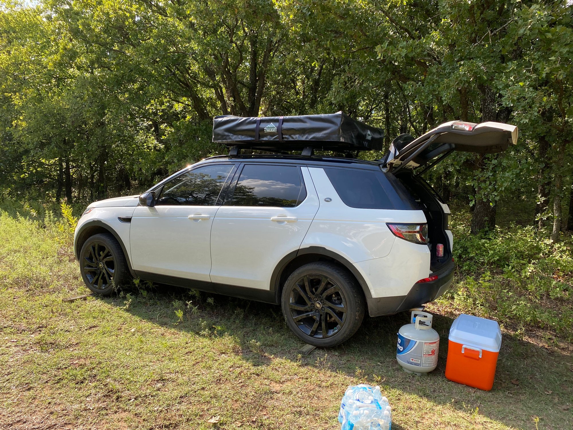

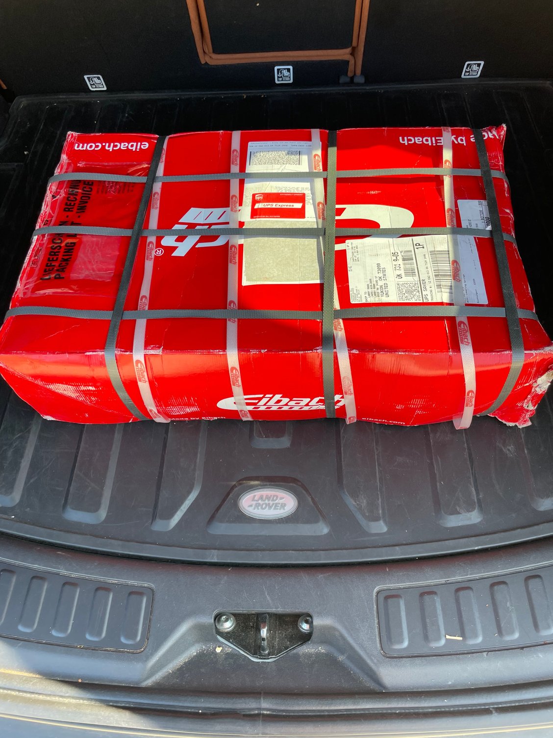

Call me crazy, but I’m doing something most DS owners don’t do. I bought a set of Eibach “lift” springs and new 275/45R20 Atturo Trailblade tires. I’ll Take it into the shop tomorrow to have the springs fitted and the tires should be mounted by the end of the week. I’ll post Up impressions and photos with the results.
Here’s Disco Steve as he sits now.

The springs:

Disco Steve has been lifted. I gained exactly 2” with the springs and tires.
Absolutely love it! Looks better and rides better! Totally worth it!

Thanks!! This was a fun mod that adds a little something to the often overlooked DS. I think it’s a great bang for the buck mod for DS owners who want to push their DS a little farther. I’ll post up some things we get into and how the DS handles it.
I took the nonsensical front air dams off this morning. Opening up quite a bit of unobstructed clearance.
