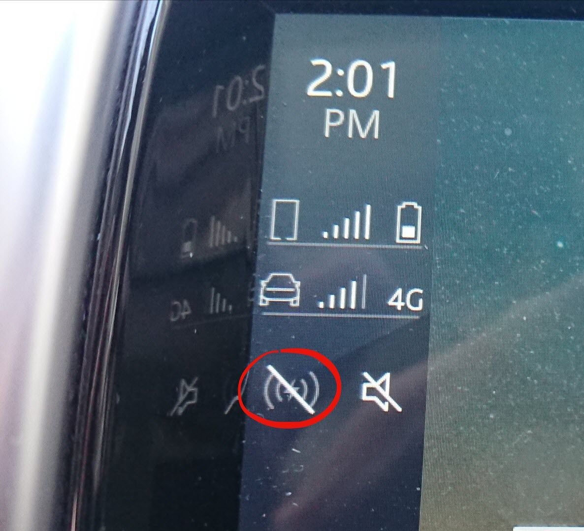

My DS (Australia/2022) is annoying me by an intermittent status icon as shown in the picture. It looks like it is saying I haven't got a signal - but the signal bars above look healthy.
What annoys me more is when the status changes the icon disappears and the display does a distracting shuffle. Can't find a picture of this icon in the manuals - so can anyone tell me what the car is trying to say to me.

That is a wireless charging pad related icon, examples of which can be found in the online owner's guide under Wireless Charger. However, I can't find that exact symbol in their list, so can only assume it denotes a problem with the charger power supply? The nearest symbol they give shows a small battery icon with a cross through surrounded by 2 split concentric circles which they state denotes a foreign object in the charger tray.

Thanks for that idea. We don't use the Wireless Charger but do keep an assortment of other stuff in the charger bay. I'll try emptying the bay and see if the intermittent icon goes away.

I have confirmed that when I take my sunglasses out of the wireless charging bay then the annoying warning icon does not appear. Problem solved.
