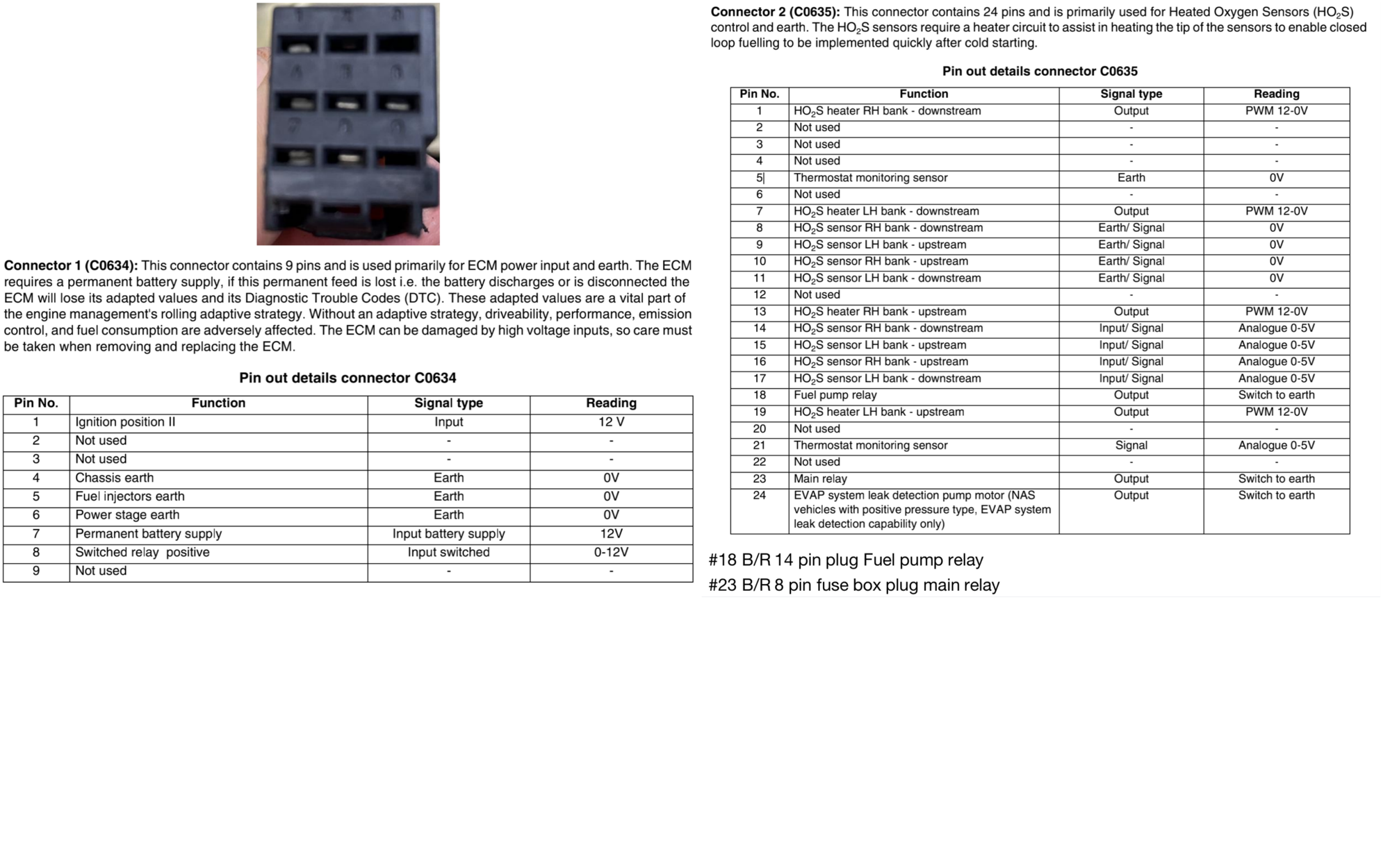

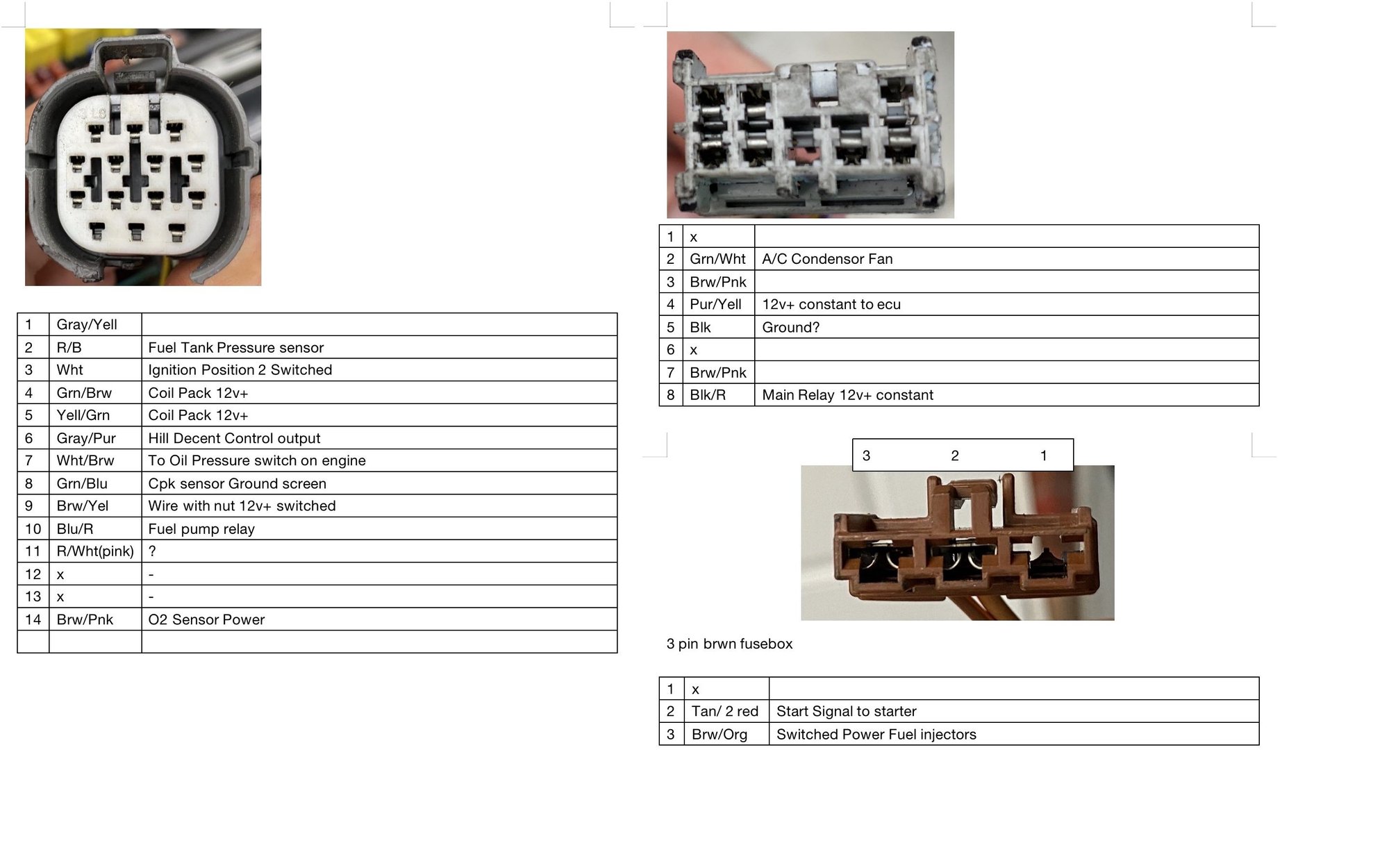

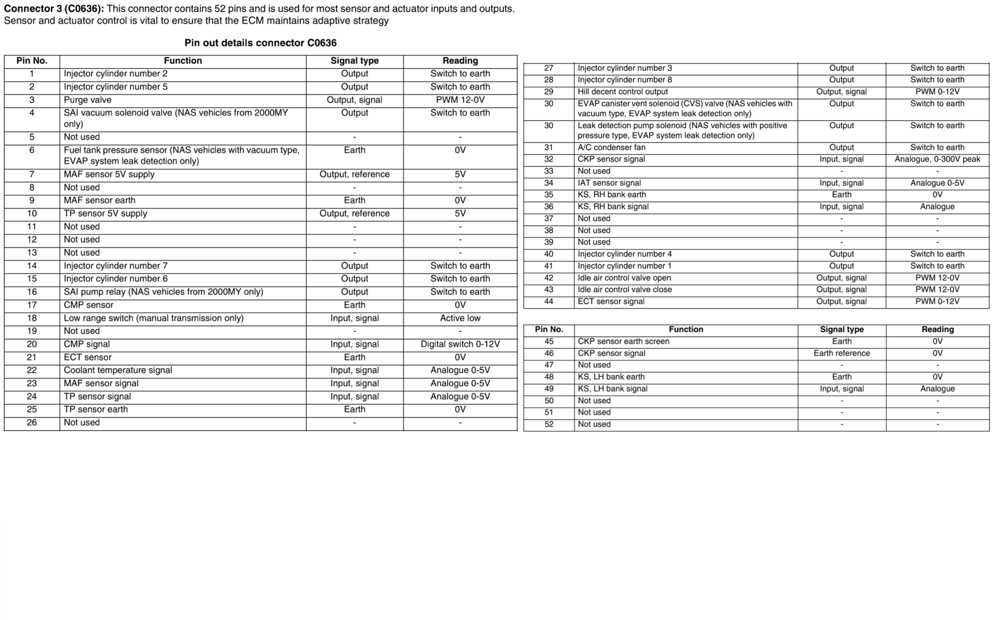

I put this together when I did my swap. I hope some may find benefit when doing your swap.
I referenced the wiring from the service manual. this is what I used. please feel free to add to it it may differ between years.
ill have to add a picture of C0635 plug later.
I will add a pic of the GM black plug later. it is more universal but still works well.
I didnt take a picture of this plug. when I get around to it I will add it later.

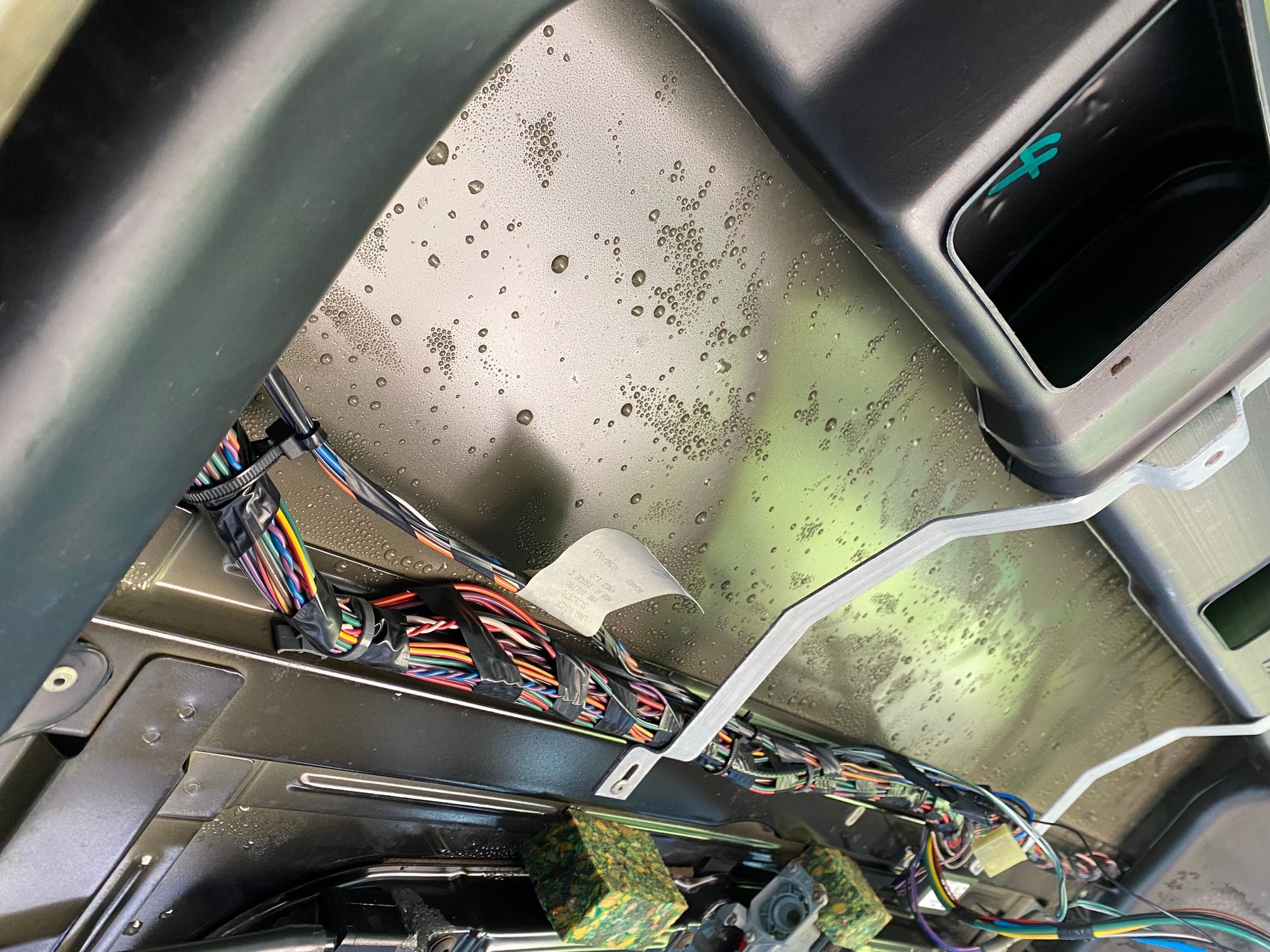

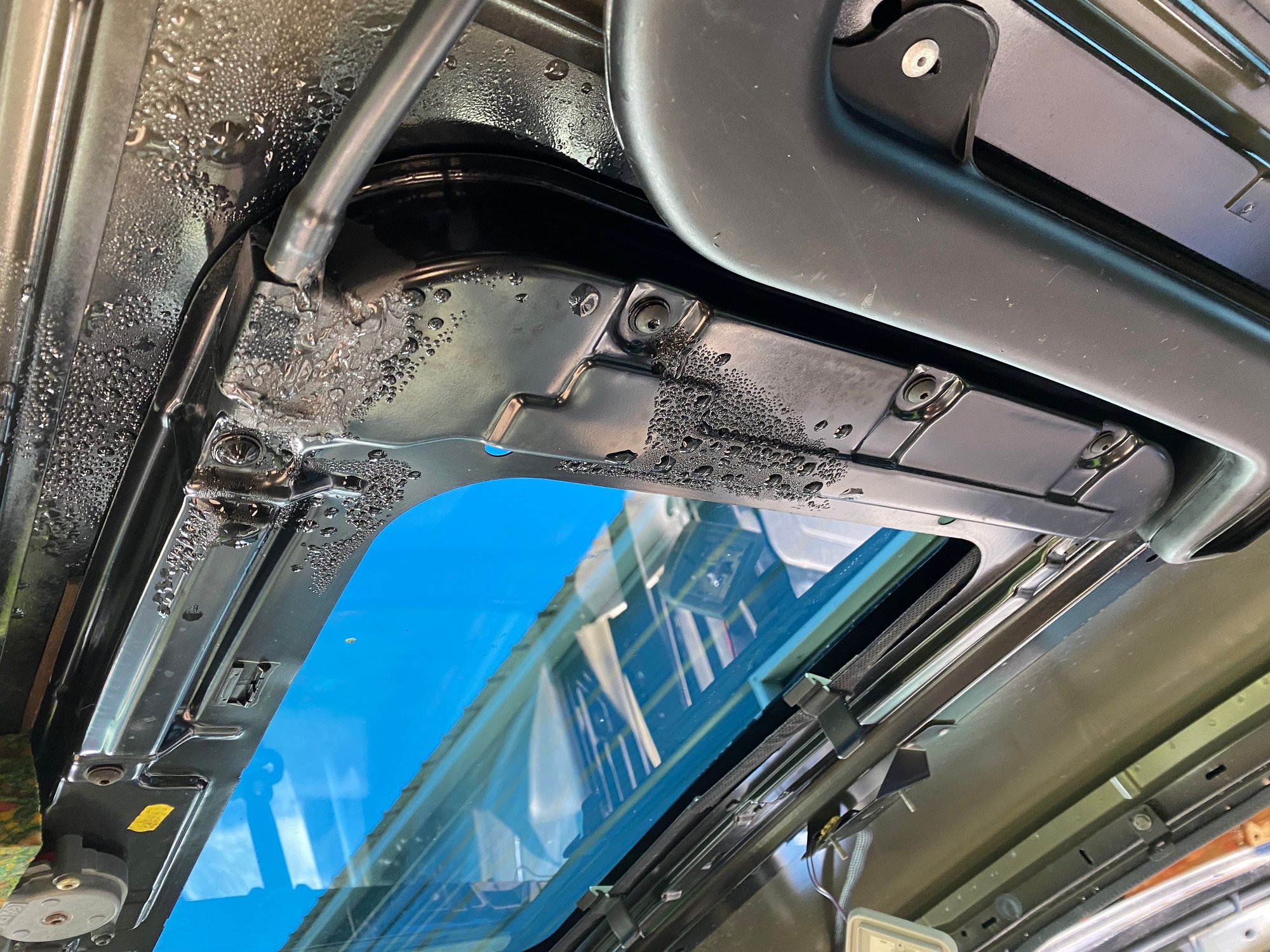

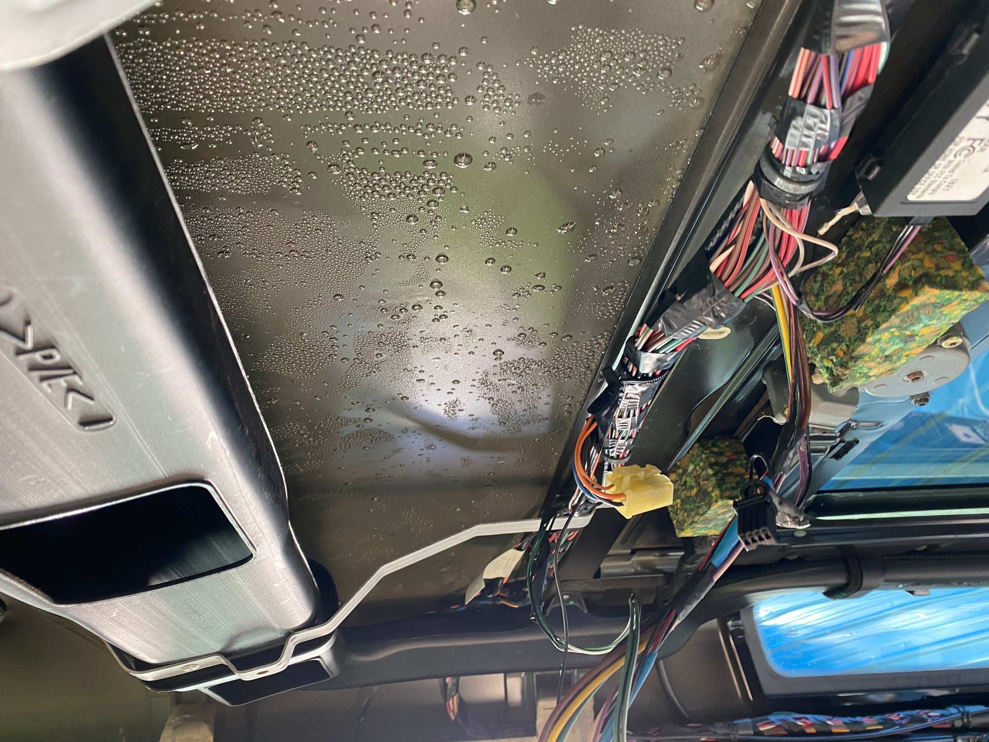

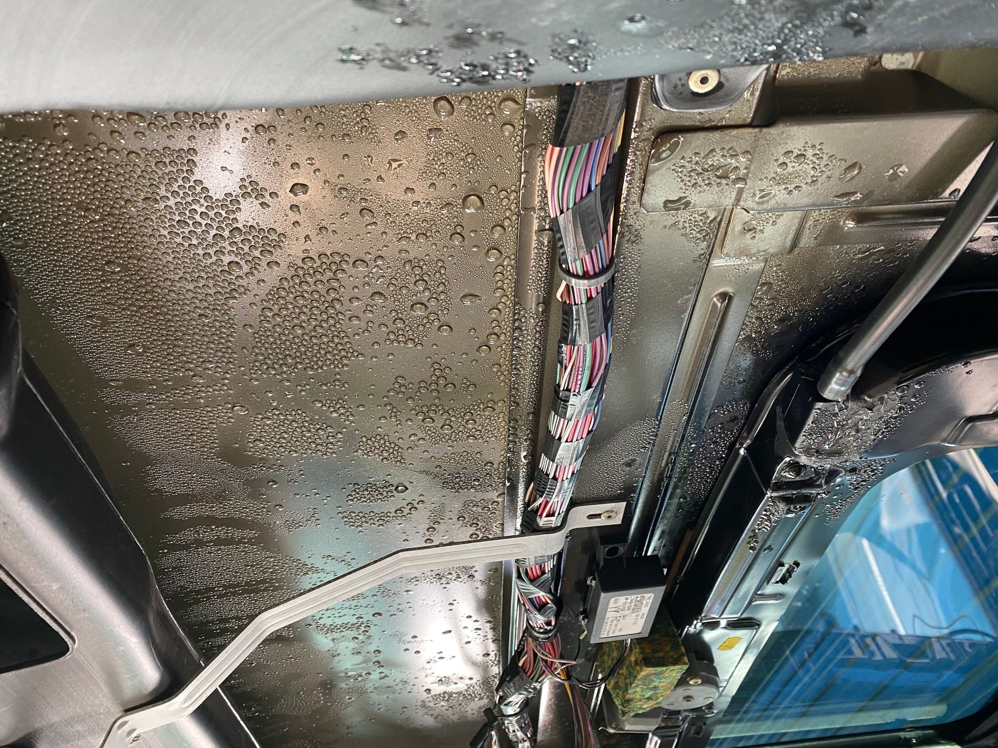

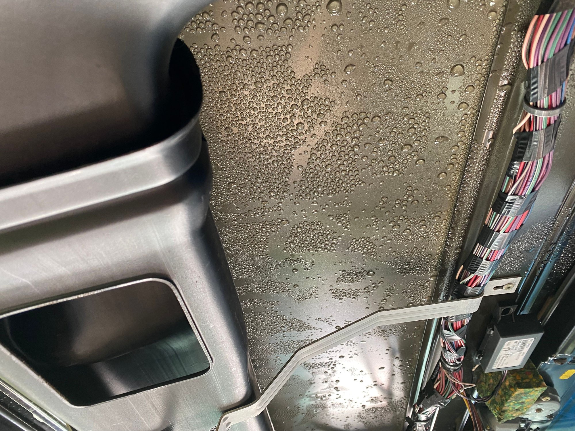

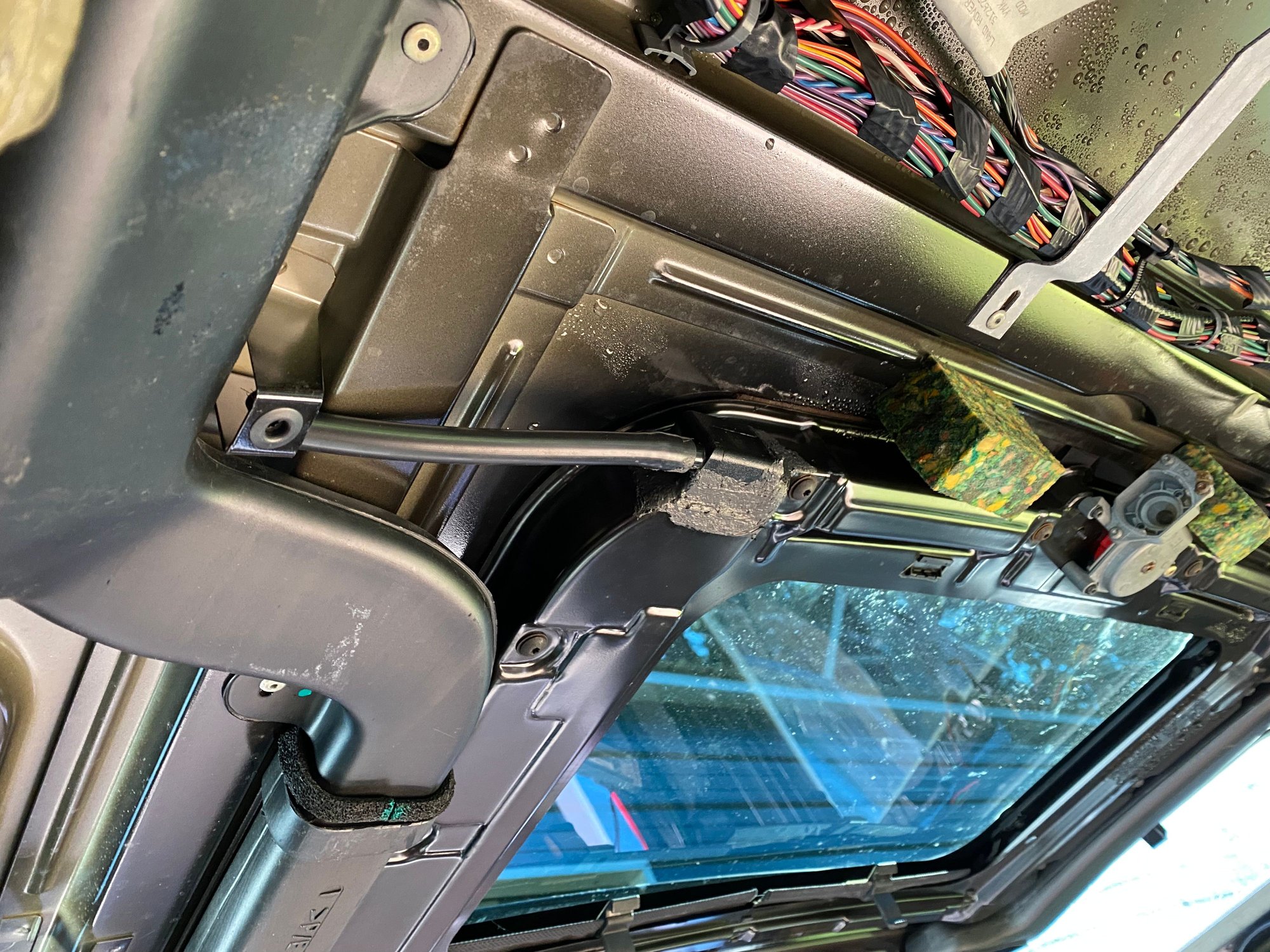

I had time to do some upgrade work but I ended having to repair leaks. I was checking for leaks. rtv from job from 2022 is holding up. This time I did black rtv for sunroof frame seal and around the alpine windows. as of now it's no longer leaking. but I will leave headliner off and check again after the next heavy rains.

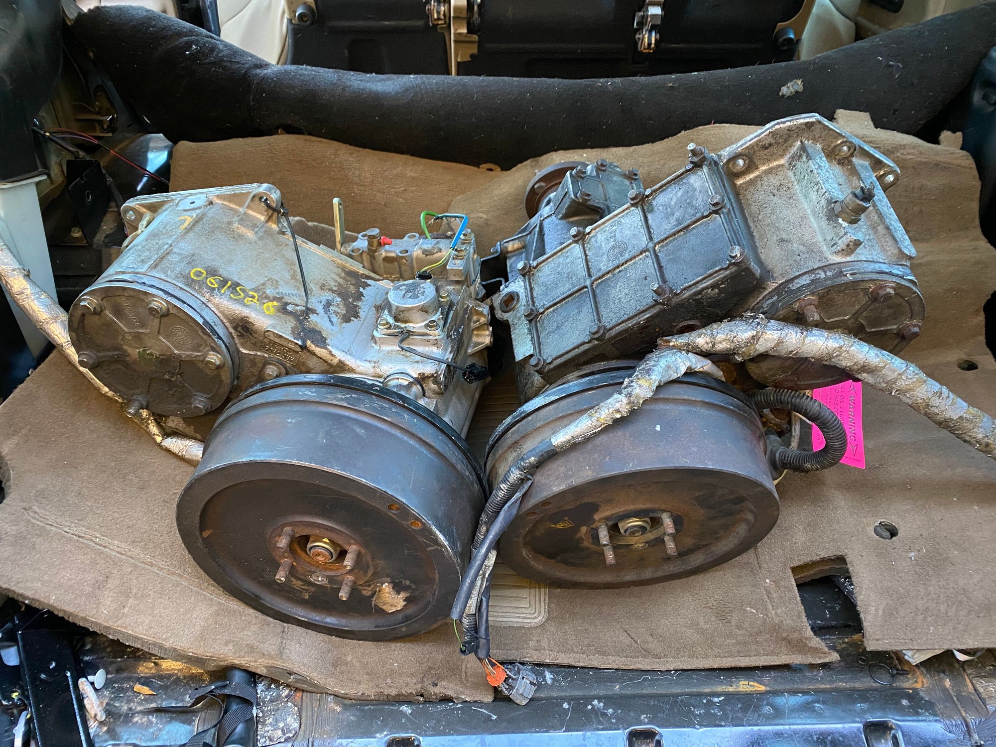

While I was around I was able to pick up the 2 Tcases. Both have CDL I will refresh them and they will be ready to replace or to do another swap later.
