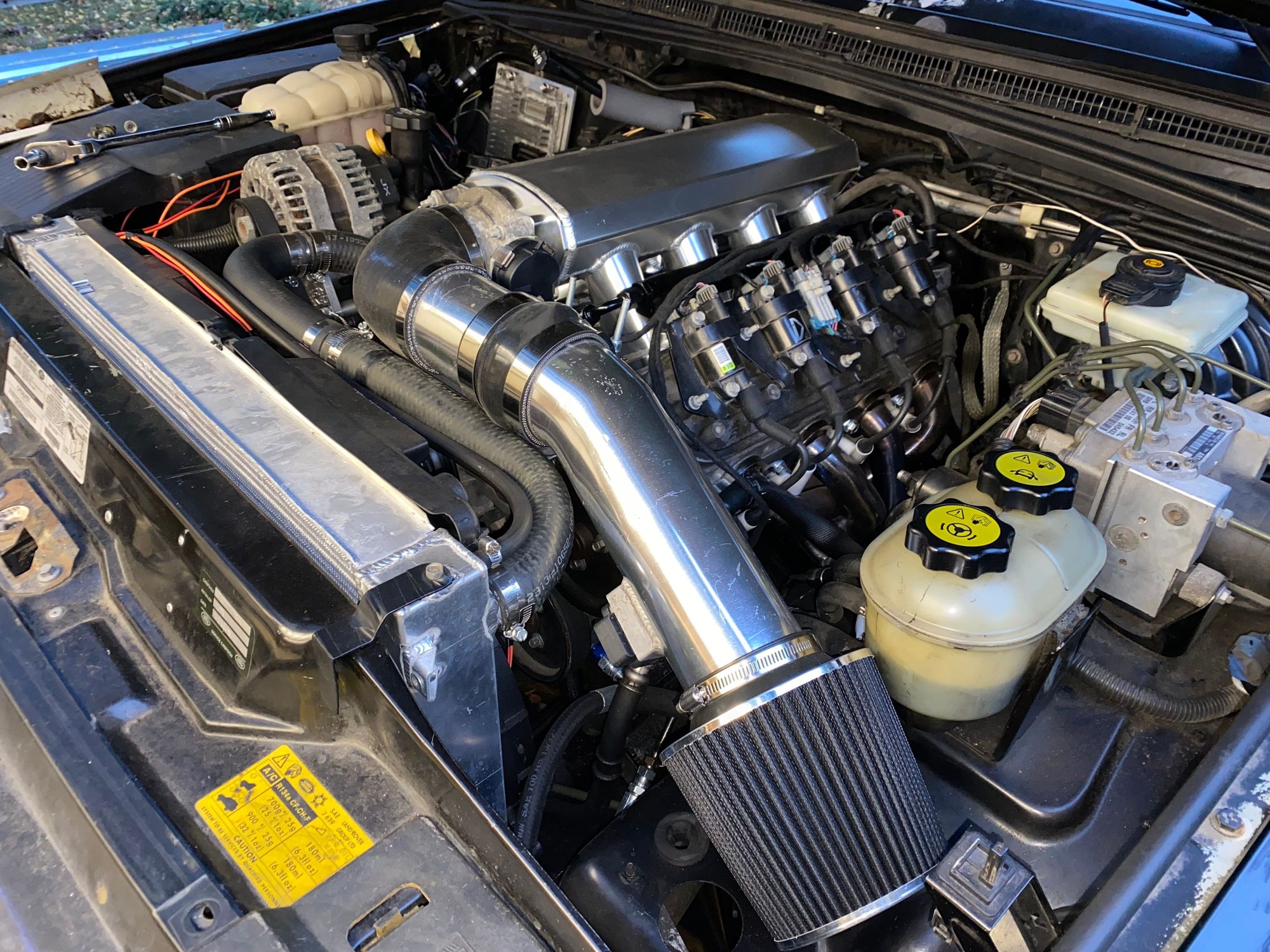

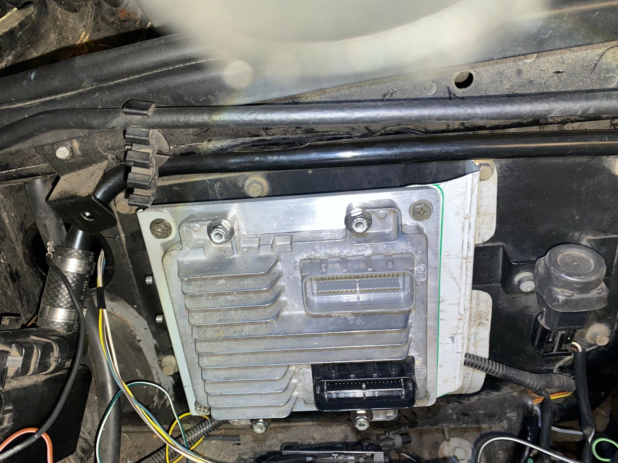

Ecu mounted
I finally mounted the ecu against the firewall. I can clean up the wiring and be finished with it.

The engine bay is looking good! Great work.

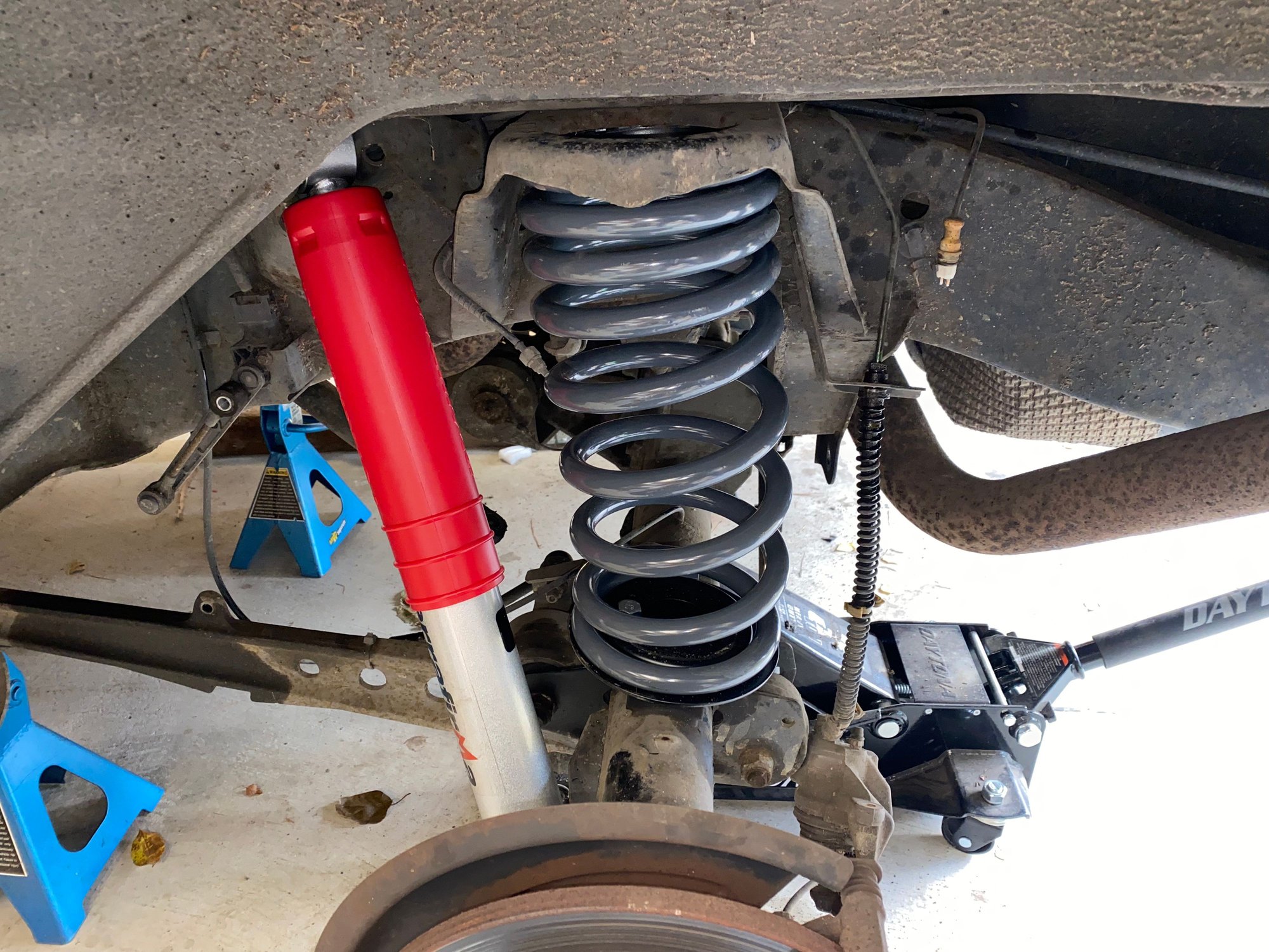

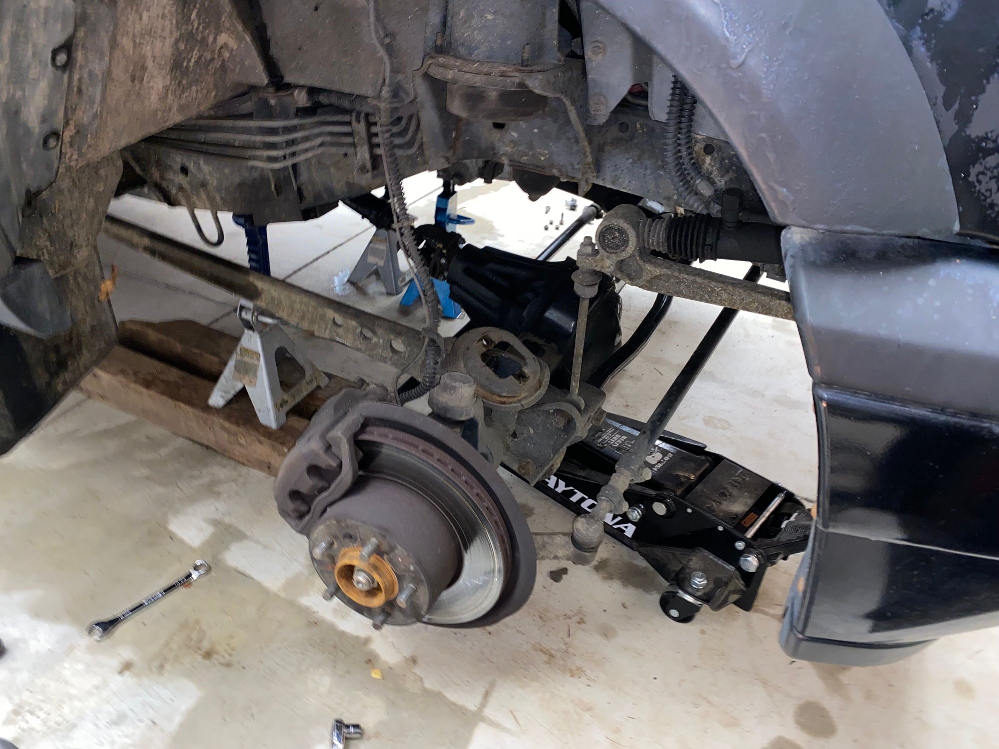

I installed the 4" TF lift kit. Now I have to work on getting new wheels and tires. I didn't take pics of radius arms, watts linkage(I have to press new bushing in the center piece), and pan hard. I painted the radius arms black. the pan hard bar came in black (not sure if that is TF brand?) Brake lines etc... are installed

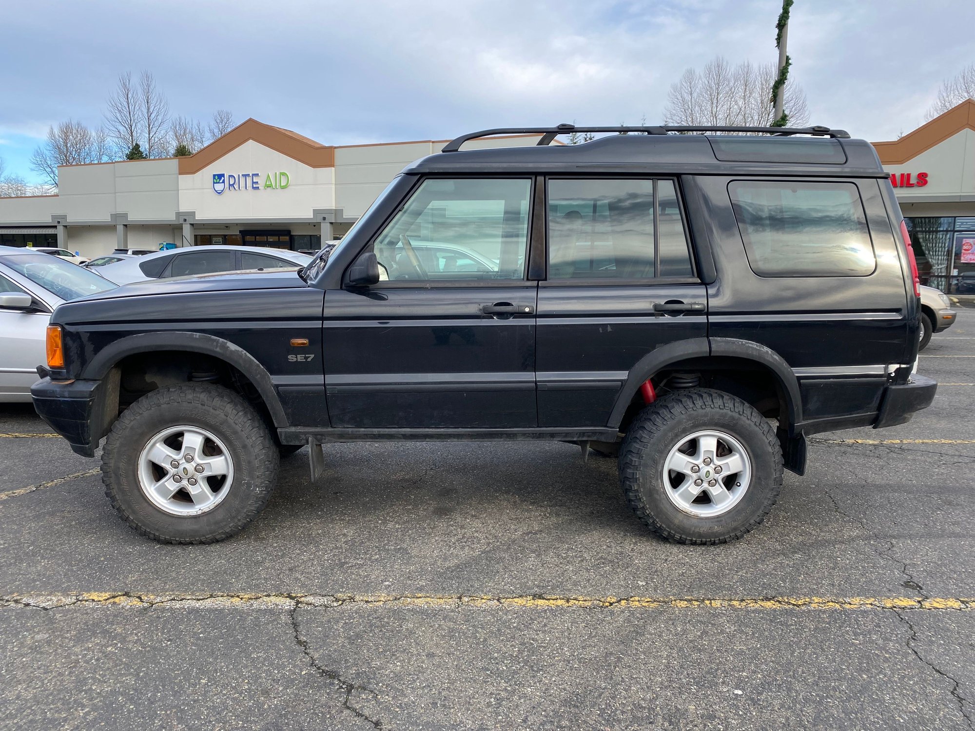

New to me Wheels.
I will be building rock sliders with metal I have laying around. later I will get some bumpers. Still lots to do.

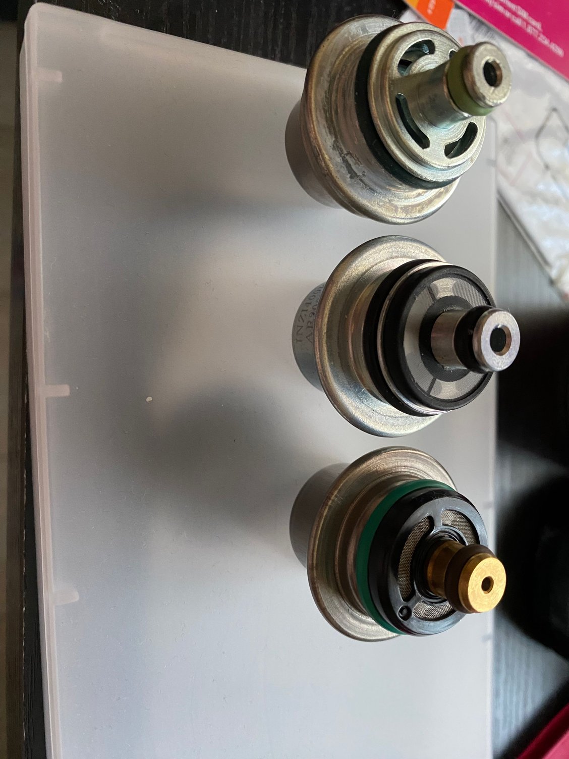

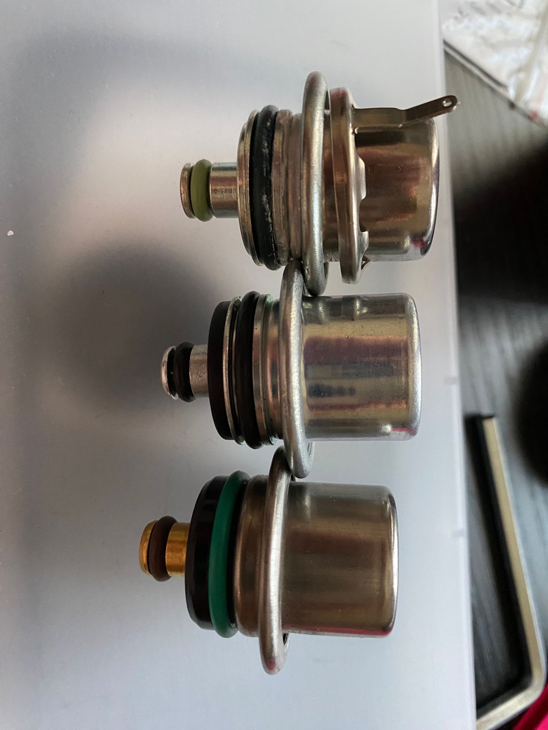

I know from the service manual from discovery and avalanche the fuel pressure is about 8 PSI difference.
so what I wanted to do so I don't have to modify the fuel system was to just replace the discovery fuel regulator. I also know gm has something similar in the avalanche and other vehicles.
because I couldn't find just a regulator to buy and to get a regulator from gm vehicle requires dropping fuel tank on most vehicles I didn't want to do all the work and then find out that the sizes may be different. when I get a chance to go to junkyard and find one easily accessible I will confirm information. Currently I was able to find a source for the fuel regulator separately. If anyone has found them let me know.
Here are the pics. 4 bar or 400kpa
only pic that shows location of regulator
top one- original. 2 other option below. but they are 4 bar pressure.
