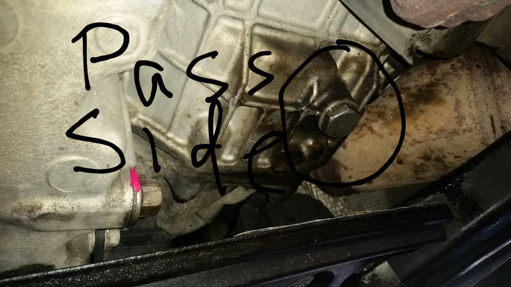

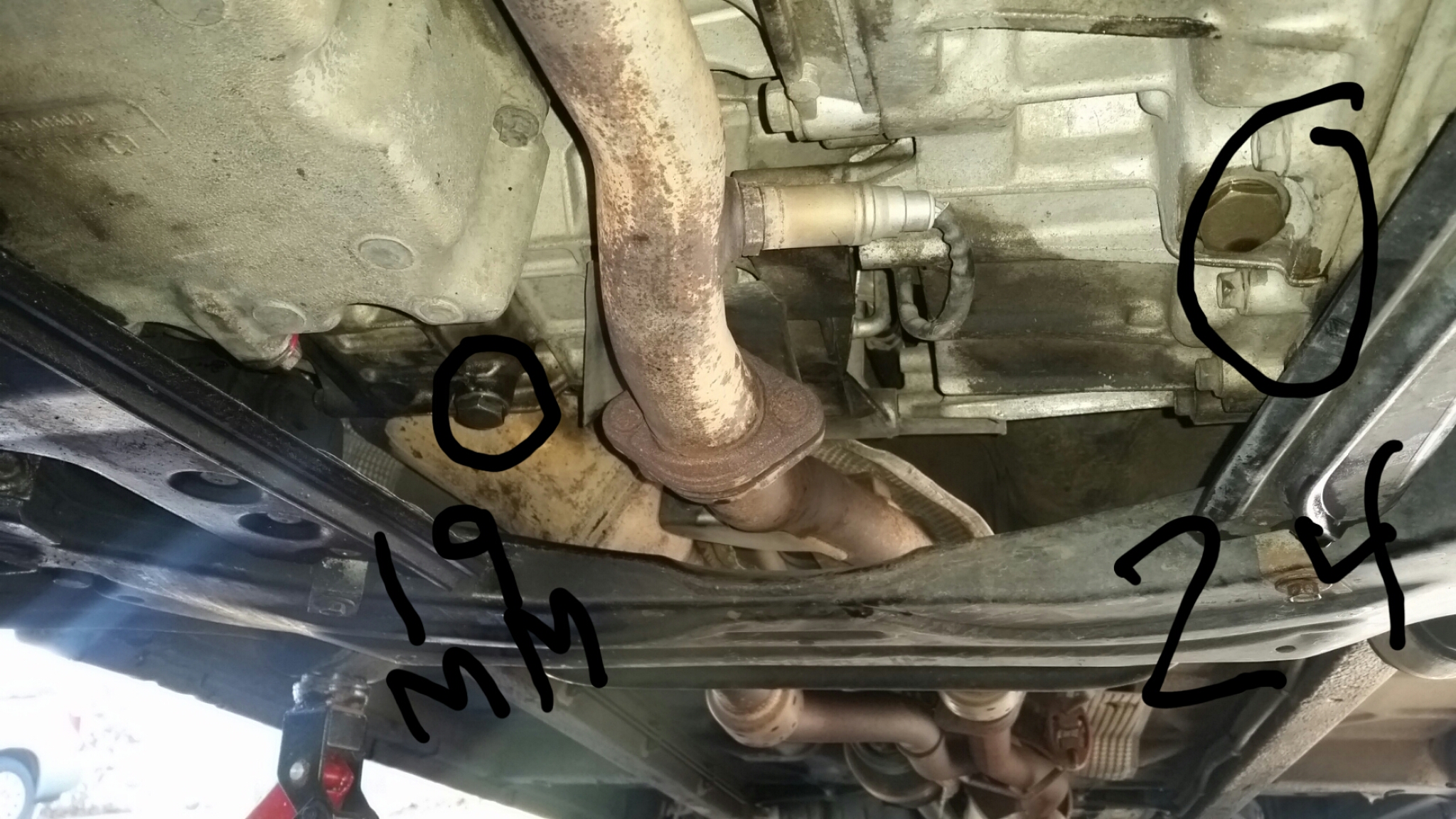

After installing both axles, I opened the smaller (19mm?) plug on the passenger side and drained out about 3/4 quart more fluid. I then opened up the upper fill plug , which was next to impossible to access, and filled with 75w90 synthetic. It took about 1.25 quarts total.

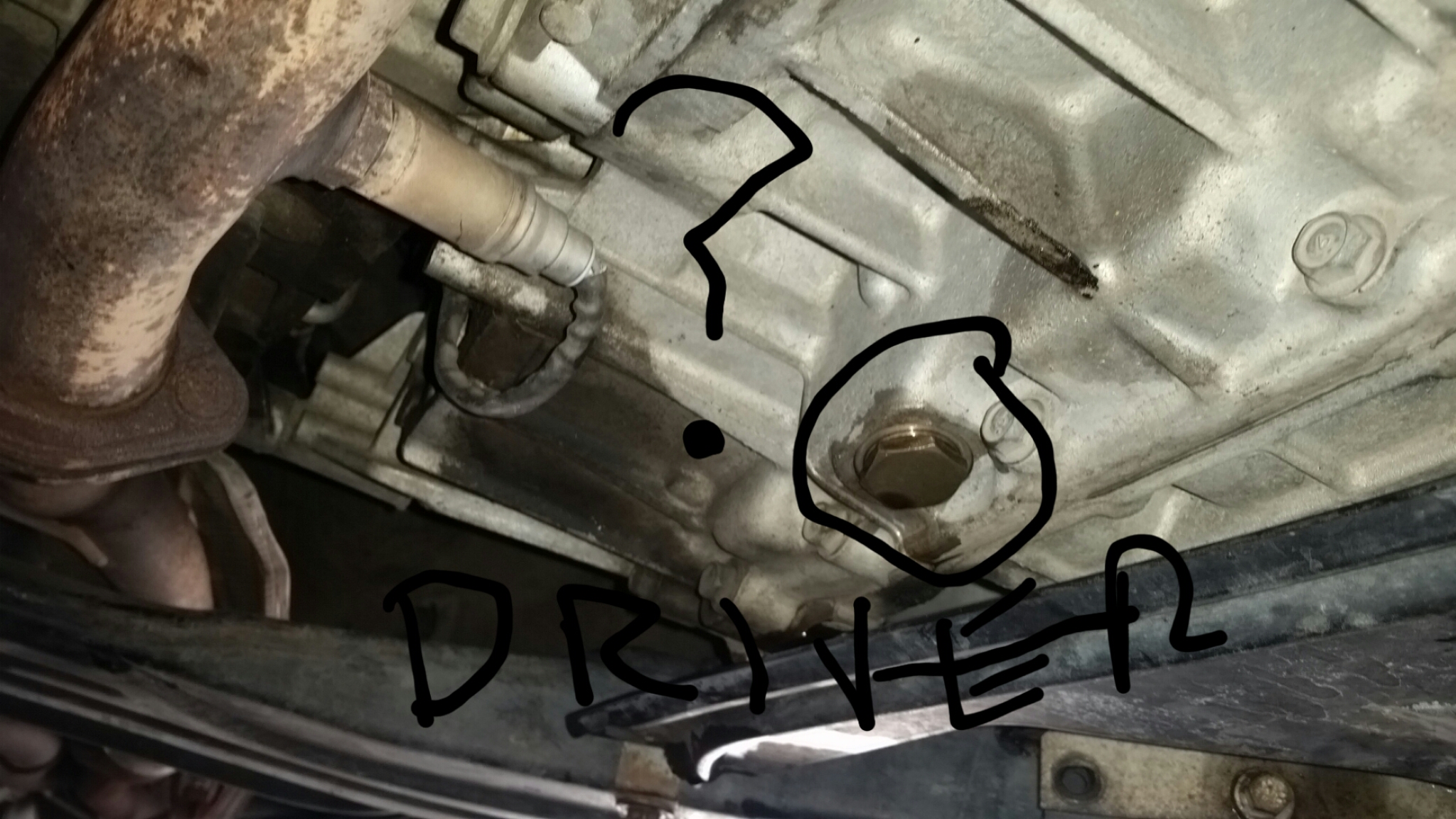

Is this the only place i need to fill? Im just wondering how that fluid reaches the axle on the drivers side. On the drivers side there is a 24mm drain plug. I opened it briefly, and fluid drained. I believe this is transmission fluid? Its the photo with the ?. What fluid is this?
Ive attached photos, all taken looking back from the front bumper.
