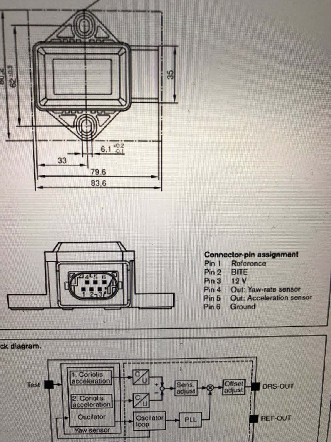

Now I have disassembled basicly the whole interior just to find out that there are perfectly looking connections on the YAW sensor, also the measurements are looking good.
Next thing is to remove the SAS (steering angle sensor) and see if thats where the problem is.
One more layer to go berfore I find the YAW sensor...
YAW sensor connector
Searched a long time for this YAW sensor PINOUT.
