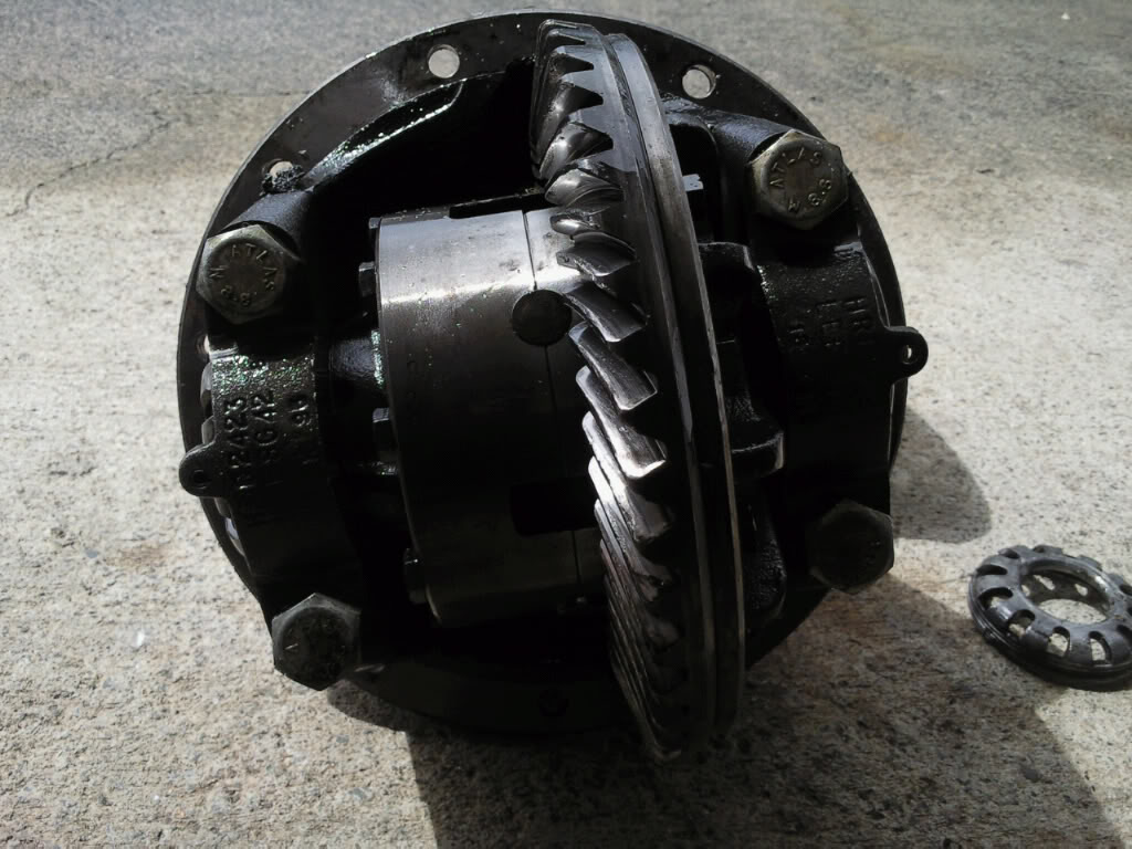

i got the differential out today! got some pics.

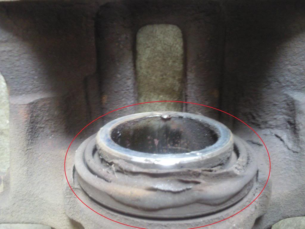

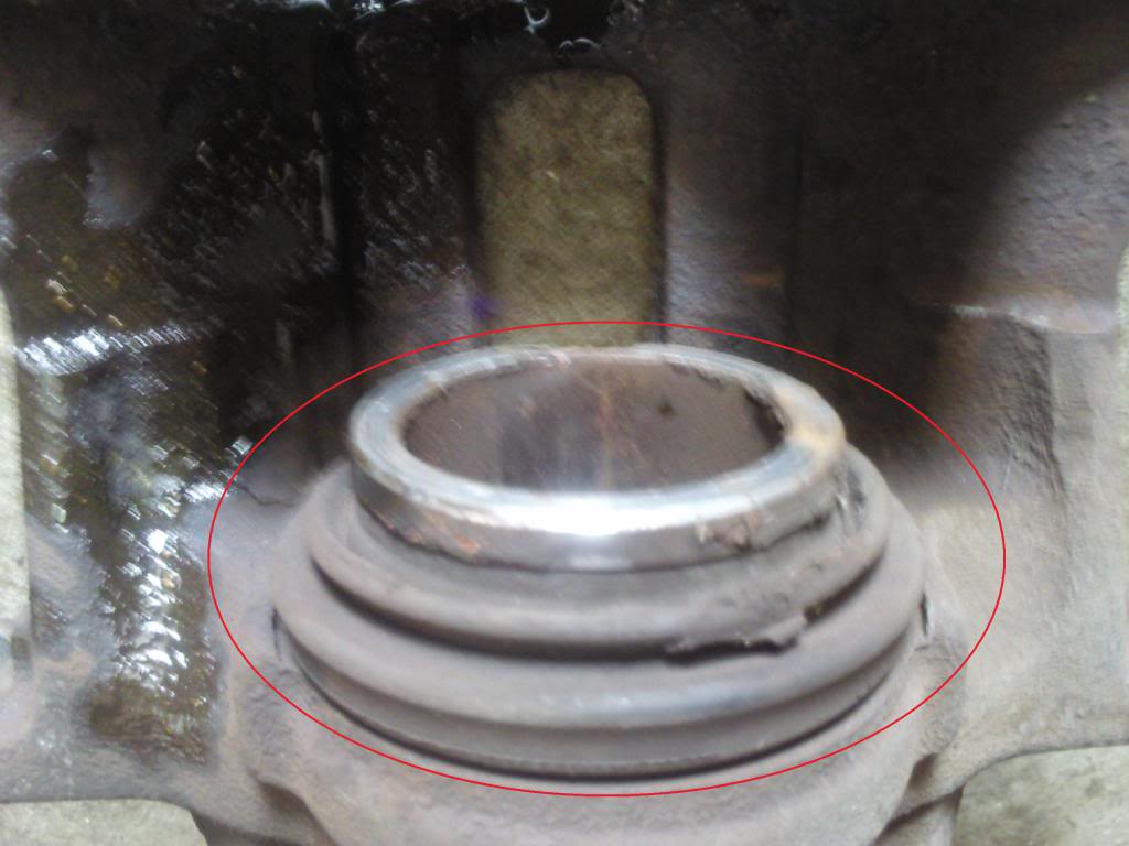

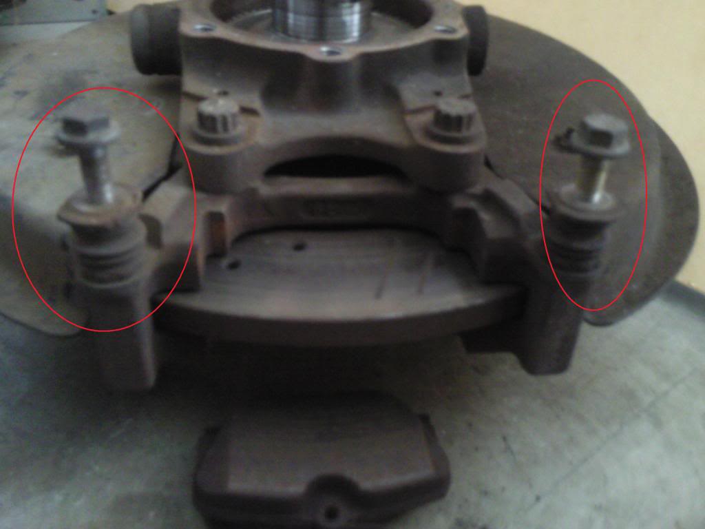

could you guys take a look at these boots on my calipers and calipers mounts and let me know if they need changing. if so where could i get a good set for a good price or rebuild them. thanks!

OUCH. Your differential is going to need to be replaced... Replacing the rest of the axle might be in the cards like you said, but thats up to you. As for the caliper guides and bolts, those usually need to be replaced every time you take them off (I re-used mine SHHHHHH) If they slide nicely and the bolts aren't rounded off, you can probably reuse them. As for the piston boot... that looks like it needs to be replaced very quickly. Check out www.roverparts.com for the parts and pricing.

Well yes, that diff is toast. I checked roverland parts and they have the differential you need for $650. Or you can guy the whole axle for $850. I know that my local wrecking yard has an axle in there that I could check the pricing for you of you would like. It is the shipping that will still get you, if you can get just the diff it would be a lot less than the axle. If you did the axle though it should come with the brakes and everything else on it.

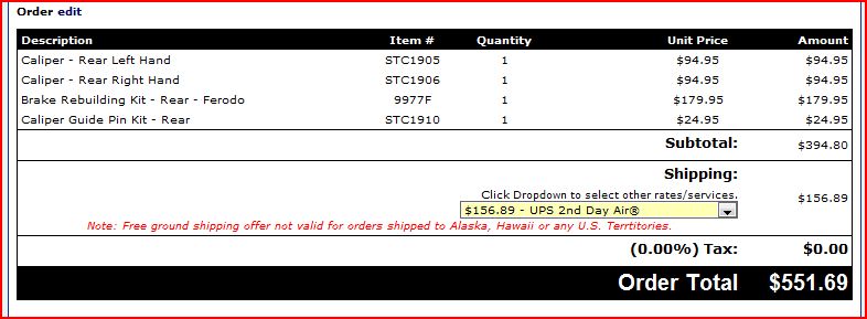

heys guys this is my check out page at roverland parts you guys think this is a good deal?
