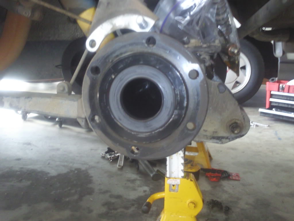

i'm in the process of sliding out the rear axles to take the diff out and check it. what's the best way to take off the axles i.e first the brake lines then the sensor. thanks!
Old Feb 12, 2010 | 03:59 PM
middleman496's Avatar
Joined: Dec 2009
Posts: 58
From: Hawaii
okay well i got the right axle out. i loosened the brake line screw to the caliper, loosened the brake line bracket on the hub, took out the sensor, then took the rest of the hub screws off. hub and axle just slid right out no problem

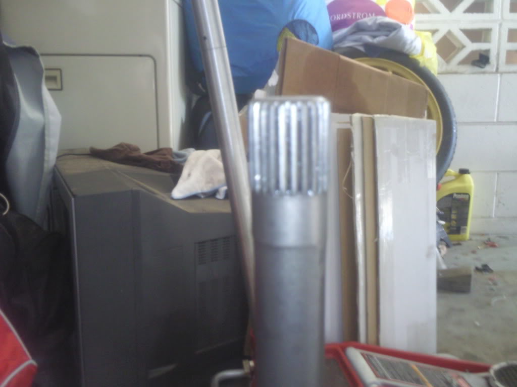

Old Feb 13, 2010 | 01:08 PM
Joined: Dec 2009
Posts: 58
From: Hawaii
so that's my current progress right now the axles splines are still good, need to rebuild my calipers get new rotors and pads even though they have a lot of meat on them but are scored. my delima right now is the diff. will not i repeat will not come out of the housing ><. any suggestions? any suggestions to take out a stuck filler drain screw?

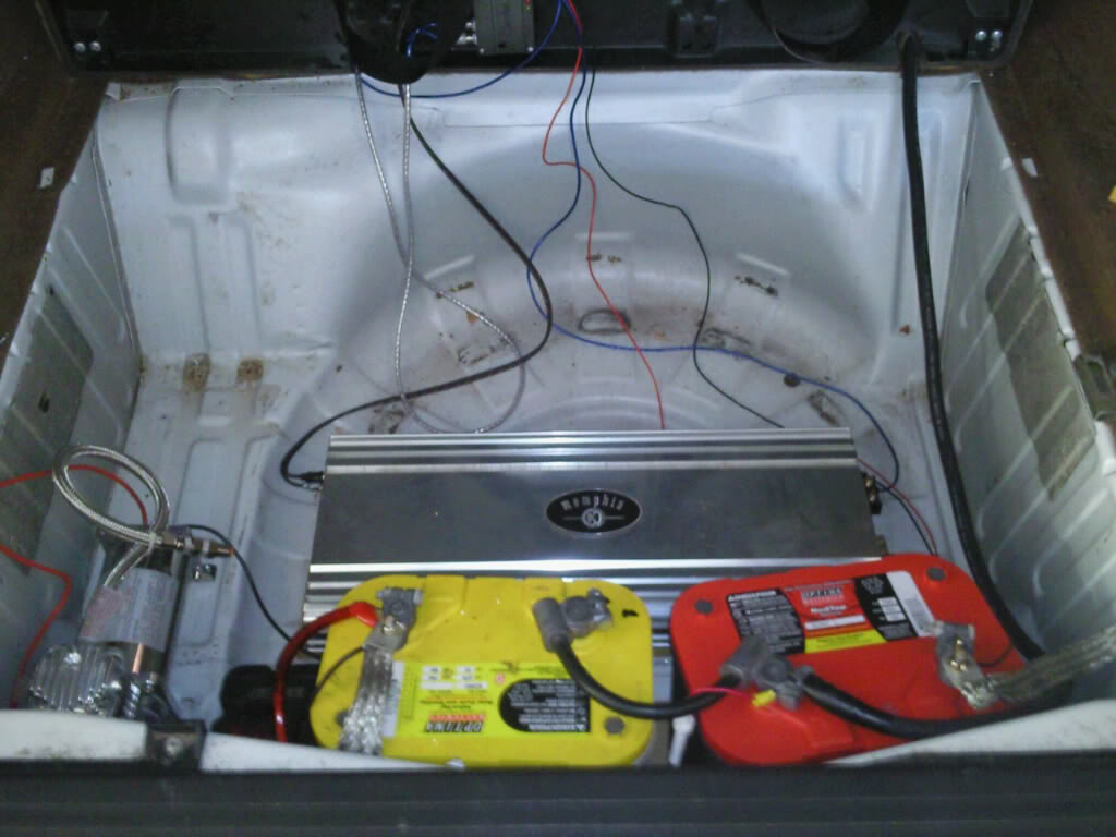

was loading my trunk with goodies before my diff broke here's a pic
