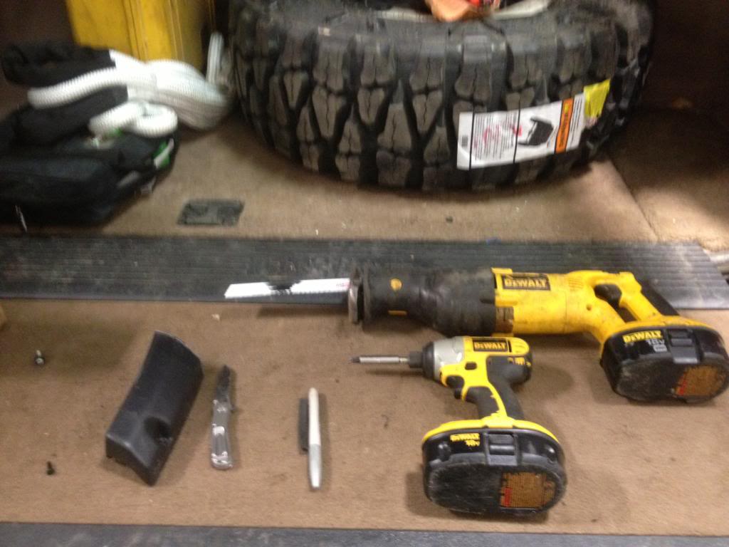

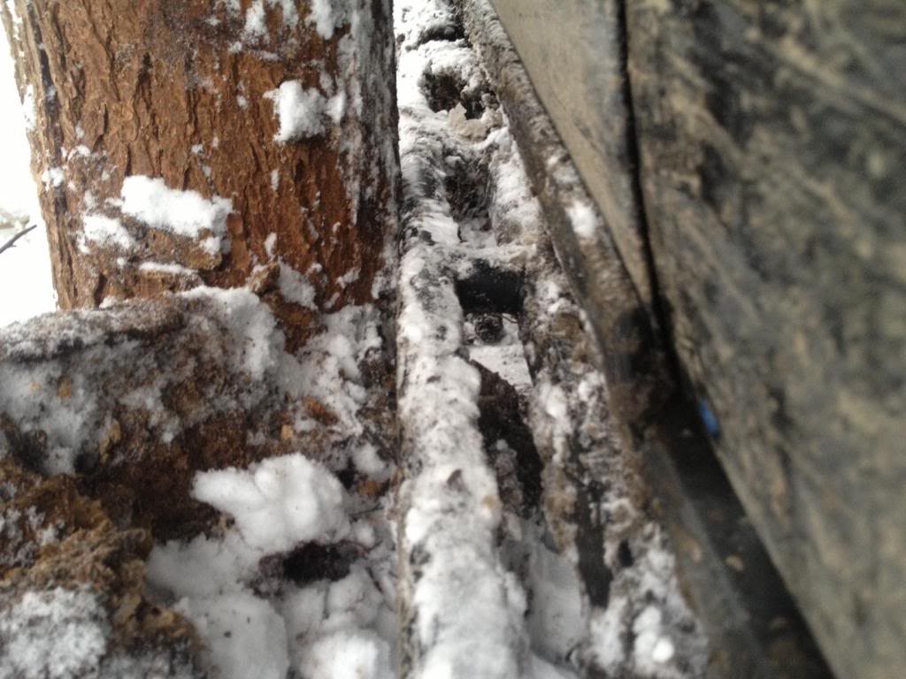

Project update

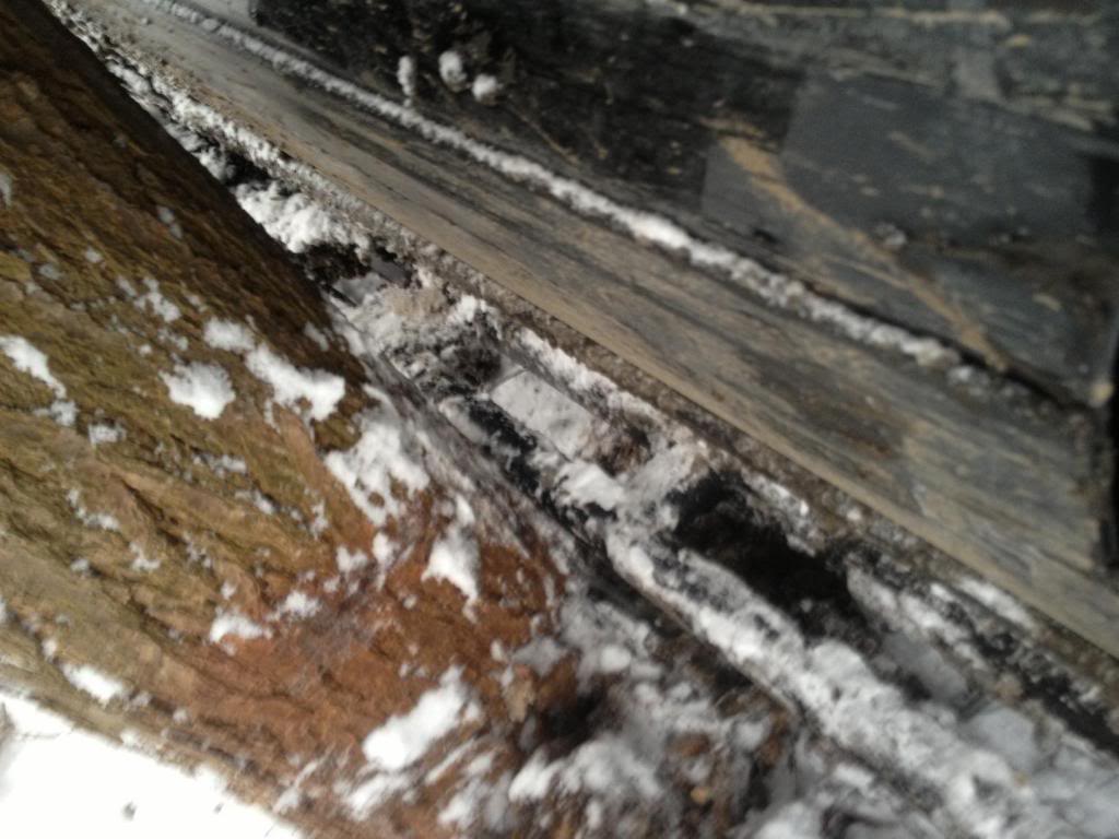

The sliders have been trimmed to fit with the fender flares. Hooray we can now turn with out rubbing! When the snow clears out I'll take some good pictures but for now I have trail shots.
The tree bars were true to their name and I needed to use them often in the tight wooded area.

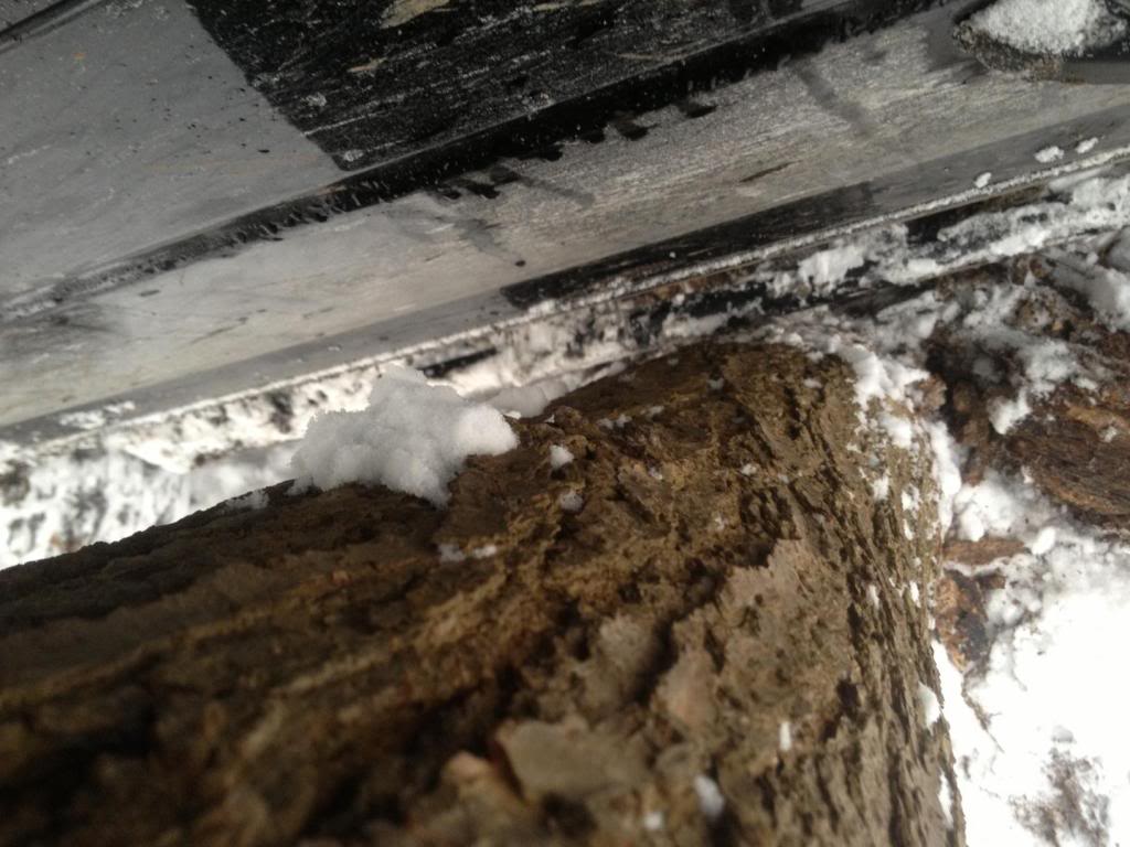

As you can see in this picture the tree bar portion on the slider sticks out just far enough to keep the door skins safe from damage.

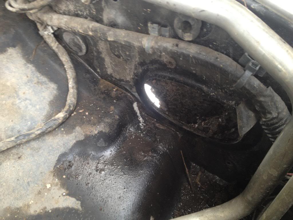

Project update : MUD in all the wrong places

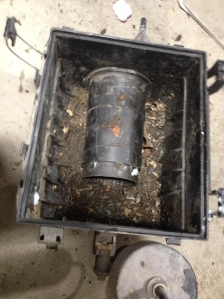

Prepping for the next event we went through the truck a little bit and upon opening the air box we found this.
The airbox draws air from inside the front fender. But obviously that is not enough to protect it from the goop we are sticking the truck in.
We took the snorkel type section off the air box that connected it to the fender. The Air intake will now draw fresh air from inside the engine bay. To help protect the air box from dirt we covered the hole in the fender with this extra piece of plastic we found laying around.

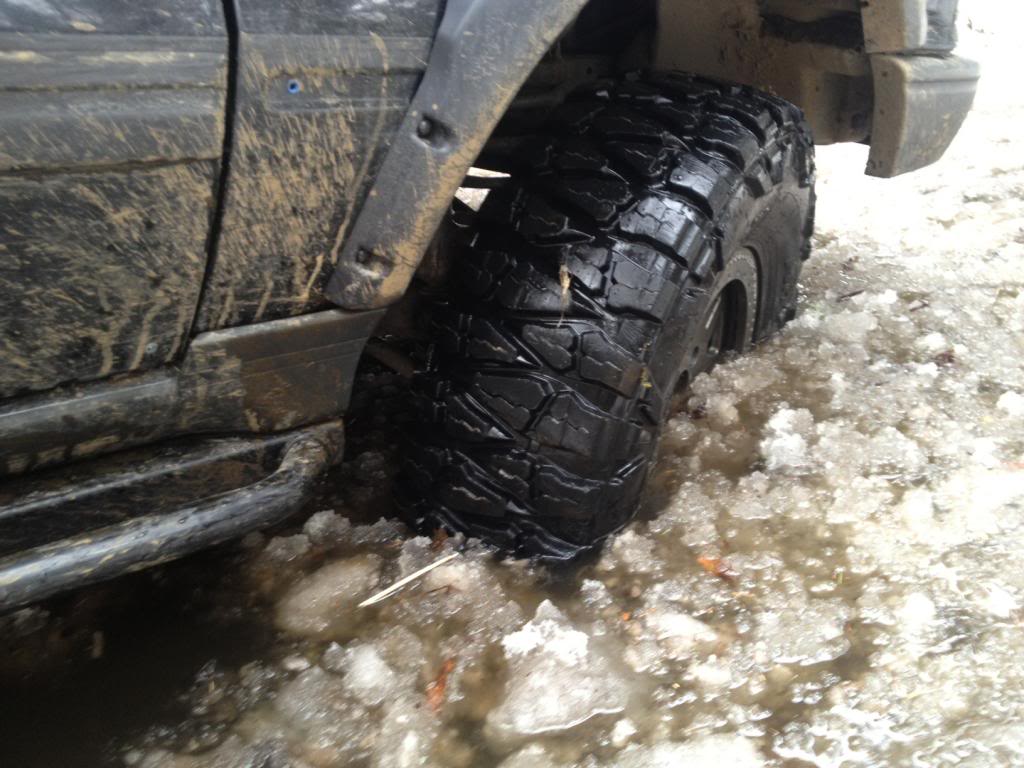

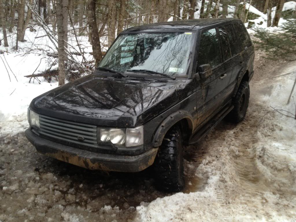

Project update : Snow problem
The conditions at Winter Romp were crazy slippery, even for Maine in February. I tried airing down to 15psi to get more traction. The snow and ice just laughed, so I let the pressure down to 8psi and that was the magic number for the Nittos. This turned into a good test for the new Terrafirma rims. Whether it be on the trail or street the bead never came off the wheels.
The P38 is the first Land Rover I was afraid to play in the water with. Every crossing was done only after I knew how deep the water was. Next week I am going to focus on doing something with the BECM and ECU.

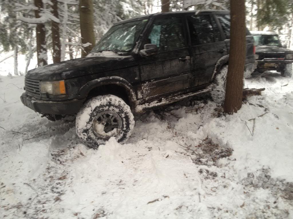

Unfortunately the Winter Romp was not kind to the P38s Fender flares. The tight trails and low hanging tree branches were like driving through the living forest of Middle Earth and someone told the trees that each flare was a Ring of Power.
We will have to get the heat gun out and bend the flare back into shape but with out them we could not stuff the 33s like this.

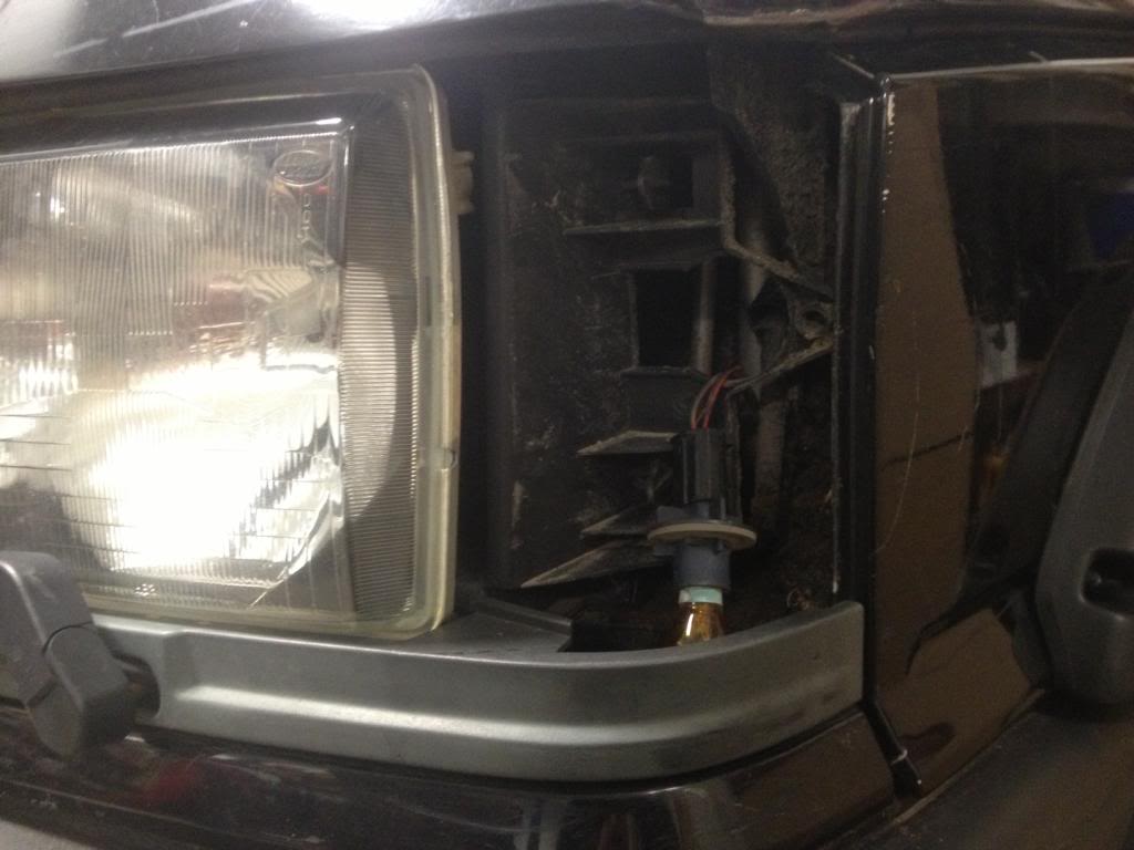

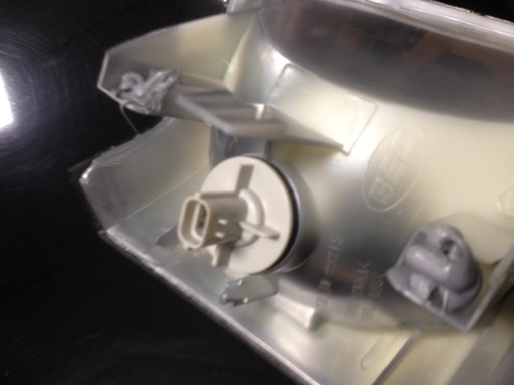

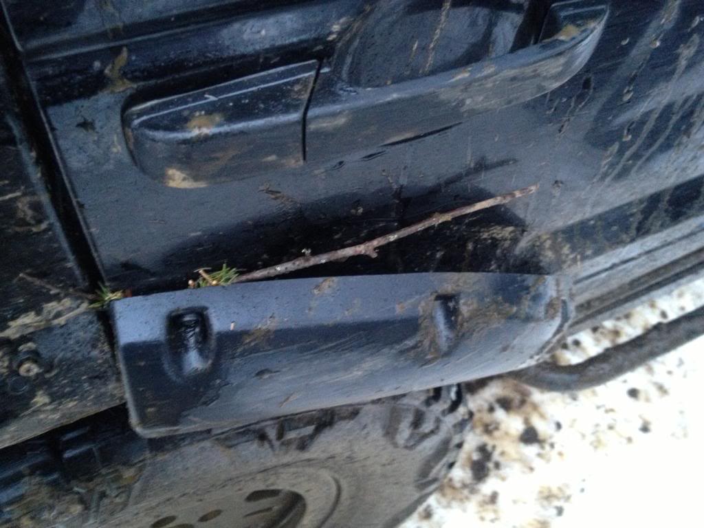

Almost every time we use the P38 a front side marker light goes missing. I don't know if the mounting tabs have gone bad on the truck or that we sometimes use trees and rocks as a brake supplement.
We filled the mounting holes on the lights with RTV in hopes of keeping them in place.

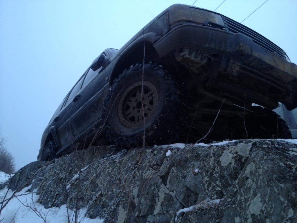

They did not fall out on this little rock pile, I hope it is a good omen.

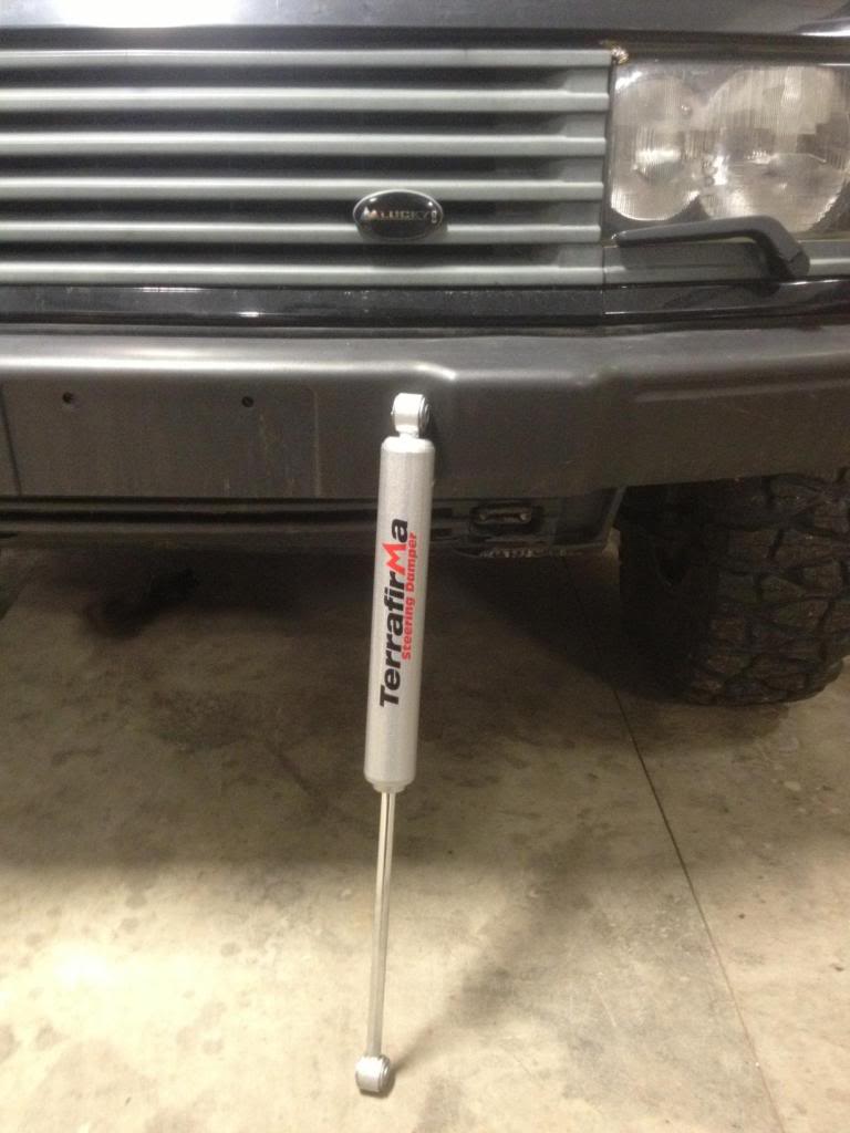

The Terrafirma steering damper came in for testing.

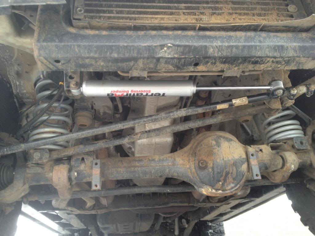

I took the P38 down a 55mph ruff country road and the damper kept the 33in Nitto's under control and tracking straight.

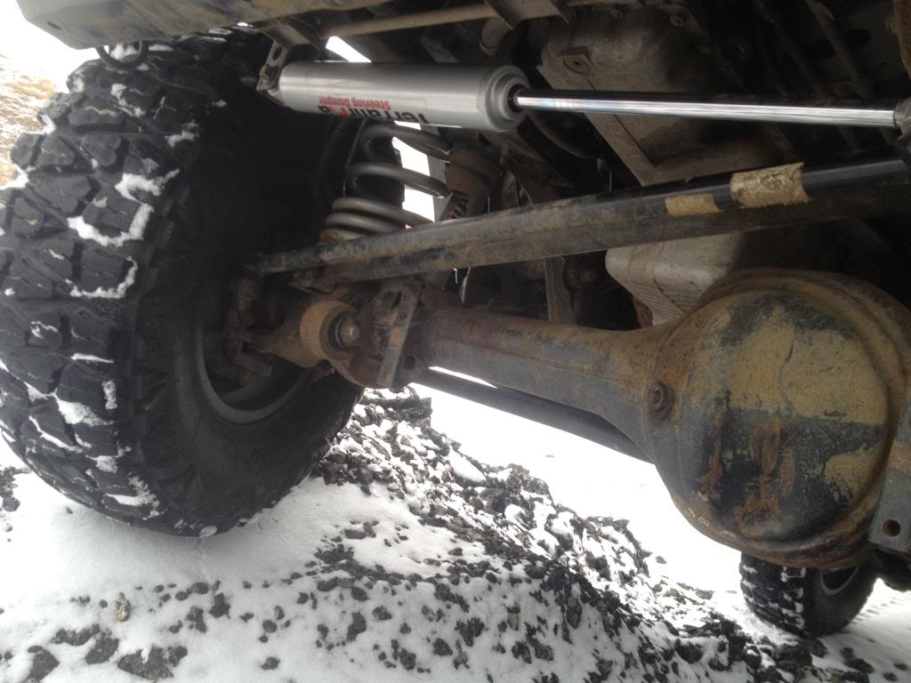

As expected the damper did great off road as well.

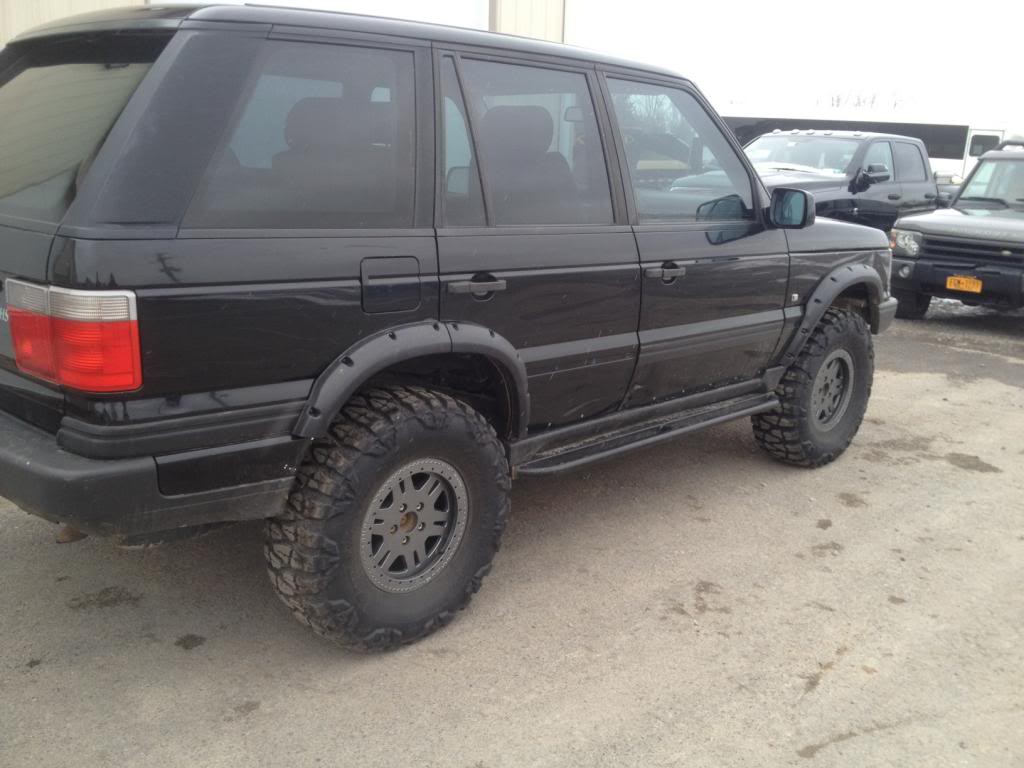

After seeing the prototype for the rear bumper we could make the final adjustments needed to the fender flares.
With the way the flares line up on the P38 it is hard to tell we cut them or that they were originally for a Disco 2.
