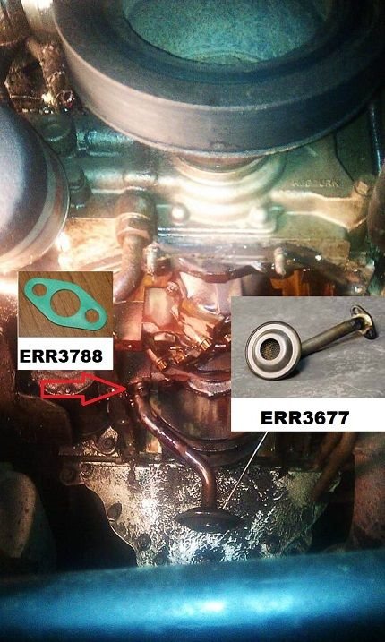

IMHO, now a 20W50 in The PNW is too thick. I'd run a Castrol GTX 10W40 or 15W40 all day and make that 3.9 very happy.
+1 on testing with an oil pressure gauge. And if you are going to drop the oil pan to have a look REMEMBER to remove and clean the Oil Pickup Tube and Screen.
