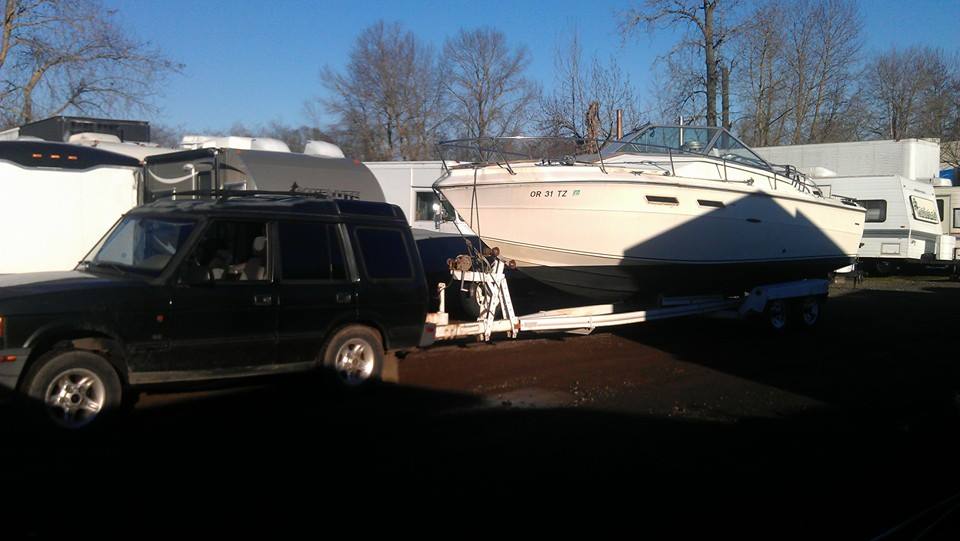

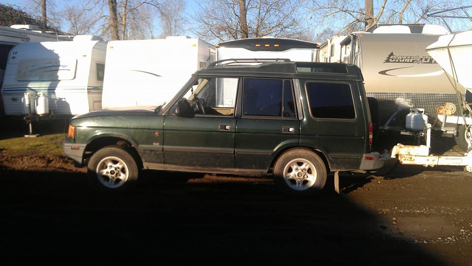

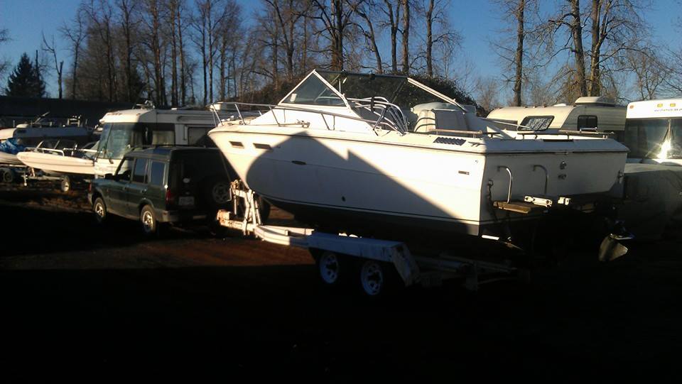

towing bosses boat back from marina. not a problem on the whole trip. about 20 miles
