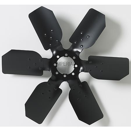

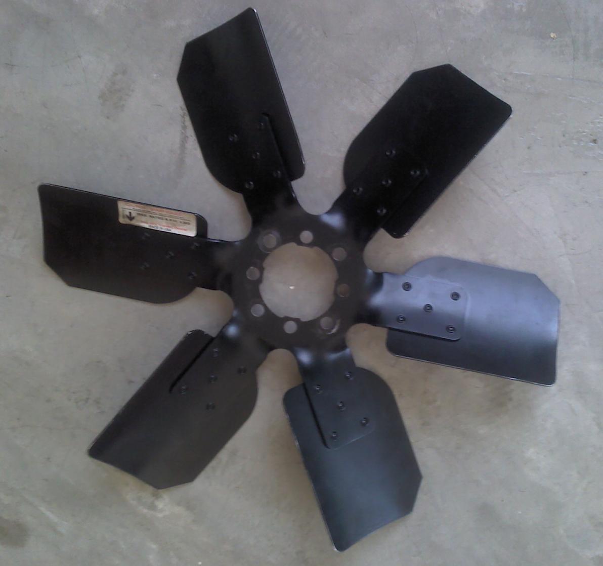

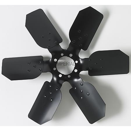

pic one: imperial fan
pic two: imperial fan (reverse)
pic three: my fan
so it looks like I have the wrong fan and the wrong direction. fyi...belt was put on by local indy Rover shop. i'm going to check belt routing today as fan was definitely moving counter clockwise facing engine.

Local Indy Rover guy swears fan should move counterclockwise looking at front of truck, like it is currently.
Please confirm this is incorrect or correct??

Old Sep 15, 2011 | 10:27 AM
  #90
Posts: 16,322
From: Savannah Georgia
Then it is spinning the correct way, facing engine, soinning to your left. In the tech sticky area of the D1 part of the forum is a link to belt route. I suggest people print it out, cut out the drawing, and tape it with clear shipping tape to the fan cowl, or somewhere.
