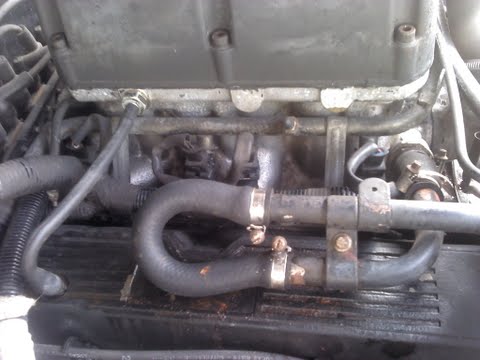

OK, we rerouted the heater hose...did we get it right?
Rad is at the shop getting rodded.
As soon as I get it back, I'll put the right green coolant mix w/ watter wetter...say a little prayer to those gods you speak of and get it on the road.

Hose looks good. I was surprised at how much water goes thru there. BTW how much to get rad rodded out on your island paradise?

By the way, we cut the J hose from the PEP Boys like antichrist did. But we'll be keeping it there instead of fixing the heater..unless someone tells me otherwise.
