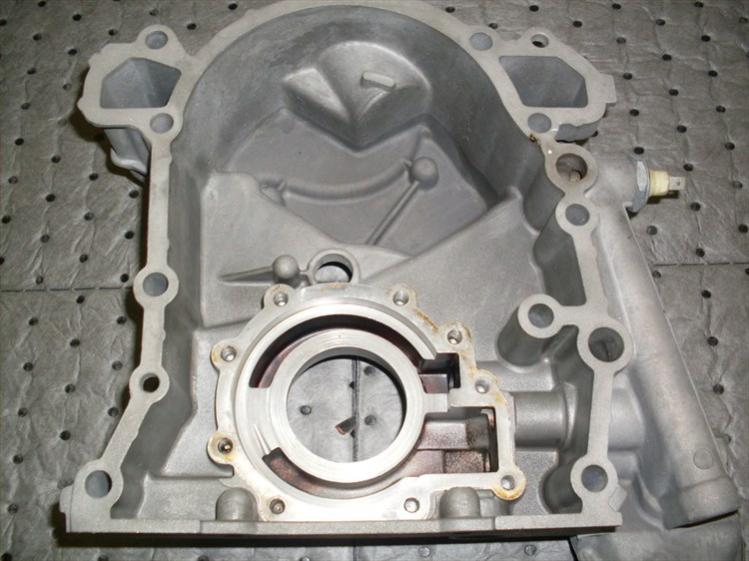

Here's pix of the back side, the oil pump is in there, so oil pressure "starts" in the front cover. Water pump flow is thru the two big "ears" at the top. Note oil pressure switch on the side.

Thanks for the answers! I did know that oil pump was in the front cover and of course that the coolant ran through it.
What was a bit baffling for me is how it would leak oil at the top above the coolant ears, as that area should only ever see splash lubrication at most. Almost as strange is why it would leak at the manifold corners, as even that area should only see splash lubrication as well right?
It makes sense the lower edge of the valve covers would leak, they are flooded in oil from rocker oil, but the top of the timing cover or the corner of the manifold makes no more sense to me than the upper edge of the valve cover gasket?
Of course, leaking at the oil pressure switch makes sense because it is under pressure.
BTW, strangely enough, front crank seal is not leaking, appears to only be leaking from very top of the engine - do the head gaskets ever leak oil?
Just wondering about the root cause of it all.
