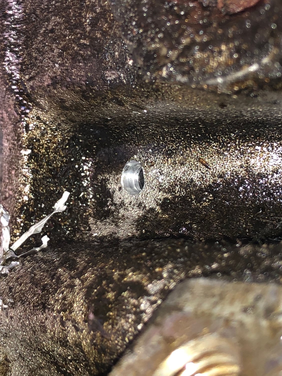

I pinned two of the cylinders today. Have videos and pictures and will do a before and after.
Cylinder wall of completed threading
Installed with threaded stud in

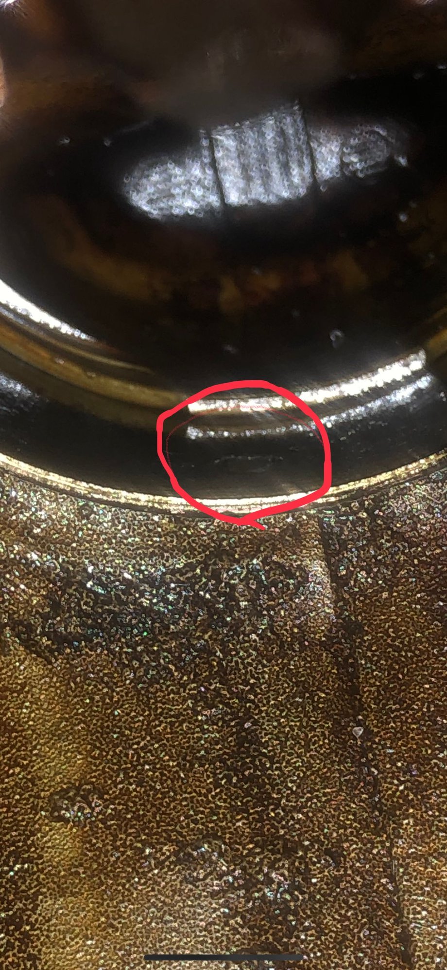

Finished up today and truck runs great. I did nothing other than the pinning and it worked out well for me. Truck runs smooth.
View from inside the cylinder
You can see the thickness of block and liner here
One of the 8 pinned cylinders
