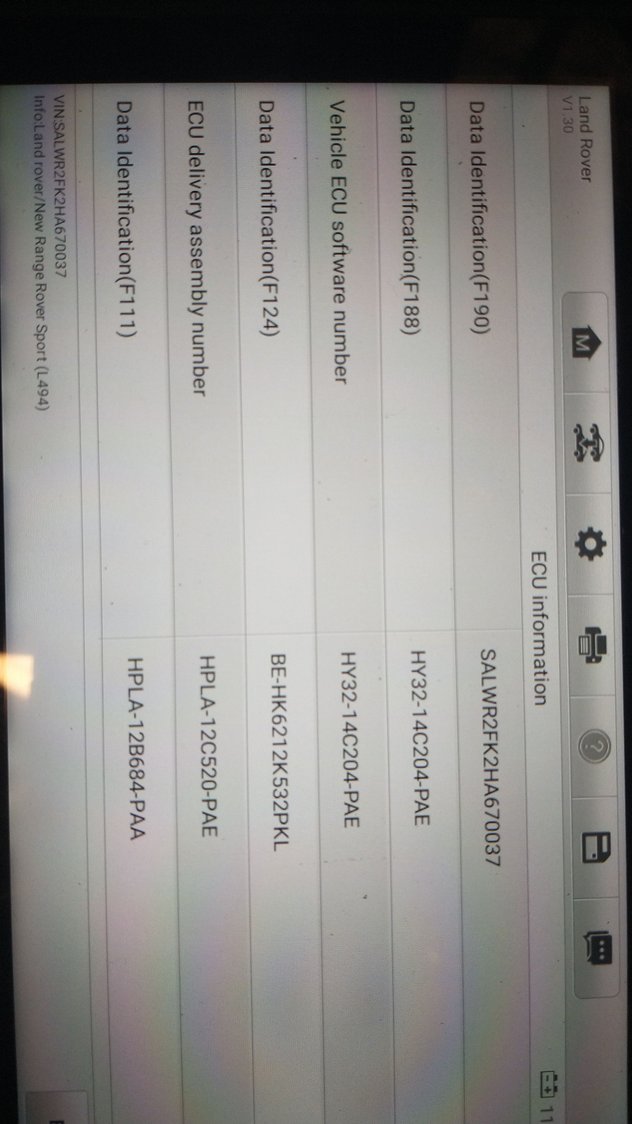

Thank you so much for replying back!!! It took about 120mi before the code returned. But.... When I cleared it the first time I had only cleaned the injector and injector inlet. Yesterday I cleaned everything again but also drained the def tank and poured in 2.5gal of blue def platinum. I used this prior to this code as well. The iso is 22241 and it's the same rating as adblue so I'd figure it's comparable.
I'm trying to nail down the whole PCM flash that fixed this. I'm afraid a recent key fob addition has reverted the original files on the PCM. My dealer mentioned having to flash the PCM when they added the fob. I'll post a pic of my current PCM version. Is there anyway you can look at your version?
Ty again so very much for replying and assisting!
Actually I don’t have a reading of my PCM. I didn’t have a way of getting it without taking to dealer. Which I only do if I absolutely have to. I don’t personally own a scanner. However what you are saying could absolutely be correct. If the flash your PCM for a new fob it could have reverted back to the original program. Several have said they had a software update done by the dealer that did away with the def quality code. I bought my Land Rover used at 35,000 miles so I’m not sure if it was updated before I bought it. I personally have not had it updated. I think the update simply makes it less sensitive to the def quality error code. I will add that many have said when they switched to the blue def PLATINUM their issues started with the def quality code error. I use Blue Def but not the platinum brand. I personally don’t think it would matter but just wanted to throw that in there. Def will go bad if not stored correctly or inventory is rotated properly. I do know that for certain.
