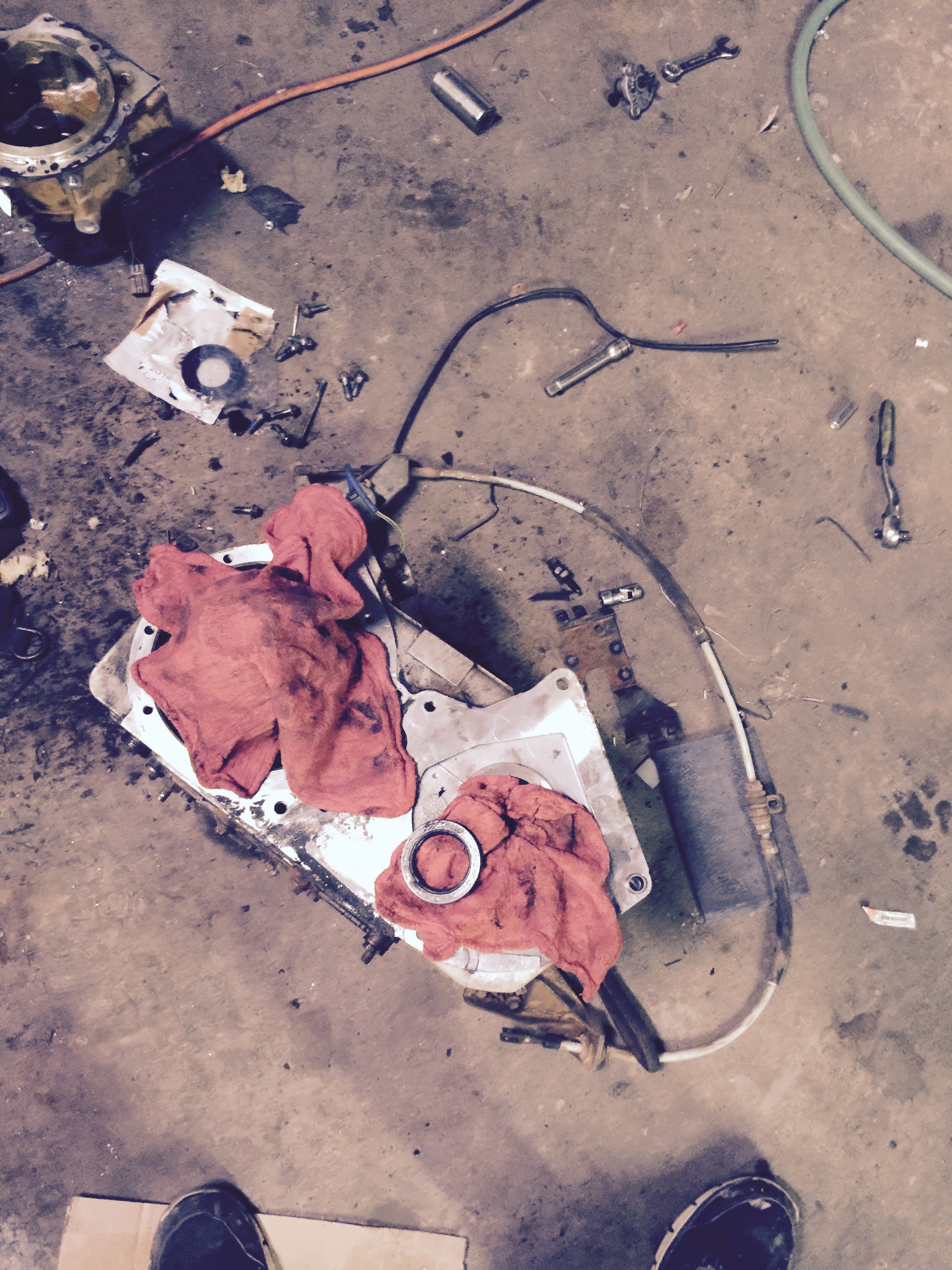

I am in the process of rebuilding a transfer case. Well mostly just re sealing it, as most of the bearings were in pretty good shape. My question is how do I circumvent the locking part, that makes my computer throw my three amigos on if I turn the engine off while the CDL is lock? In this situation I have to unlock the CDL and when it is a disengaged I can then turn my engine off and back on my three amigos are gone . I know there's an easy snip a wire method, Or some technically advanced method , I just don't know what I'm snipping or unplugging.
I assume it's one of these two harnesses but what what?
Attached Thumbnails Lt230 & 3amigos, if engine is shut off while locked.-image.jpg

Here is one with the wires

Thanks. Looks like blue black are the information senders
