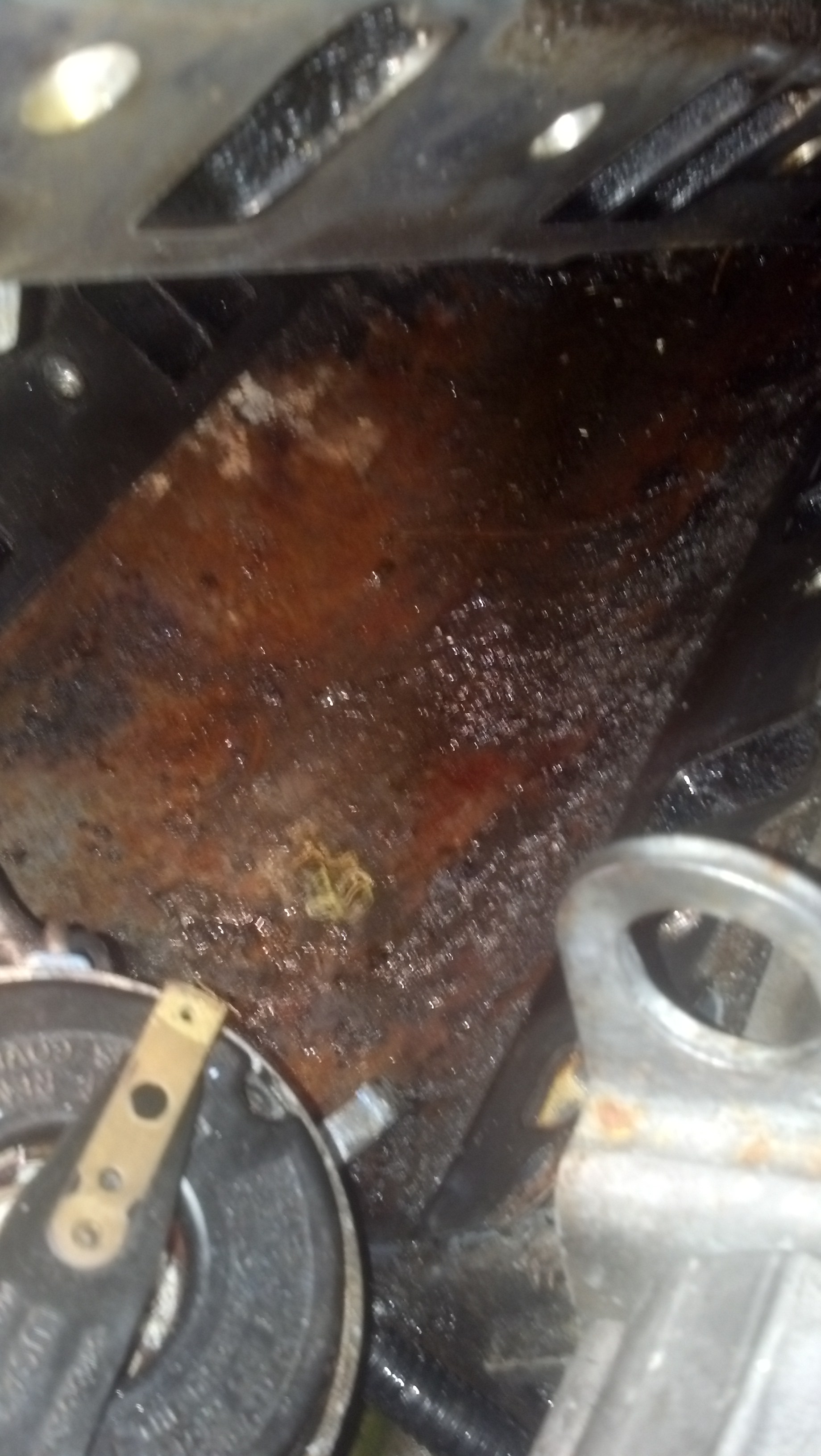

Well....the intake manifold will be coming off. A hose clamp I was compressing on the fuel line just popped off and dropped down one of the trumpet horns! F#(&)^#%*A#%&^.

ihScout..is the lifter your talking about the third or fifth from the RIGHT? They both look round to me..
Old Nov 16, 2015 | 01:43 PM
  #30
Roverfanatic's Avatar
Joined: Aug 2015
Posts: 272
From: Texas
F&^%&*
Here is the valley pan before I removed it..My lifters are noisy only when accelerating-img_20151116_133731_472-1-.jpg
