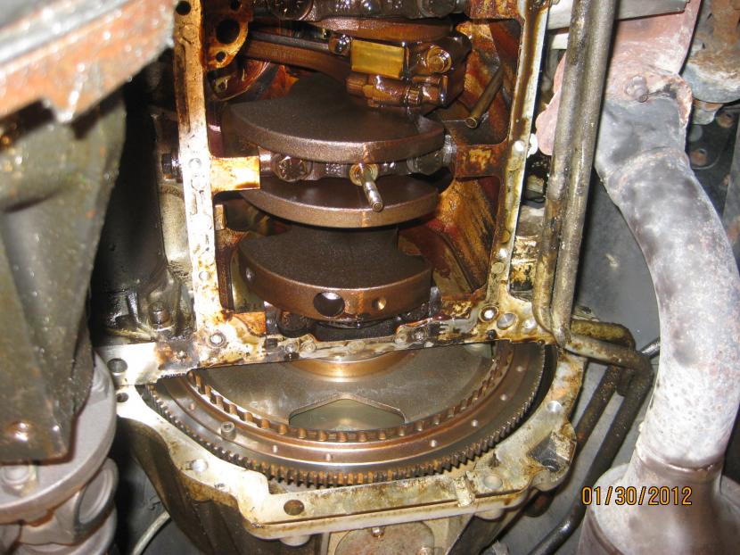

The most common cause of this repeating dies- won't restart-cools down- starts normal-no codes is the crank position sensor. This device is mounted on the back of the engine on the driver's side. It is a magnetic pickup that generates pulses as the flywheel rotates, to tell the ECU how fast the engine is turning and when to supply sparks. About a $70 - $90 part. IF DIY, pay attention to spacers when removed and going back together, and plug in sensor before trying to mount the new one. Not a lot of space to work in. Here's some pages from the RAVE manual for you (and your mechanic). Pix is of the slotted ring on the front side of the flywheel that the sensor reads as those gaps fly by about 2 mm away. Flywheel has those gear teeth on the outer edge, the starter engages those. The inner ring with machined gaps is what is driving the crank position sensor. Spacing is critical, and many replacements don't work if spacers are put on kattywhompus.
One way to get out of the disabled vehicle problem is to pour cold water over the sensor, to speed up cooling off. A shade tree test to confirm this is the problem is to have a spare spark plug, when it happens, remove a plug wire, attach plug, lay on manifold, and crank. If no sparks, that confirms it.
