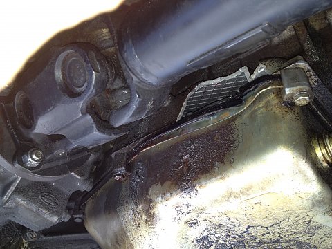

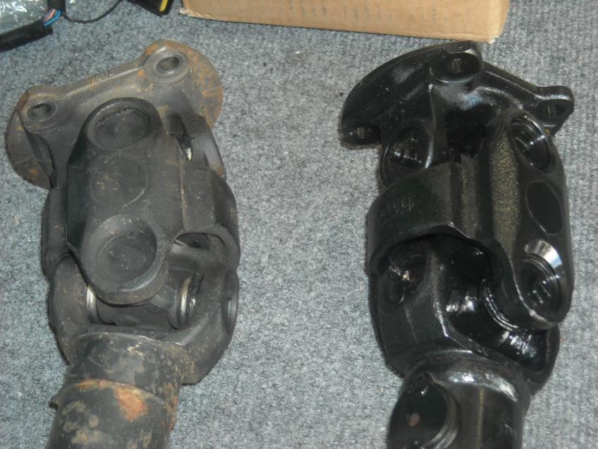

Welcome. Shop manual set is called the RAVE, a free download link below.
1. Front drive shaft will have a double end, oem had no grease fittings, when they dry out, it snaps and bashes a hole in transmission. Rebuild shaft in advance or replace, and grease every oil change.
