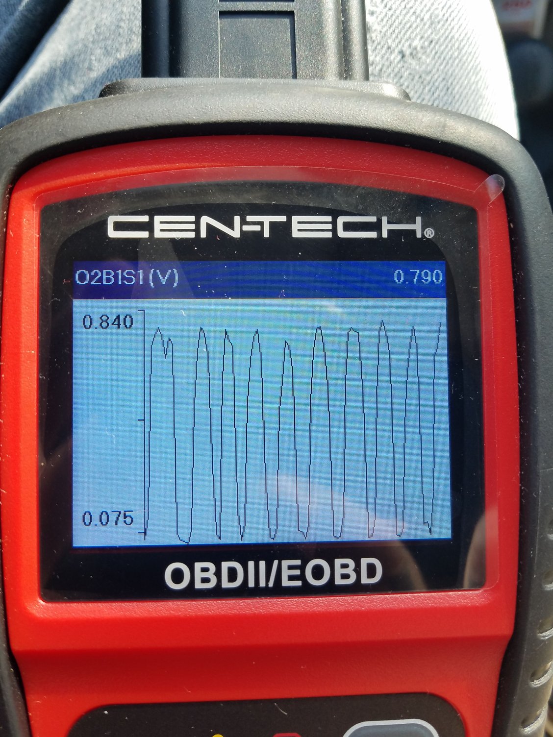

I have an 02 D2 SE with 163,000 miles, it's my daily driver. Just recently it threw a p0150 code. I bought some "el cheapo" set of 4 o2's and they set 4 new codes,needless to say I returned them and got 1 Bosch o2. The original code remains. I used a more advanced code reader and took photos of the o2 monitor, my problem is that I see that there is a problem,I don't know how to interpret the data lol. Any help would be greatly appreciated.

first let's figure out what we are looking at. O2B1S1 ..... "O2BxSy"
"O2" simply means O2 sensor
"Bx" B1=drivers side (bank 1) B2=passenger side (bank 2)
Sy - indicates if it is the upstream (pre- catalytic converter) sensor or downstream. S1=upstream S2=downstream (post-cat)
Your passenger side (bank 2) sensors are not reading. Could be a wiring issue (lack of connection) or could be dead sensors. I'd guess wiring to start.
Trace the wire from the upstream sensor on the passenger side back to ECU. You will go through at least one connections. (wiring diagram can be found in the link in my signature) Hopefully the break in the connection is obvious.
If that looks ok then I'd be checking grounds.
