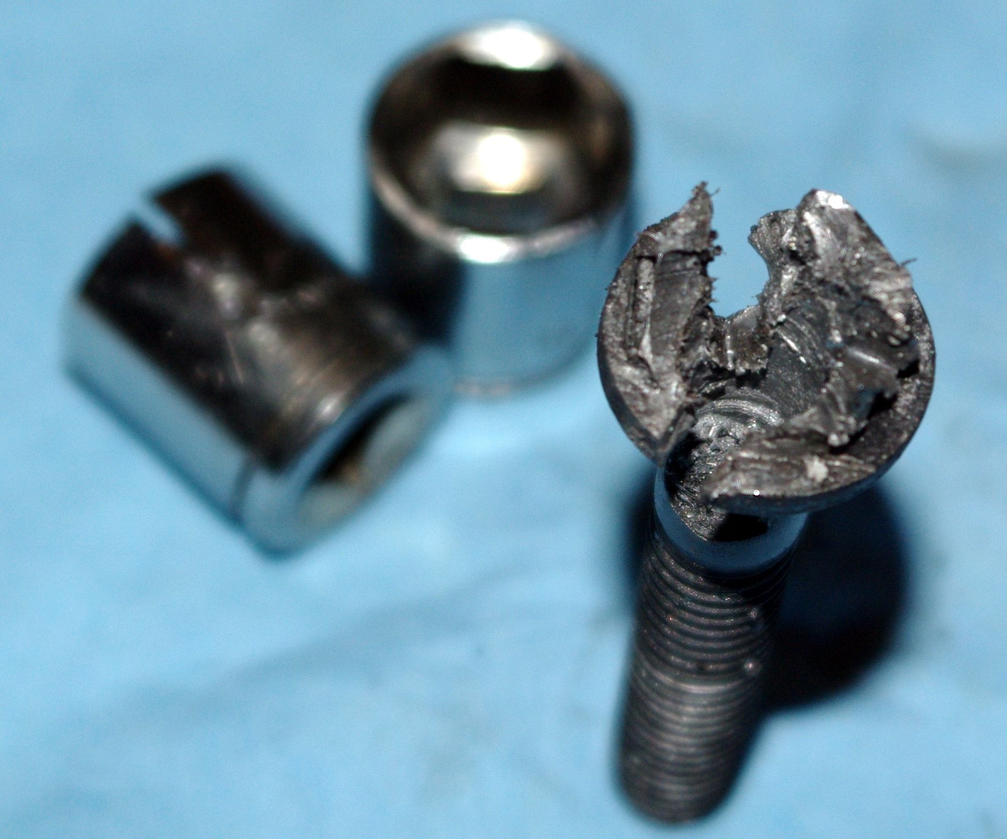

Well, I managed to get the bolt out, after much careful grinding and drilling and aiming with a narrow cold chisel.
The two sockets in the background are the ones that split when I was first trying to remove it, when the bolt was still mostly intact.
Damage to the head itself is minimal, thankfully.
