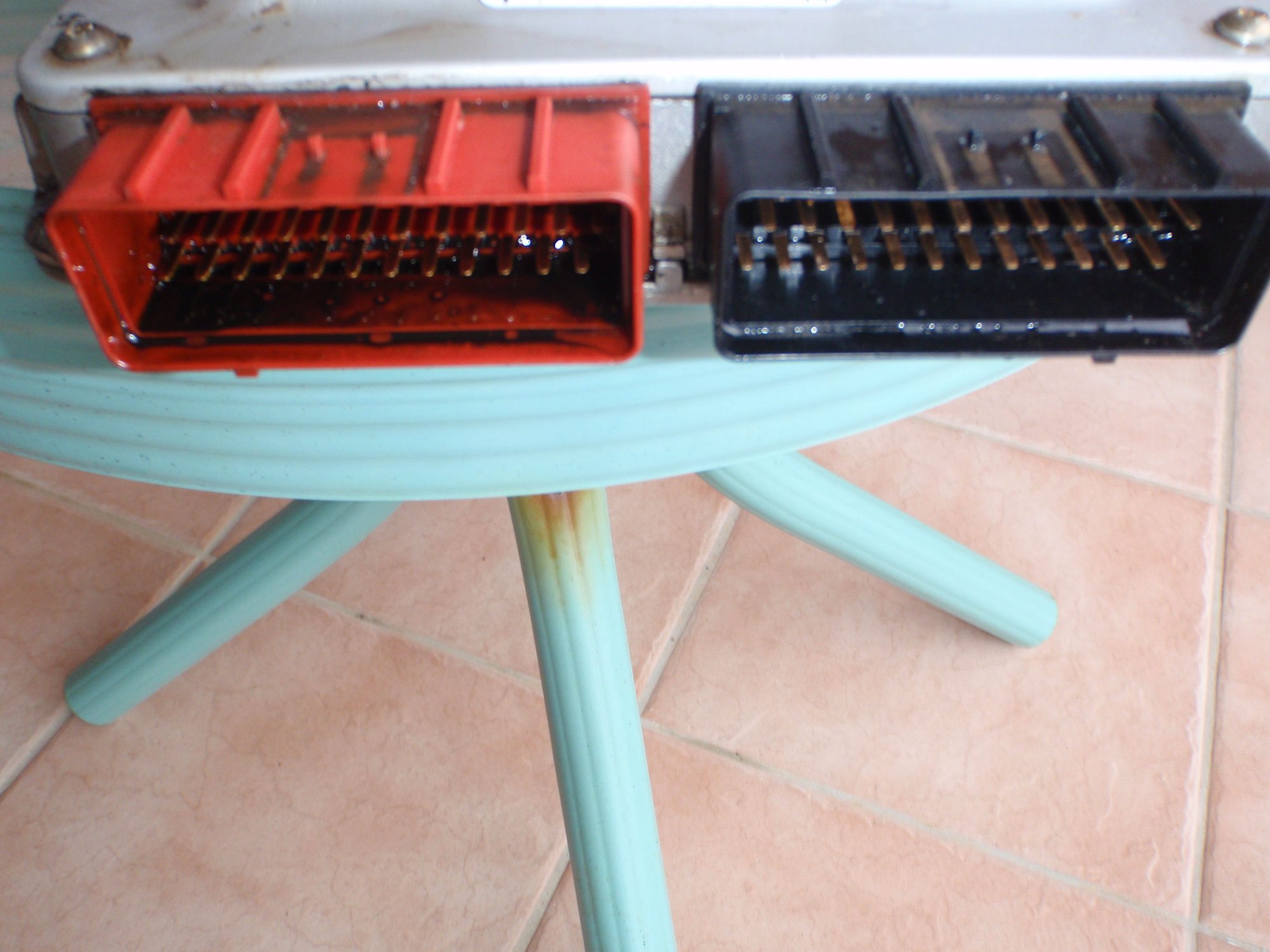

Default ecu red connector - engine oil contamination fix.
Only way I fixed mine was to get the wiring Diagram of the ECU you have to cut and solder each Injector lead, so the oil is stopped and just leaks out into the box under the passenger seat; it is just drops of oil. Tape over the solder leaving small opening for the drip.
see the tape on the leads .
