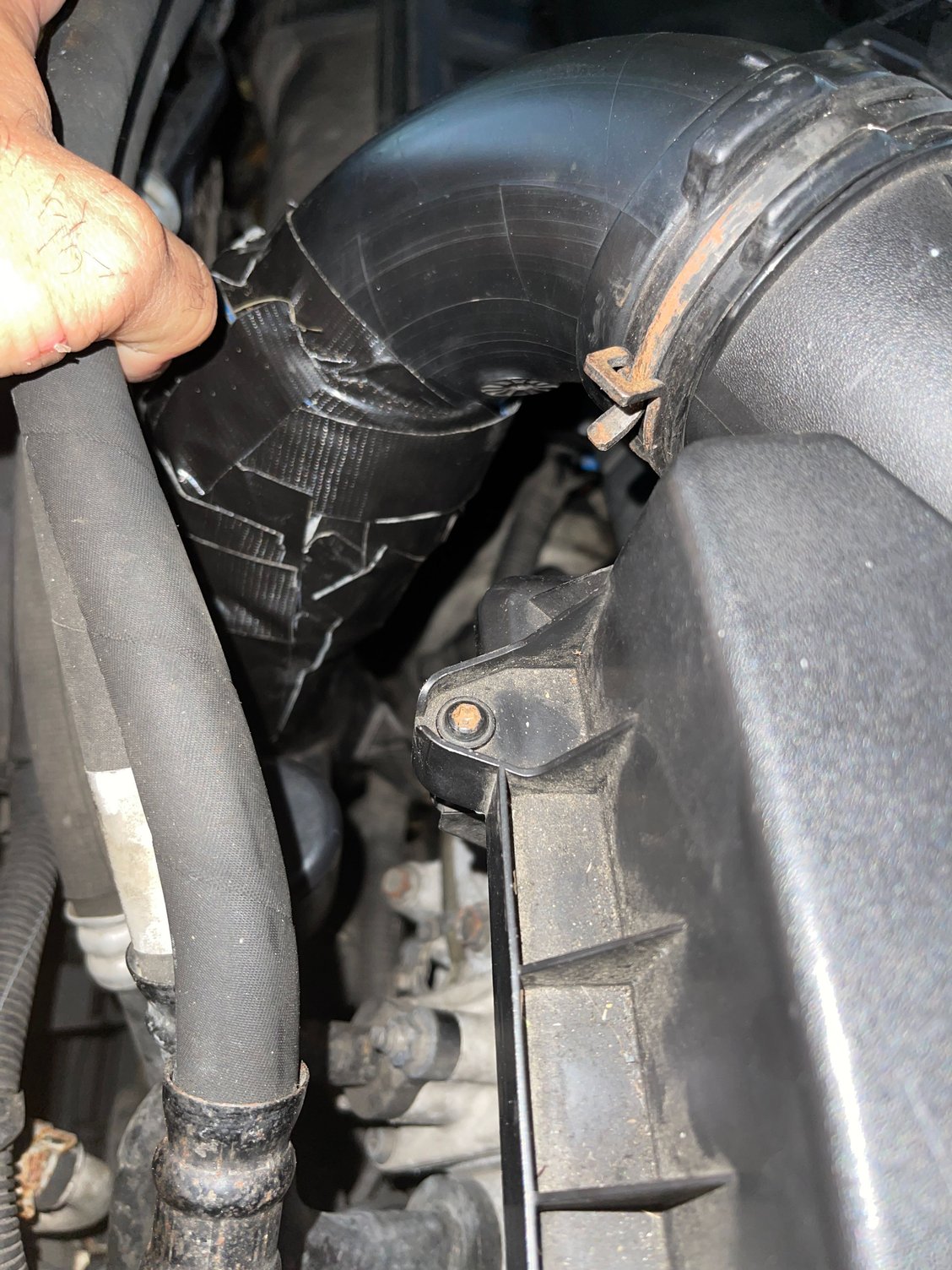

Hi, i found out that while removing the air filter someone used some kind of tape to fix the plastic hose coming from the intake , and i can see more tape on the plastic intake below near the bottom of the engine. Seems like a new plastic hose is needed from the intake and the air filter. Just a new finding! yayyy. I’m so happy , i’m going to have to remove the whole air intake to get down there, i try from below but was almost impossible. A picture !!!!
I wonder who was the last mechanical that worked with this?
