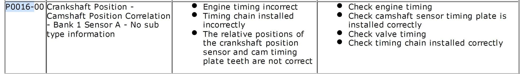

The service manual does not mention P2544. P0117 is low coolant (did the engine overheat?). P0134 is an O2 sensor code. P0341 is related to P0016 and the camshaft position sensor.
Did the mechanic explain to you WHY it needs a new engine, or did he just eyeball it for a few seconds and pull a diagnosis out of his ***?

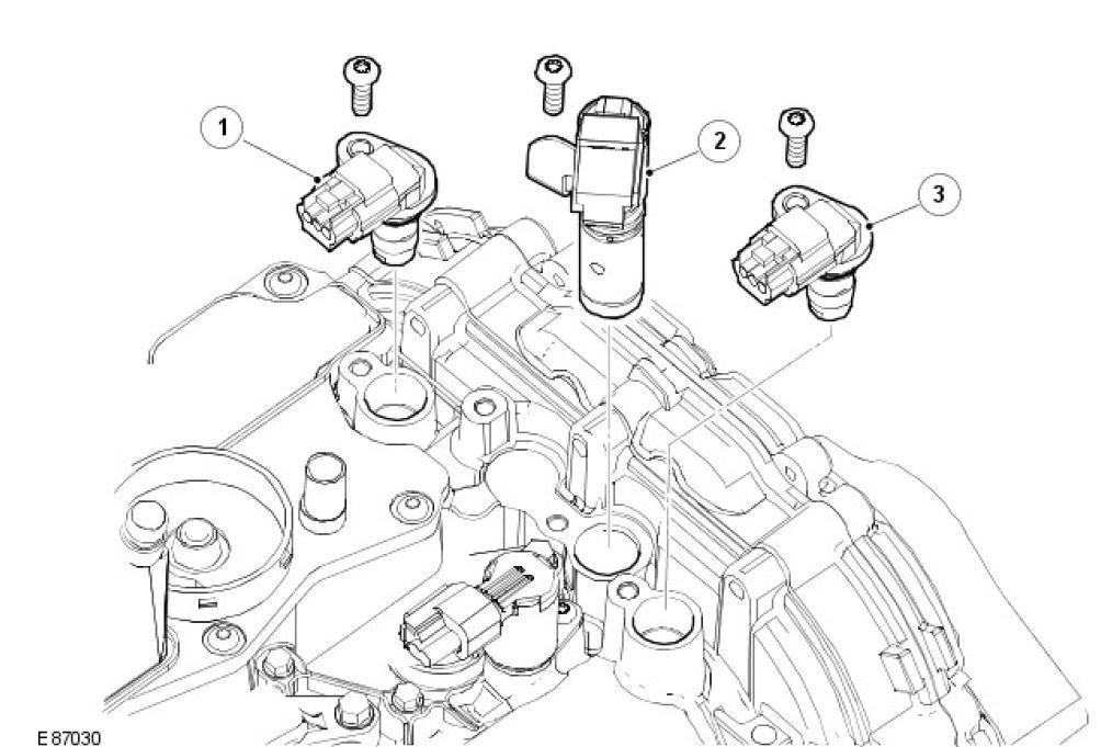

There are two camshaft position sensors on this engine, one for the intake camshaft and one for the exhaust camshaft. On the diagram below they are items 1 and 3.
One of them coiuld be bad, or the engine for some reason got out of timing. The 3.2l gas engine doesn't have a timing belt like the diesel engine, it only has a timing chain. If there is a problem with, it is not a huge job to change it, if the shop is competent. I would advise not giving up on this yet.
I thought we were talking about the ford turbo engine? That pic is the 3.2 i6.

If that's the case all my comments except to contact an independent mechanic in Puerto Rico are for naught.

Yes, merlinj79 is correct, it is a Ford turbo engine.
I checked by the VIN number and the engine is a 4-cyl Turbo 2.0 liter auto 6-spd cmdshft engine. When I googled that, it seems like this type of engine is part of the 4 cyl EcoTec engine family.
The direct quote from a website is "Beneath the 2014 LR2 hood is a fuel-efficient 2.0-liter turbocharged four-cylinder engine with high-pressure direct fuel injection and variable valve timing, lifted directly from the Range Rover Evoque. The four-cylinder turbo replaced the prior six-cylinder engine for 2013."
Unfortunately I do not have the service manual for LR2's past 2012. But my suggestion to contact an independent mechanic in Puerto Rico still stands. Even if you have to ship the car to them to get it fixed it's a heck oif a lot cheaper to do that than to ship it to Miami. Did you try finding one in St Thomas?
