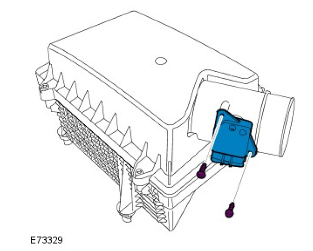

It looks like the IAT is combined with the Mass Air Flow (MAF) sensor. It's on the duct that is part of the air filter box They are available on Fleabay at reasonable prices because they are interchangeable between a whole bunch of US, Asia and European vehicles.

O.K. I know where that is. I had it off several times when I was initially cleaning the MAF sensor. I can get these sensors locally for under a $100 CDN.
