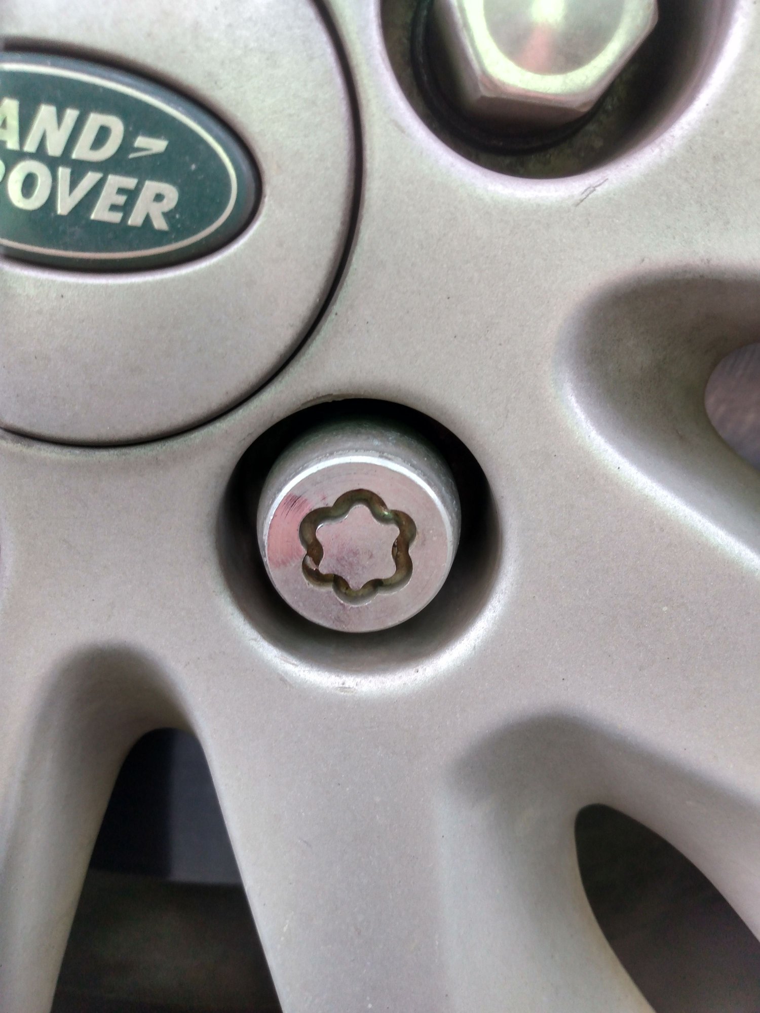

I need help identifying this locking lug nut on a 2014 LR2! Any information greatly appreciated!

The dealer should be able to provide a new key based on VIN, and I'm sure they're proud of them.
Alternatively, youtube will show you how to remove those yourself, or you can buy a special tool for $20.
Then just buy four regular nuts. All the crooks have access to youtube, including teenage punks, so locknuts don't really help these days.

The dealers do not record the lug nut key codes. They only record the ignition key and radio code. I called Land Rover Customer Care Center at the NJ USA HQ. I also called both my local dealership and the original dealership that sold the vehicle from new. But thank you for your suggestions.

Well... you just justified one of the reasons I always remove them. Anyhow, you (or a shop ) will be able to remove it, but it will be destroyed.
