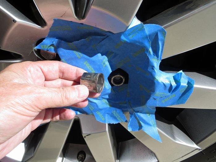

I thought it would be a struggle to pull the cap off, especially after watching a Youtube video where they had to punch a hole in the center and peel it off. So I taped around the lug to avoid scratching the wheel during the anticipated combat. I got some pliers on it. After a little wiggling and cursing, it came right off. Much easier than I expected!
The head size of the wheel nut (with cap) is 21mm. The naked nut under the cap will come off with either a 21mm or 20mm socket.
I replaced the nut with a new one and torqued to 98 ft-lbs. For good measure, I torqued all the nuts on all the wheels to ensure none of them also had a loose cap. All good.
I hope the next repair is so simple and easy.
