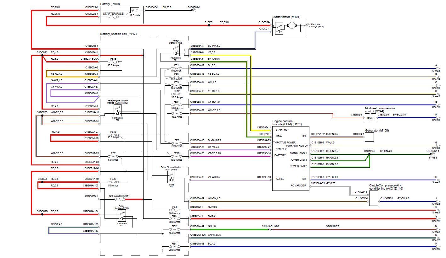

This is the starter circuit diagram. From the ECM there is a single wire to the starter relay in the battery junction box, which when energized lets power flow directly from the battery to the starter through the solenoid and to the motor.
Old Oct 8, 2021 | 11:31 PM
  #26
UP49802's Avatar
Joined: Nov 2020
Posts: 68
Likes: 13
Yep thats what I am looking at. I think my troubles are upstream. I still have that relay "talking" from 2 locations right after inserting the key. It first clicks someplace around the column/driverside and then theres 2 clicks from the passenger side by the glovebox. It does that 3 times back and fourth. I dont remember that before. Also I was wondering why the steering wheel isnt locking when the fob is removed? I will verify that tomorrow as well.
