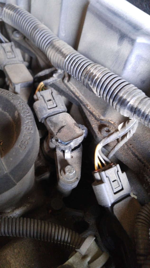

So my wife's LR2 has been having some issues lately, in addition to a few other things I've got it not wanting to start right now. I suspected the ignition coils so I pulled off the cover and took a look at them. One of them seems to have shorted and has the top melted (pic below). I bought a spark tester and tested all the coils/spark plugs and got no sign of spark from any of them. I either used the tool wrong lol or all 6 coils suddenly went bad all at once? I'm wondering if there is a distributor on these cars?

Check Fuse 12, should be a blue 20A fuse. Its likely when the coil failed, it shorted and blew the fuse.

That's exactly what it was brother. Found the blown fuse and replaced it, now we're getting spark. I still need to replace the one coil that shorted, I will probably replace all 6 coils + plugs anyway. Now I can move on to the other lingering issues this car has.
