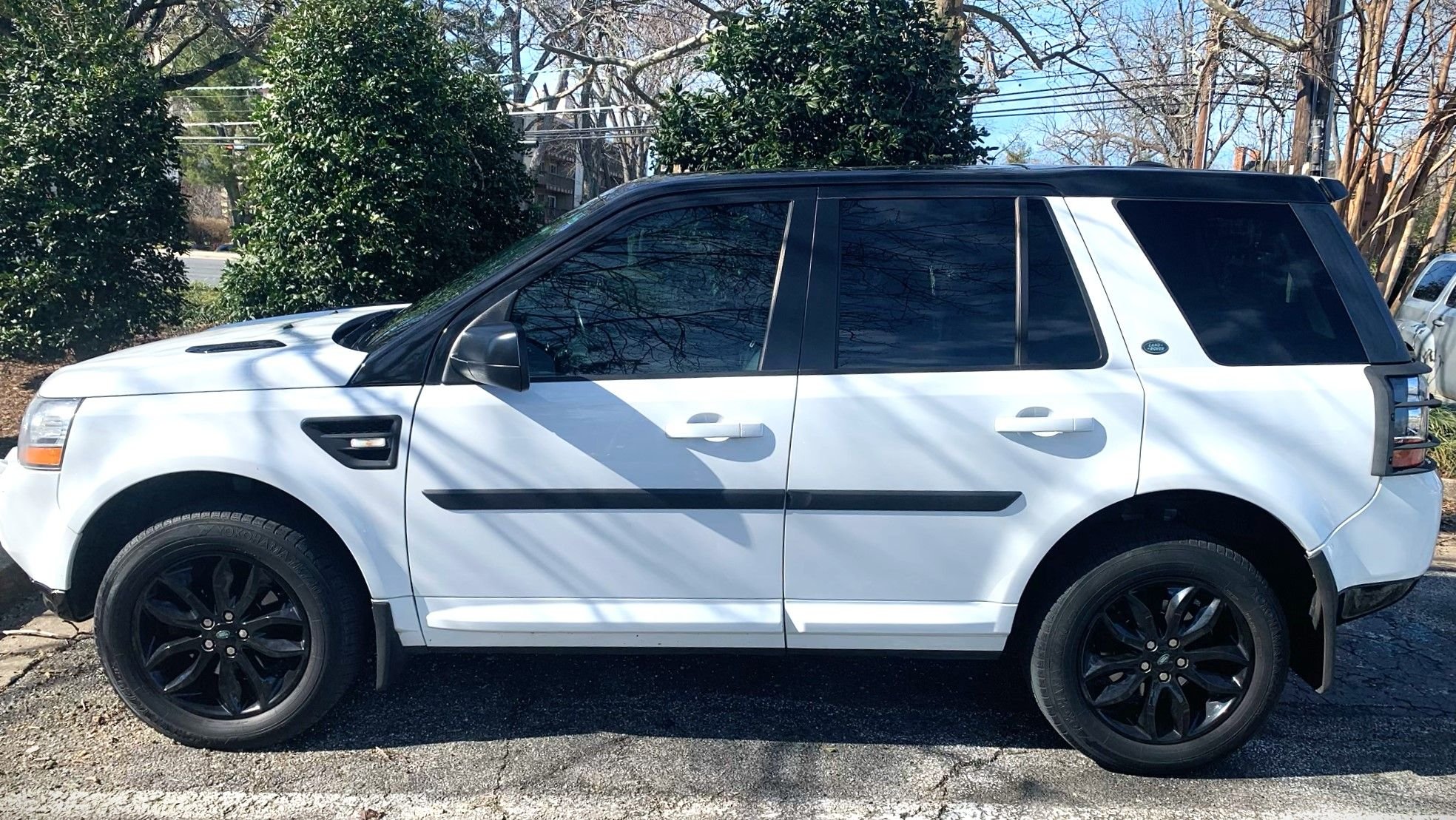

New to LR2s but I'm an old hat to the marque. I currently own an 04 Discovery SE7 (owned for 17yrs), had a few LR3s and a Series II years ago. I just purchased a 2013 LR2 for my daughter in college. Its a 2013, turbo-4, 109k miles, in overall great condition. Turbo has been replaced, diffs replaced, fresh belts and hoses, timing belt, plugs/wires, brake flush, and came with good maintenance records. Its a 2-owner vehicle and seems like it has been well maintained. So, what snakes are hiding? What can go wrong at this mileage? What can I prevent before my daughter drives off in the sunset (she's also a LR fan and insisted on a LR over the lesser imports).
