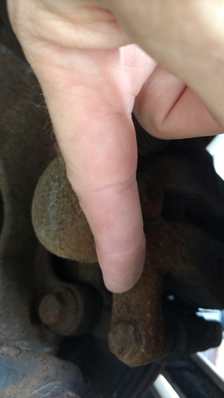

Hope the pictures come thru. So I finally got under it yesterday. All looked good on the exhaust system. I did notice on the right rear wheel that this part of the brake has just a slight bit of play in it. The left brake is rock solid. If I grab the part like I have it in the picture with my hand I can move it just a bit. It seems to be moving at the bolt I am pointing at.
Is this something I should tighten up? If so is there a certain torque to tighten to?

Just an update to this. Took it to a mechanic and he said brakes were seizing up. He did a full rear brake job with calipers, rotors, pads, brake lines front and rear and flushed the brake fluid. No more noise and it is running great again.
