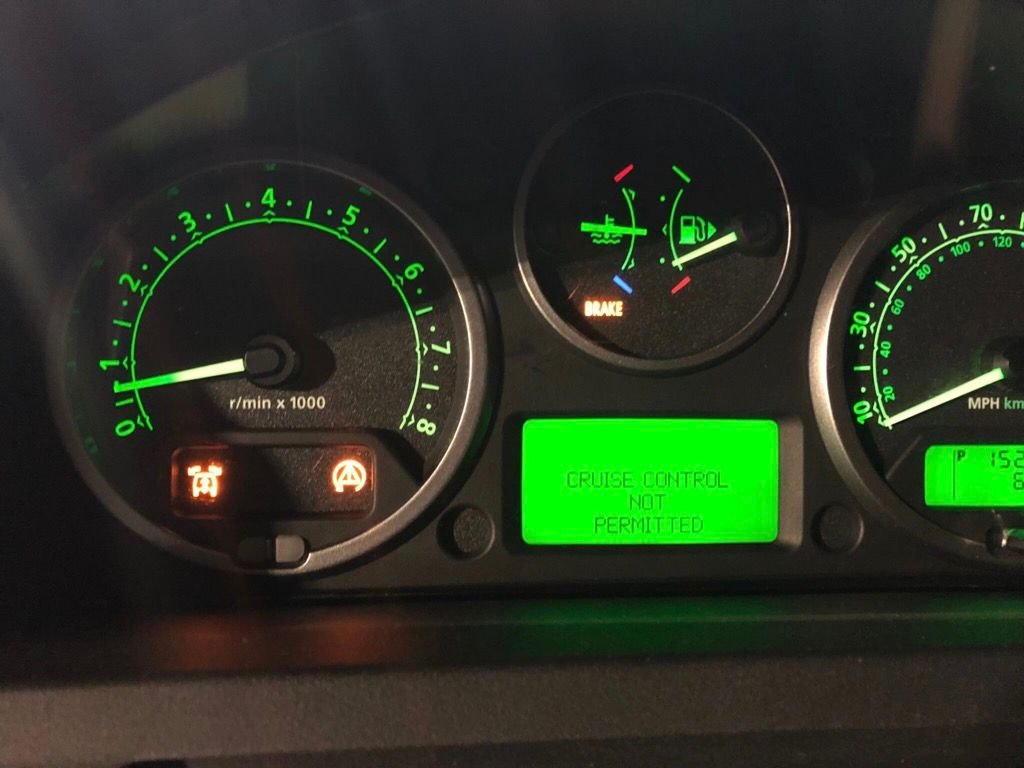

3. The OFT-MENTIONED "Christmas Tree Freak-Out Multi-Error Spitting Heart Attack"
For at least 2 years we've been dealing with the same thing so many have mentioned on so many forums about the LR3. I've gone and done most of the recommended self-service suggestions:
- New Battery
- [Nightly Trickle Charge For 1 Week]
- Hard Reset
- New Brake Light Switch
I'm going to replace the tail light bulbs with OEM ones this week ASAP because I HAVE determined that the issue does in fact only occur WHEN OUR LIGHTS ARE TURNED ON!

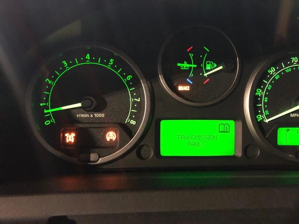

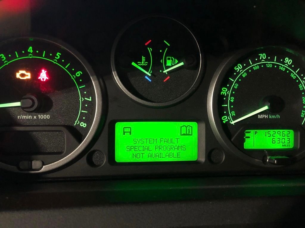

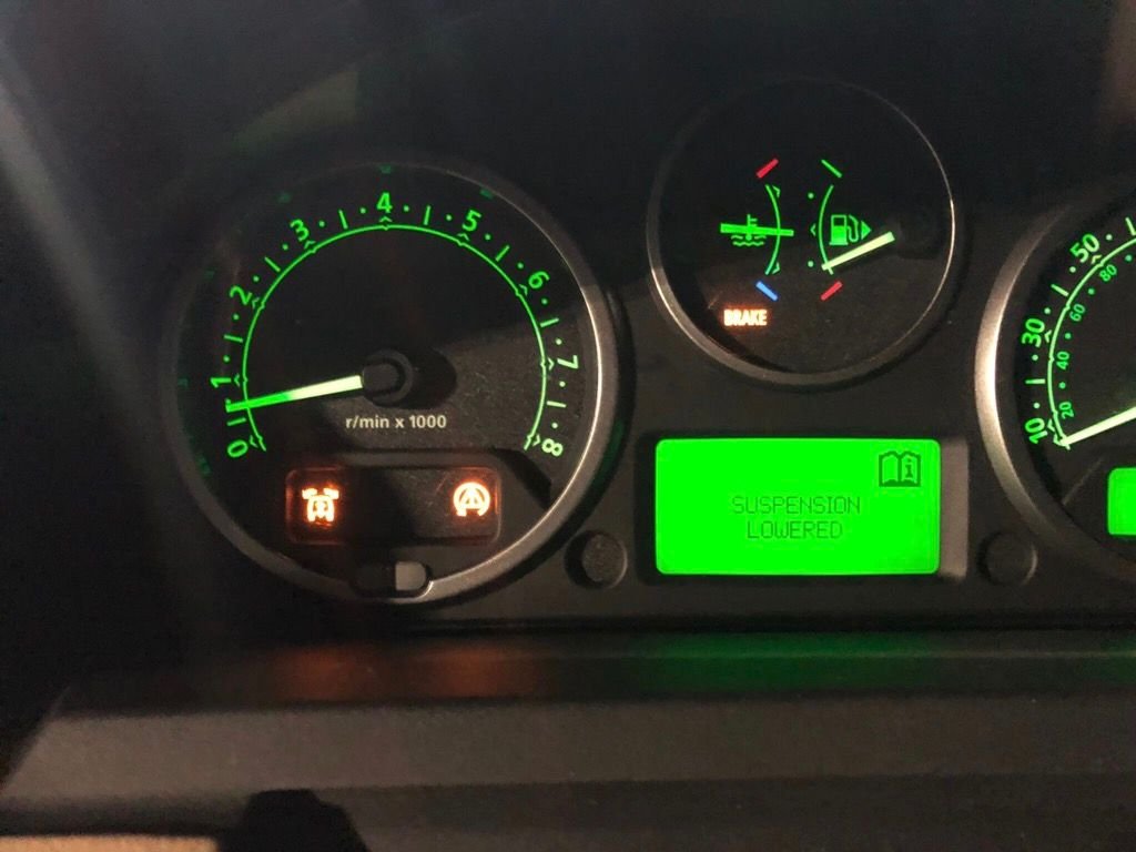

I can drive the truck all day and it shifts fine, runs fine, gives me no problems at all. But upon turning on the lights, it's not too long before my truck has it's stroke! It's generally one of 2 or 3 different combinations of errors (see below) and they all fire one right after the other. It's not always necessarily ALL of the exact same errors, but it's some fun combination of them.
The NET result of the Stroke is that my transmission doesn't function properly. Either it doesn't shift automatically any longer, or if it includes the "limited gears available" error that time, it'll only give me one gear.
I CAN drive the car at night however if I make sure to switch the transmission over to manual tiptronic before the Stroke happens. Then it can throw whatever errors it wants, take away my PRND23 options on my display but it will still shift just fine. I just have to manually shift it through the gears to drive it. [My wife won't drive it at night because this drives her crazy]
Also if I happen to not get it into Manual Mode before it has it's Stroke, I can simply pull over, turn the car off, turn the lights off, then turn the car right back on and everything goes away, allowing me to place it in Manual Mode before I turn the lights on and yet another Stroke ensues!
I'm almost to the point of listing the car for sale and just telling potential buyers exactly what the issue is in detail, thinking possibly a Land Rover loving nutjob like myself will see it and have no issues at all picking it up and solving the puzzle themselves. I just don't necessarily want to lose $500-$1000 or more of what I could possibly get for it if it's an easy enough thing to fix with your kind help!
Anywho - that's my freaking drama and I'm hoping that you'll take pity on my poor soul and impart the appropriate wisdom to fix this red-headed step child of a vehicle once and for all!
Brake, Tilt, Tire Pressure
Suspension Lowered
Transmission Fault
HDC Fault System Not Available
Cruise Control Not Permitted
Park Brake & Hazards
Transmission Fault Limited Gears Available
System Fault Special Programs Not Available
Special Programs Off

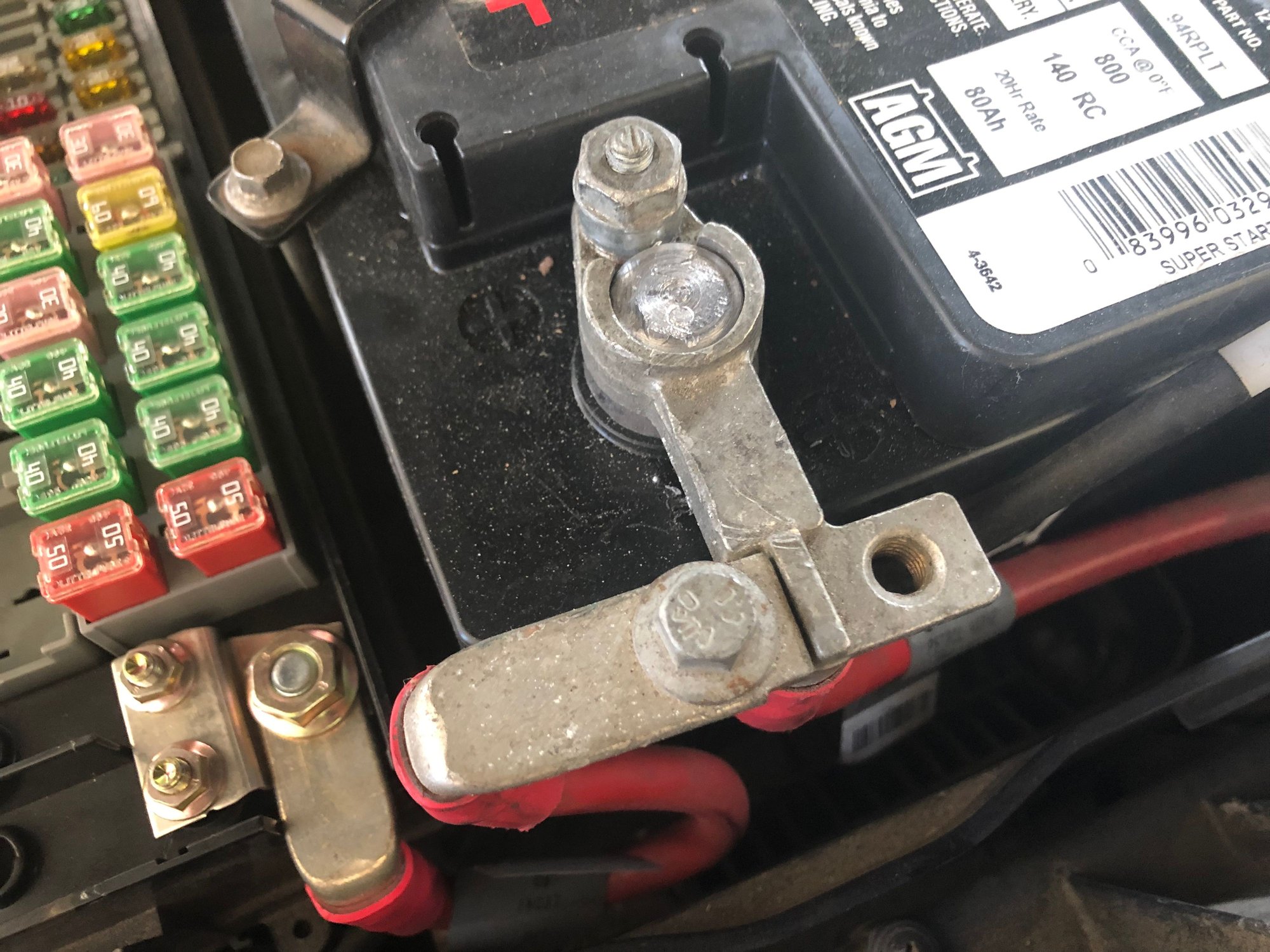

I agree it, seems like a power issue. Most likely items would be alternator, battery, or battery cables.
If it occurs when you run the lights, seems the alternator may not be supplying enough power, or it is not getting the power to the battery. Check the voltage of the battery before you start it, and then when it is running and see what the difference is.
Also check the battery ground cable at the back of the battery. It usually corrodes and prevent battery charging. Check the positive cable at the front of the battery and be sure to look at the main fuse in the positive cable coming from the alternator.

Alternator
check the ground wire off the battery, common point for corrosion

So the battery is brand new - 12.9v cold and 13.6v when car was running.
All the cables and connectors look perfect - no corrosion anywhere.
Not sure if there's a way of testing the alternator while still in the vehicle, but that's the one thing I haven't done.
