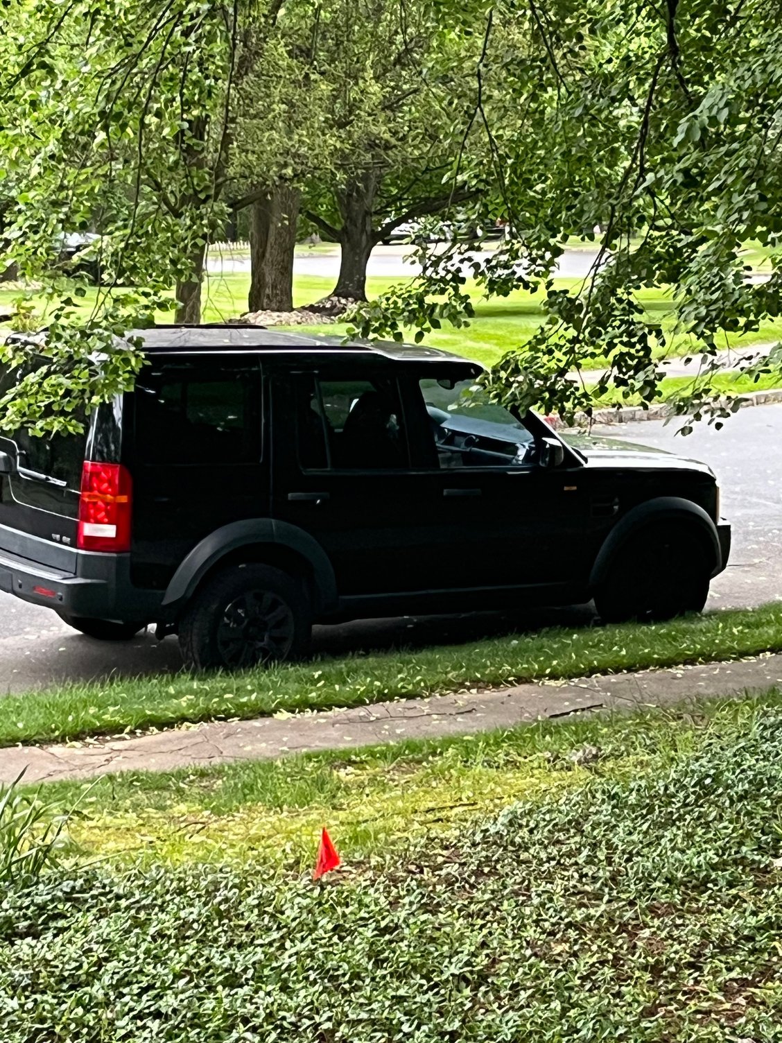

Okay, so some progress was made today! I will enclose a pic of what I ended up with, but I think you might be correct about the re-calibration. In fact, I may have inadvertently messed up the sensors by trying to do this too soon. So I did try this with the gap tool and the front end almost raises to normal ride height but the problem may be that the rear is not set properly. The rear is always too high and will raise while I am trying to do just front corners. So this is what I have now. And sorry, not a great pic but it started raining again, but maybe you can see rear is in extended mode and front is just a little low. The code I now get is it is in extended mode. So I think I need to just reset everything to factory level and start from there
