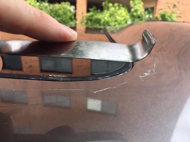

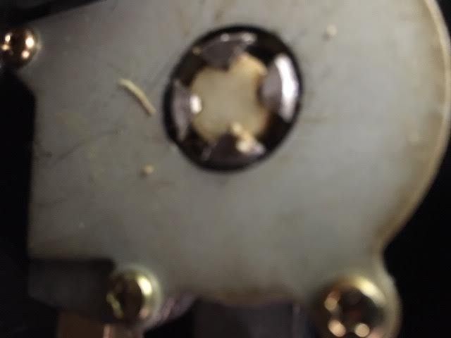

The fix is very simple and I had to do this as all other things I tried failed, from fuses to 12V so, you can easily pull down a edge of the interior roof from the back seats, it just unclips if you give it a tug downwards. Now, I made a tool to do the job, I bent the tip of an old dinner knife, about an inch, so that the knife kind of looked like an angles screw driver. When you look beneath the roof and the panel you've taken down, you will see a white plastic cross/screw fixture right next to the sunroof motor. Use the 'Tool' to turn that white plastic cross fit anti-clockwise, and as if by magic, the roof will start to close. Repeat until sunroof is totally shut lol then NEVER open it again lolol well until it's fixed that is Here's a pic of the screwdriver part I made to
do the job, and what you're looking for between the interior roof and the roof Good luck!
