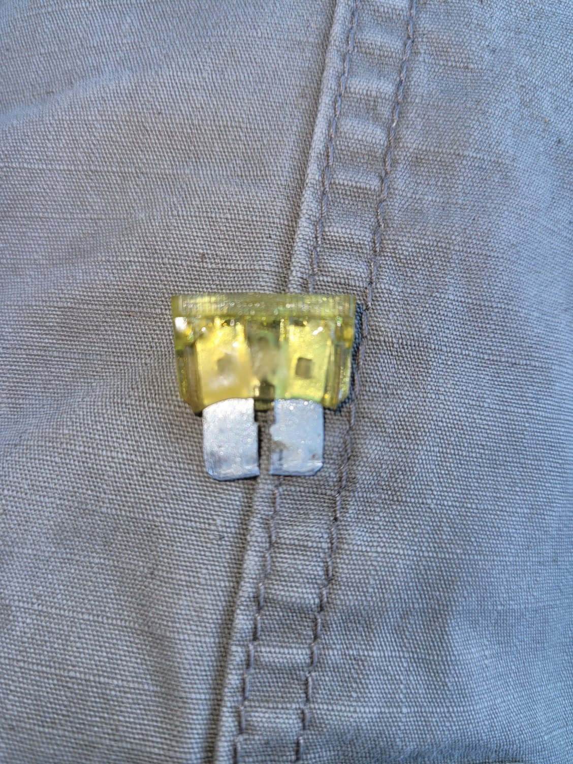

Default Update
Checked the underhood ⛽️ fuse and it looks super heated. Partially melted. There was a 20 Amp fuse in there when it calls for 25 Amp.
