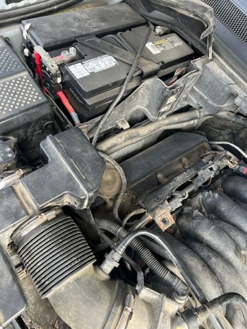

I had this issue on my 2006 LR3, where it would all of a sudden it not start after driving fine. I couldn't jump start it or anything. One time I had it towed, then at the repair shop it started fine. The shop found nothing wrong.
I found the issue to be a bad ground connection. I didn't see any corroded ground connections, so I bought an extra grounding cable and connected battery ground to a bolt on the engine. See pic below. This worked and the problem never return. I did this fix about 5 years ago.
