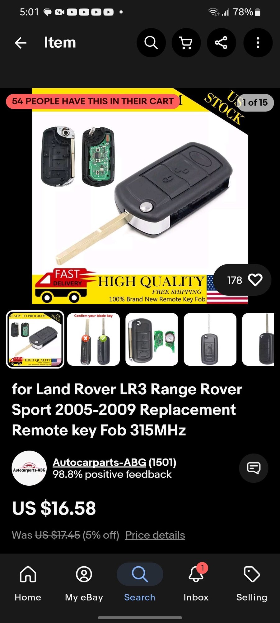

I bought one of these on eBay and soldered in a battery that I bought one Amazon. Still working 18 months later. The one I got with mu GAP from Lucky8 was fake. Couldn't program it and when I compared the two circuit boards it was obviously missing half the components. The vendor I bought from is still on eBay.
